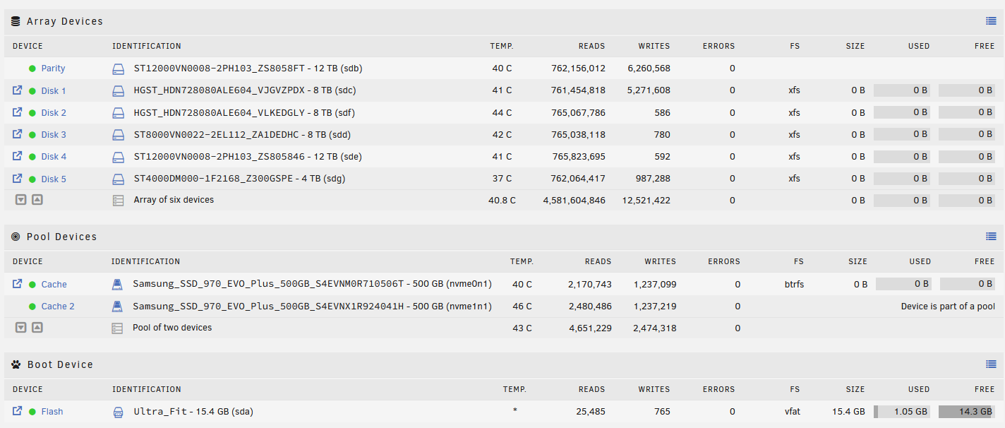

  13. Hi, Fix common problems is telling me I have an out of memory error, and to post here asking for help. This only started yesterday. I haven't noticed any disruption...yet. Any advice would be appreciated. Diagnostics attached. Thanks in advance. tower-diagnostics-20250601-2248.zip
  14. Oh my goodness. It's all there. Such a relief! Thank you so much! I guess the mount configs must be saved on the flash drive or something and restarting just resets them to that config? Now I think I will just recreate the docker image and stop trying to balance it to solve that problem.
  15. Oh, that sounds hopeful! I was scared to reboot in case it made things worse. And yes I think I'll take the simple option of rebooting if it will work just as well. Here goes...
