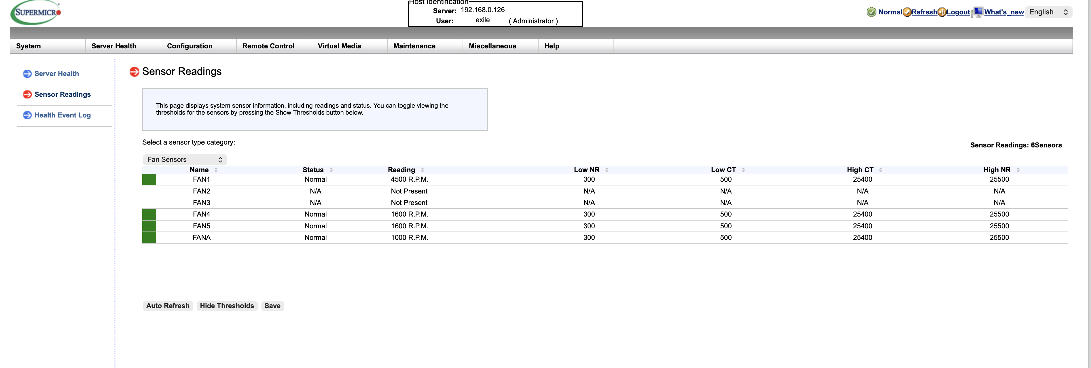

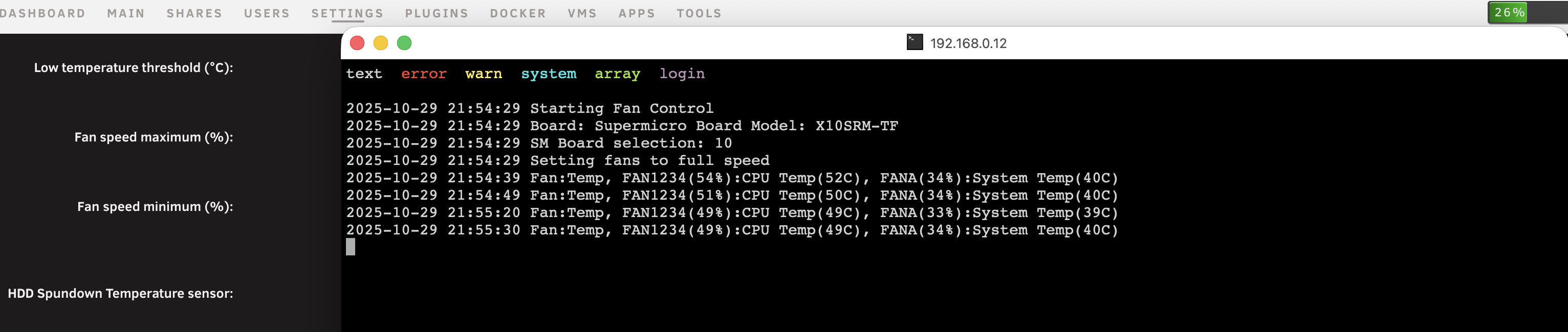

  6. Yes Jorge I do. So it looks like I have to play with the thresholds in the IPMI plugging fan settings as I think they're to aggressive.

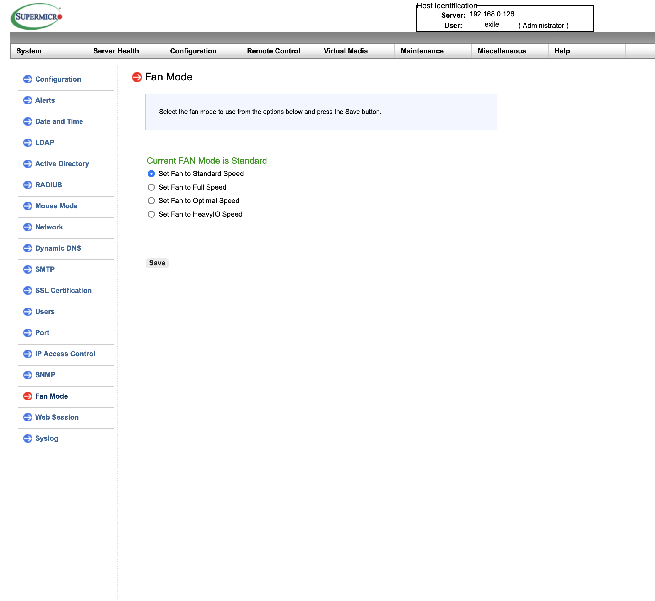

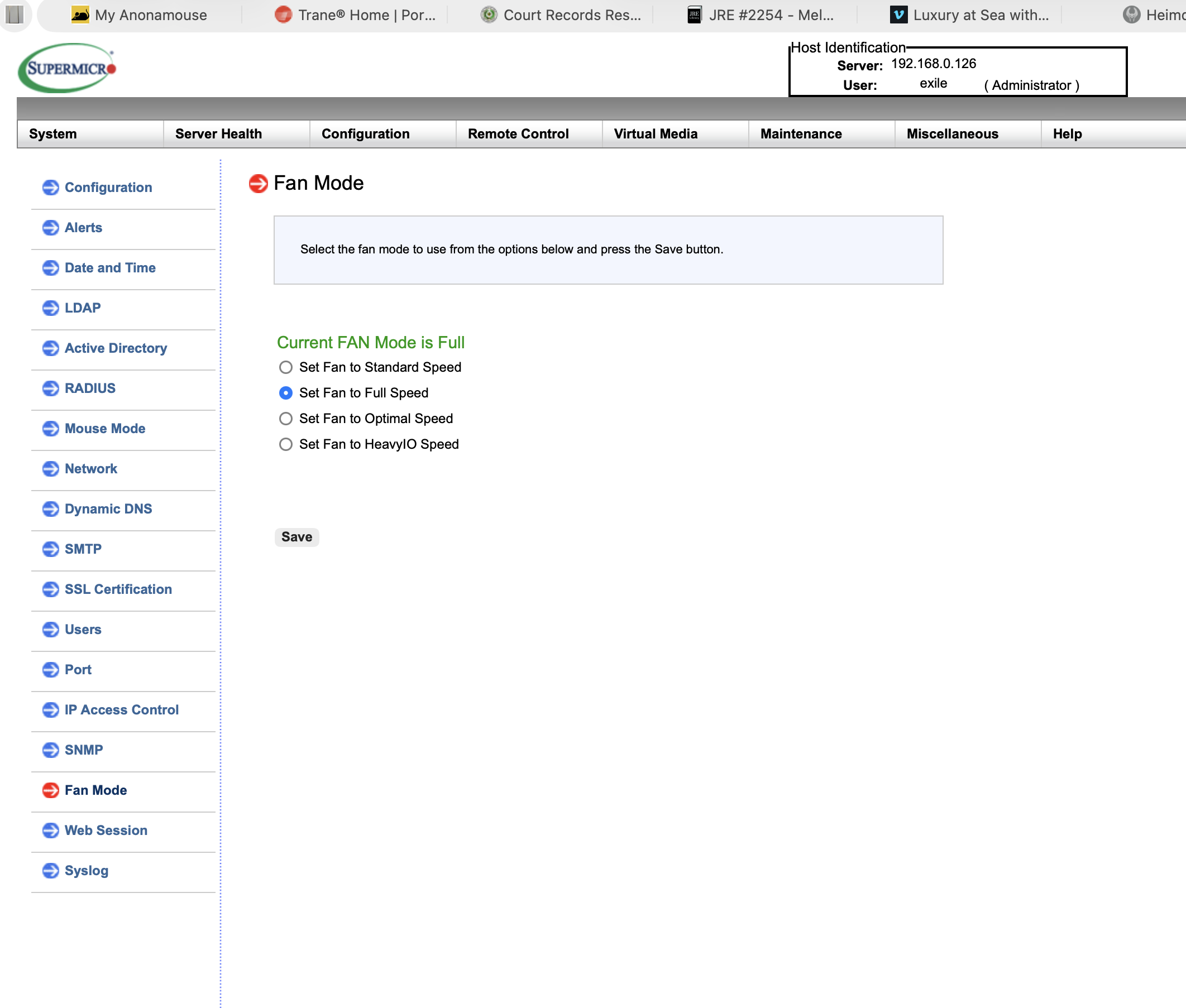

  7. IPMI plugin forcing my Supermicro FAN Mode to Full Speed What am I doing wrong here? In my Supermicro BMC settings I have my FAN Mode setup at "Standard Speed" and as soon as the Unraid boots I think the IPMI setting overwrites the fan mode settings from standard to "Full Speed" which will crank up the fans at max speed. I see no settings in the IPMI plugin for the Fan Mode. I really need to stay at Standard Speed. Any ideas?
  8. What am I doing wrong here? In my Supermicro BMC settings I have my FAN Mode setup at "Standard Speed" and as soon as the Unraid boots I think the IPMI setting overwrites the fan mode settings from standard to "Full Speed" which will crank up the fans at max speed. I see no settings in the IPMI plugin for the Fan Mode. I really need to stay at Standard Speed. Any ideas?
