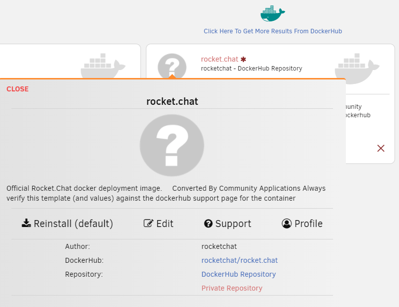

need some help applying updates/hotfixes;
  • Security Alert Important Cross-Site-Scripting (XSS) security fix. Please upgrade as soon as possible. 3.9.3 / 3.8.4 / 3.7.4 / 2.4.14 / 1.3.5
  • Security Alert Critical security hotfix for Live Chat available in our latest releases 3.10.5, 3.9.7, 3.8.8. Please upgrade as soon as possible.
how do i go about applying these updates/fixes, currently unraid shows up-to-date
Is this still being updated and supported? I am also wondering how to upgrade. The dockerhub link is dead. If it is no longer supported is there a safe way to migrate to the official docker or do we need to rebuild from scratch?
  • 2 months later...
https://hub.docker.com/_/rocket-chat is the correct dockerhub link now
