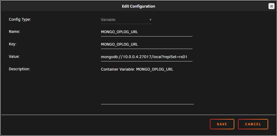

  5. Install rocket.chat from communityapp
    1. Set Mono DB to your mongoDB, in my case it is "mongodb://10.0.0.4:27017/rocketchat"
    2. Set RocketChat URL to yor ip, in my case: "http://10.0.0.4:3000"
    3. Add another variable (plus icon)
  6. Start RocketChat watch the log and after a few minutes it should start up and you can connect.

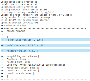

When u see something like this, the rocketchat instance should be reachable.
[32m➔[39m [32mSystem ➔ startup[39m
[32m➔[39m [32m+---------------------------------------------+[39m
[32m➔[39m [32m| SERVER RUNNING |[39m
[32m➔[39m [32m| |[39m
[32m➔[39m [32m| Rocket.Chat Version: 1.2.1 |[39m
[32m➔[39m [32m| NodeJS Version: 8.11.4 - x64 |[39m
[32m➔[39m [32m| MongoDB Version: 4.0.10 |[39m
[32m➔[39m [32m| MongoDB Engine: wiredTiger |[39m
[32m➔[39m [32m| Platform: linux |[39m
[32m➔[39m [32m| Process Port: 3000 |[39m
[32m➔[39m [32m| Site URL: http://10.0.0.4:3000 |[39m
[32m➔[39m [32m| ReplicaSet OpLog: Enabled |[39m
[32m➔[39m [32m| Commit Hash: 7475d7628a |[39m
[32m➔[39m [32m| Commit Branch: HEAD |[39m

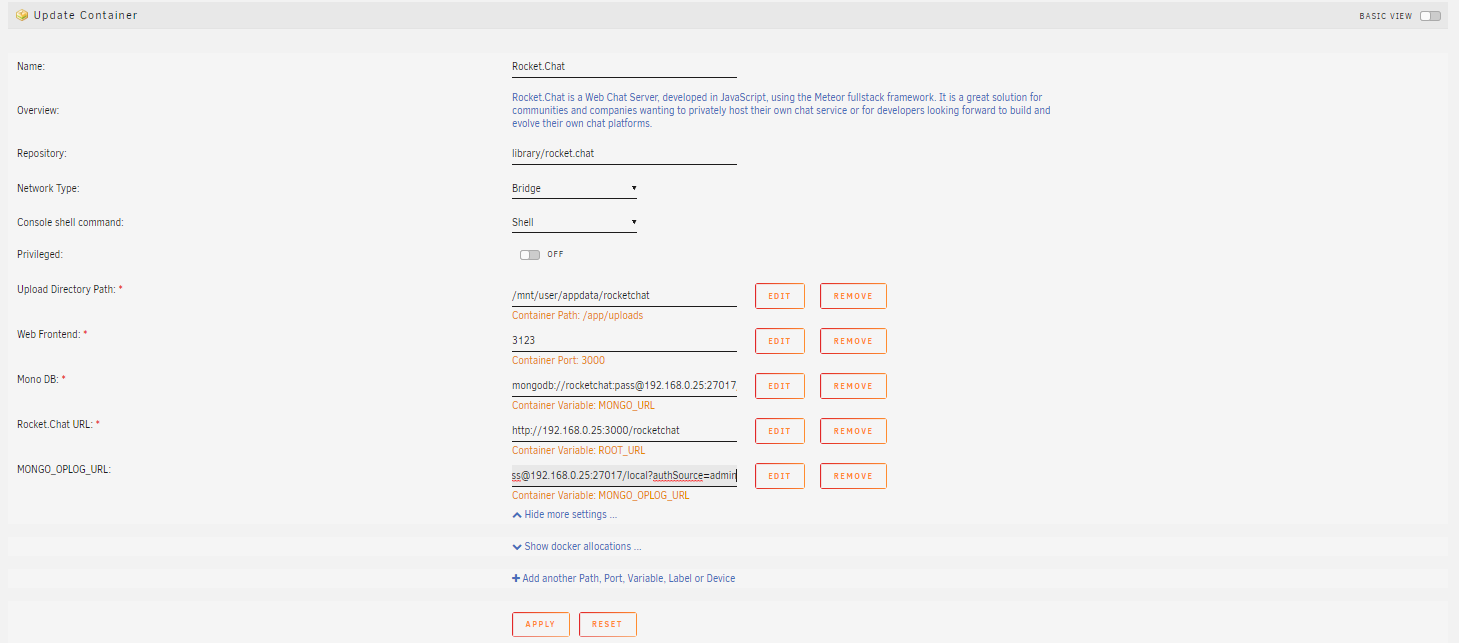

Finally we need to modify the connection strings in the RocketChat Docker
// MONGO_URL:
// this is the rocketchat user we created in the rocketchat database
mongodb://rocketchat:[email protected]:27017/rocketchat?replicaSet=rs01
// MONGO_OPLOG_URL
// this is the rocketchat user we created in the admin database
mongodb://rocketchat:[email protected]:27017/local?authSource=admin&replicaSet=rs01
Fire up your RocketChat instance and hope for the best.  If it works send a middle finger emoji to a random user and go relax.  If not sorry I couldn't help out.

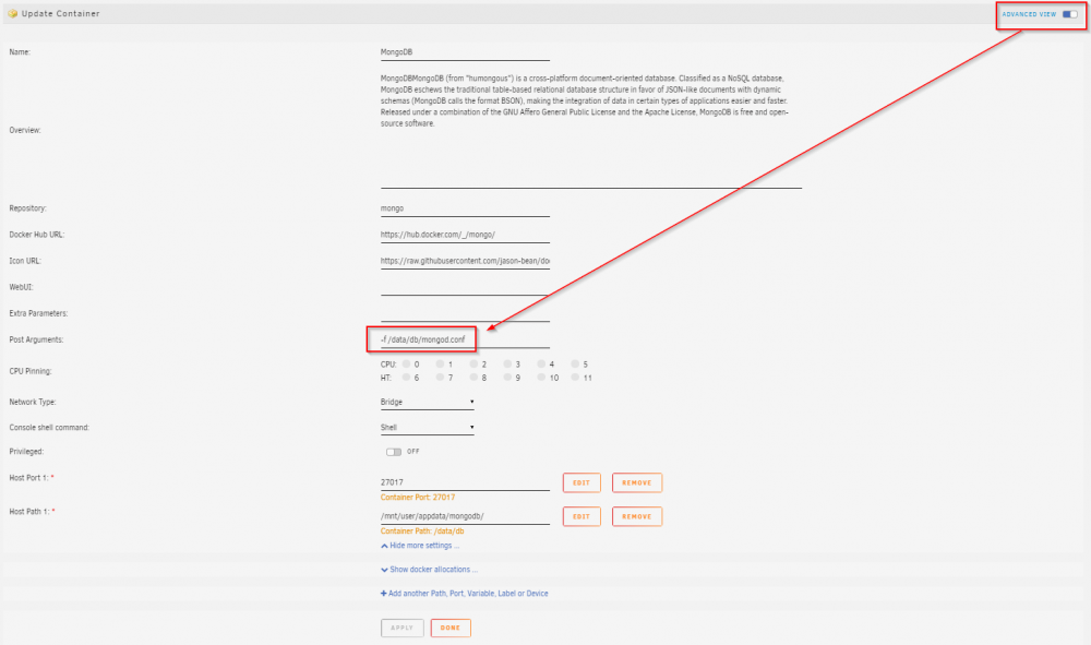

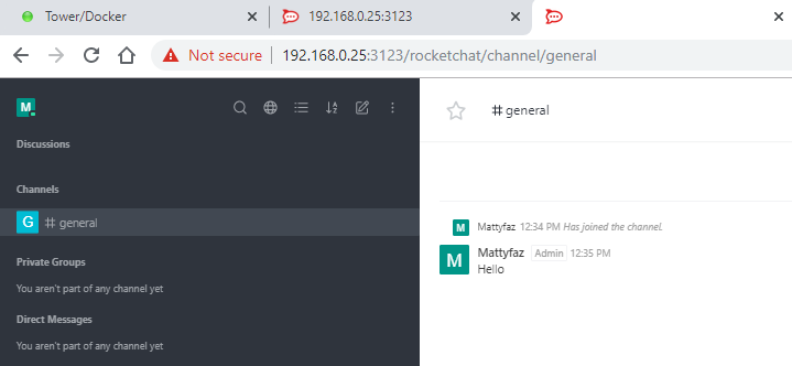

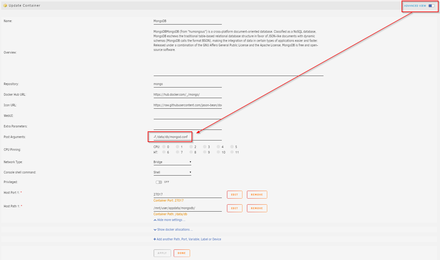

Just managed to get this working using a combination of the suggestions here.
1) Create /appdata/mongodb/mongod.conf file and add the following:
storage:
   dbPath: /data/db
   journal:
      enabled: true
systemLog:
   destination: file
   logAppend: true
   path: /var/log/mongodb/mongod.log
net:
   port: 27017
   bindIp: 127.0.0.1
processManagement:
   timeZoneInfo: /usr/share/zoneinfo
replication:
   replSetName: rs01
security:
   authorization: "enabled"
2) Add MongoDB from Apps, and add "-f /data/db/mongod.conf" to the Post Arguments field (rest is default):
storage:
   dbPath: /data/db
   journal:
      enabled: true
systemLog:
   destination: file
   logAppend: true
net:
   port: 27017
   bindIp: 127.0.0.1
processManagement:
replication:
   replSetName: rs01
security:
3) Start MongoDB and go into the terminal, then type the following commands:
  • mongo
  • rs.initiate()
  • <<press enter>> - it should now say PRIMARY
  • use admin
  • db.createUser({user: "root",pwd: "passwordHere",roles: [{ role: "root", db: "admin"}]})
  • db.createUser({user: "rocketchat",pwd: "passwordHere",roles: [{role: "readWrite", db: "local" }]})
  • use rocketchat
  • db.createUser({user: "rocketchat",pwd: "passwordHere",roles: [{ role: "dbOwner",db: "rocketchat" }]})
4) Download Rocket.Chat from Apps and update the following values (note: Update with your own IP/Port):
  • MONGO_URL = mongodb://rocketchat:passwordHere@192.168.0.25:27017/rocketchat
  • ROOT_URL = http://192.168.0.25:3000/rocketchat
  • MONGO_OPLOG_URL = mongodb://rocketchat:passwordHere@192.168.0.25:27017/local?authSource=admin
Done! All works for me now at: http://192.168.0.25:3123/rocketchat/
Hi,Mattyfaz
Thank you very much for your tutorial i get it to work perfect for the moment we will see in the future if will brake.
I disable the updates of Mongo and Rocket dockers.
Id like to ask you if you find out how to access it from WAN  with Letsencrypt or something.
Thank you :)
Just i edit also:
i remove /rocketchat at the end and the port is :3000 not 3123 and now just click on the rocketchat docket and the Web Ui is open.
More easy to access.
Edited by Vesko

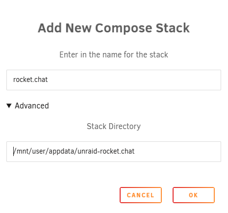

Here is a guide showing how to setup Rocket chat running through a reverse proxy.
Also you can update the container but when you setup the mongoDB you must specify the hostname in the container when you create it.
That way when the container is ever recreated it keeps the same name and so doesnt cause the database to break.
If you already have rocket chat installed and  have disabled updates then see a fix that will allow you to update  as normal at the end of my video.
