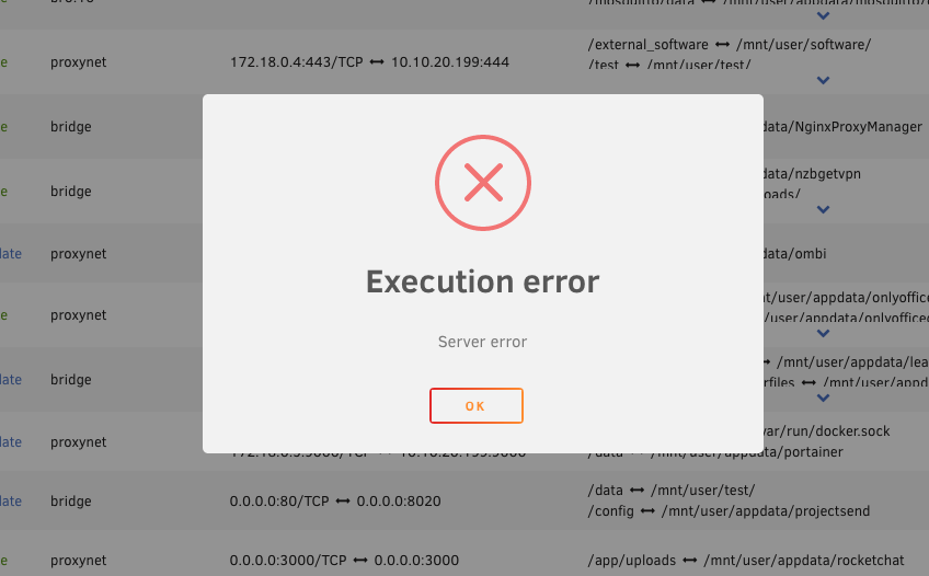

6 minutes ago, Iceman1199 said:
Thanks SpaceInvader One.  I'm following your guide, but when I try to start up RocketChat docker I get a "Execution Error:Server Error".  Any ideas on what might be causing this?
So you get an error like this when you click on start for the container?
Most likely you have another container running with the same port in use. Is anything else using port 3000?
Grafana also uses port 3000 by default.
Wow!!! I feel like an idiot.  That is exactly the reason why.  Any thoughts on how to get around that?  Grafana is using port 3000.  I worry just changing the port on the Rocketchat docker won't work.
Edited by Iceman1199
Scratch that last thought.  I just changed the port on Grafana instead and I got RocketChat up.  Thanks for the fix bro!!!!
1 minute ago, Iceman1199 said:
Wow!!! I feel ike an idiot.  That is exactly the reason why.  Any thoughts on how to get around that?  Grafana is using port 3000.  I worry just changing the port on the Rocketchat docker won't work.
Ah its an easy mistake to make , I have done the same before myself many times before :)
You can change the grafana port or the rocket chat port.
If you change the rocket chat port you will have to make a change in reverse proxy config file too as the confile file expects the port that Rocket chat is using
to be 3000.
Ah i was writing the reply when you posted this. Glad its working for you :)

Hello unRAID people.
I've got the docker installed, tested it works like a charm.
But I'm having an issue I can't figure out how to solve.
I've installed the Rocket Chat app on my Android phone, but I can't connect to the workspace for it before I've enabled the Websocket.
I'm not quite sure what it is, I've read about it needs NGINX, I have the NGINX Proxy Manager, but I can't seem to find what I need.
Can anyone help?
@D'n'S137

Sorry for the late answer you can check your log just after starting the docker from the Unraid Docker Tab at the right by pressing the symbol that looks like a written pice of paper these logs are live when your docker is running.
By looking into the logs it seems like RocketChat cannot find your mongoDB, you have to have a installed mongoDB docker/server running if you want to run a RocketChat docker/server, if you already have one installed check the Network connection both docker/servers have to be on the same Subnet.
Can anyone help?

I found a solution around the same time you wrote it.
I'm not using let's encrypt like he does. I'm using NGINX Proxy Manager which has let's encrypt built into it.
And while I was doing another thing, I noticed it had a text saying "enable websocket". And I just had to enable it right there.
Thank you anyway though :)

It's always a good step, to look into the logs most services know what they need [emoji16][emoji106]
7 minutes ago, D'n'S137 said:
Thank you for posting your answer. smile.png&key=d7bc0bbbfa2056a2a63af437c1f4a1188d2d7eb0deb5aa11e8f34aa88765e668
It's always a good step, to look into the logs most services know what they need emoji16.pngemoji106.png
I didn't look at the log. I just didn't know where it was.
