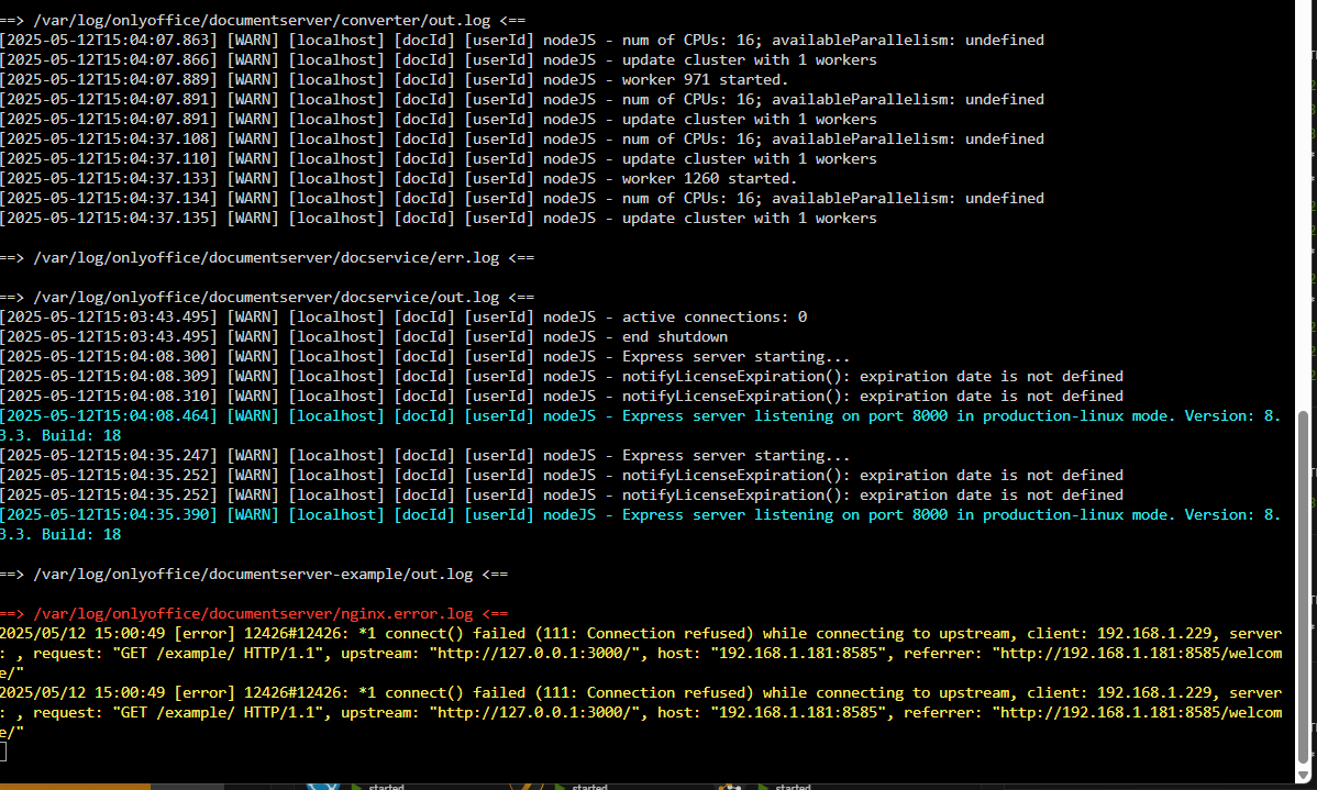

  1. I uninstalled the docker, removed the appdata folder. reinstalled documentserver, added the JWT that's in my seahub_settings.py. restarted Seafile and now I have OnlyOffice working. Thank you,
  2. Just adding.. I read about copying certs from my swag container and renaming them and putting them into the onlyoffice/data/certs folder.. started working in seafile. apparently I missed that step?

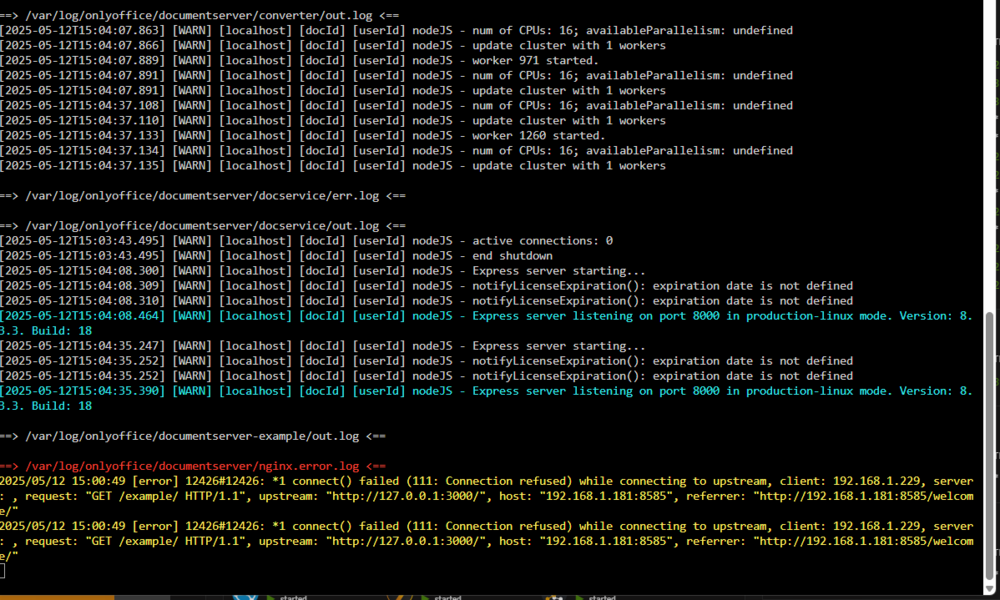

  3. 2025/05/12 21:17:55 [error] 12469#12469: *16 open() "/var/www/onlyoffice/documentserver/web-apps/apps/api/documents/api.js'" failed (2: No such file or directory), client: 172.19.0.1, server: , request: "GET /web-apps/apps/api/documents/api.js' HTTP/1.1", host
  4. OKay..corrected a few things in the Seahub settings file.. I now get "Connection refused" when trying to open a document.
  5. both containers are on my proxy-net network. I tried your swag config, same thing. It's like it wants to open but doesn't.
  6. I keep getting this when starting OnlyOffice, I can hit office.mydomain.com just fine and I get the "Server installed". when I try to open a document I just get a white screen, no errors in Seafile or OnlyOffice. Wondering if it's not my proxy config maybe? I am using Swag. server { listen 443 ssl; listen [::]:443 ssl; server_name office.*; include /config/nginx/ssl.conf; client_max_body_size 0; location / { include /config/nginx/proxy.conf; resolver 127.0.0.11 valid=30s; set $upstream_app OnlyOfficeDocumentServer; set $upstream_port 2443; set $upstream_proto https; proxy_pass $upstream_proto://$upstream_app:$upstream_port; proxy_max_temp_file_size 2048m; } } My proxy config, I've tried serverIP, docker name, port for HTTP 8585 and I've tried HTTPS port 2443. Same result.
  7. I am trying to set up OnlyOffice integration into Seafile. I can't hit office.mydomain.com just fine.. when I open a document I can't do anything, I just get a blank screen.
