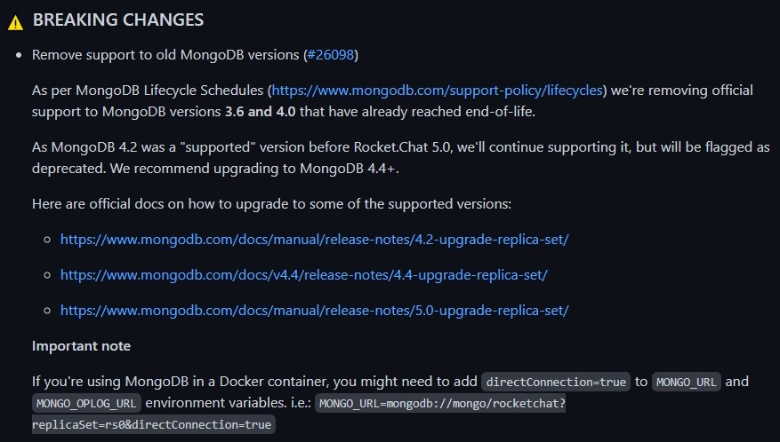

Adding the directConnection=true argument to both the MONGO_URL and MONGO_OPLOG_URL seems to have resolved the issue above.
MONGO_URL:
mongodb://rocketchat:<password>@<localhost>:27017/rocketchat?directConnection=true
MONGO_OPLOG_URL
mongodb://rocketchat:<password>@<localhost>:27017/local?authSource=admin&directConnection=true
Reference:
https://github.com/RocketChat/Rocket.Chat/releases

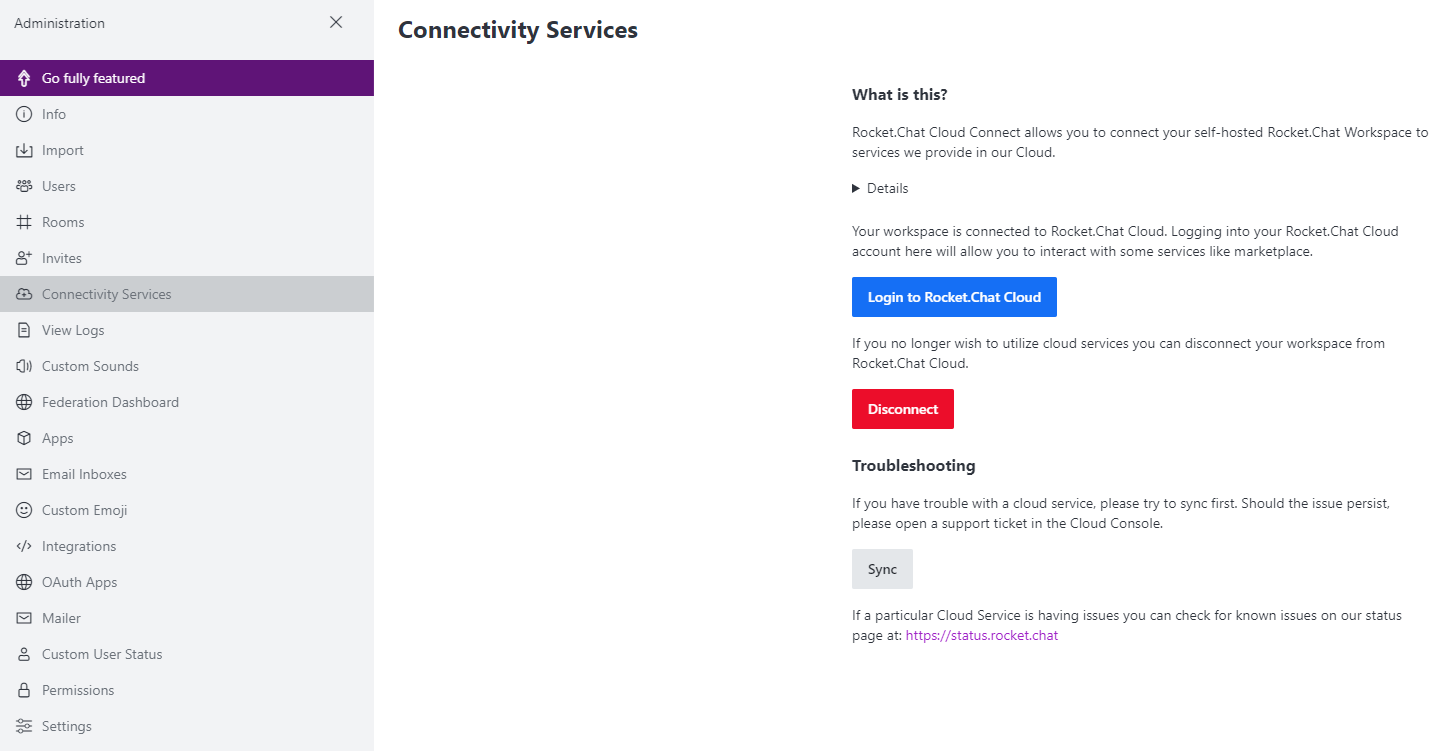

Hi!
After the last update for RC and MongoDB, I'm getting the following errors. RC is working, but notifications (both in the browser and app) just don't work anymore.
{"level":40,"time":"2022-09-15T11:54:21.307Z","pid":1,"hostname":"39f56867de46","name":"Push","msg":"Error sending push to gateway (not authorized) {\"statusCode\":401,\"content\":\"{\\\"code\\\":121,\\\"error\\\":\\\"rocket.chat cloud registration required\\\",\\\"requestId\\\":\\\"0bc27b0d-1e88-4859-b3a4-4a8d3eb88698\\\",\\\"status\\\":401}\",\"headers\":{\"access-control-allow-headers\":\"Content-Type, Authorization, Content-Length, X-Requested-With\",\"access-control-allow-methods\":\"GET, PUT, POST, DELETE, OPTIONS\",\"access-control-allow-origin\":\"*\",\"access-control-expose-headers\":\"Content-Type, Authorization, Cache-Control, Expires, Pragma, X-powered-by\",\"cache-control\":\"private, no-cache, no-store, must-revalidate\",\"connection\":\"close\",\"content-length\":\"126\",\"content-type\":\"application/json; charset=utf-8\",\"date\":\"Thu, 15 Sep 2022 11:54:21 GMT\",\"expires\":\"-1\",\"pragma\":\"no-cache\",\"vary\":\"Accept-Encoding\",\"x-powered-by\":\"Rocket Fuel and Rocketeers\"},\"ok\":false,\"data\":{\"code\":121,\"error\":\"rocket.chat cloud registration required\",\"requestId\":\"0bc27b0d-1e88-4859-b3a4-4a8d3eb88698\",\"status\":401}}"}
I've tried re-registering RC on the cloud and currently it shows the instance is connected. I'm also able to sync it, at least that's the notification that I get :).
but I cannot Login to Rocket.Chat Cloud when I click the Login to Rocket.Chat Cloud button. This is the error message that I get:
{"level":50,"time":"2022-09-15T12:01:09.946Z","pid":1,"hostname":"39f56867de46","name":"System","err":{"type":"Error","message":"failed [401]{\"status\":401}","stack":"Error: failed [401]{\"status\":401}\n    at makeErrorByStatus (server/lib/http/call.ts:59:9)\n    at server/lib/http/call.ts:168:19\n    at /app/bundle/programs/server/npm/node_modules/meteor/promise/node_modules/meteor-promise/fiber_pool.js:43:40","response":{"statusCode":401,"content":"{\"status\":401}","headers":{"access-control-allow-headers":"Content-Type, Authorization, Content-Length, Last-Event-ID, X-Requested-With","access-control-allow-methods":"GET, PUT, POST, DELETE, OPTIONS","access-control-allow-origin":"*","access-control-expose-headers":"Content-Type, Authorization, Cache-Control, Expires, Pragma, X-powered-by","cache-control":"private, no-cache, no-store, must-revalidate","connection":"close","content-length":"14","content-type":"application/json; charset=utf-8","date":"Thu, 15 Sep 2022 12:01:09 GMT","expires":"-1","pragma":"no-cache","vary":"Accept-Encoding","x-fleet-version":"-77b34ba","x-powered-by":"Rocket Fuel and Rocketeers"},"ok":false,"data":{"status":401}}},"msg":"failed [401]{\"status\":401}"}
{"level":50,"time":"2022-09-15T12:03:45.303Z","pid":1,"hostname":"39f56867de46","name":"System","msg":"Exception while invoking method cloud:finishOAuthAuthorization 'Invalid state provided [error-invalid-state]'"}
My RC docker log on start:
Would highly appreciate any insights/help to resolve this issue.

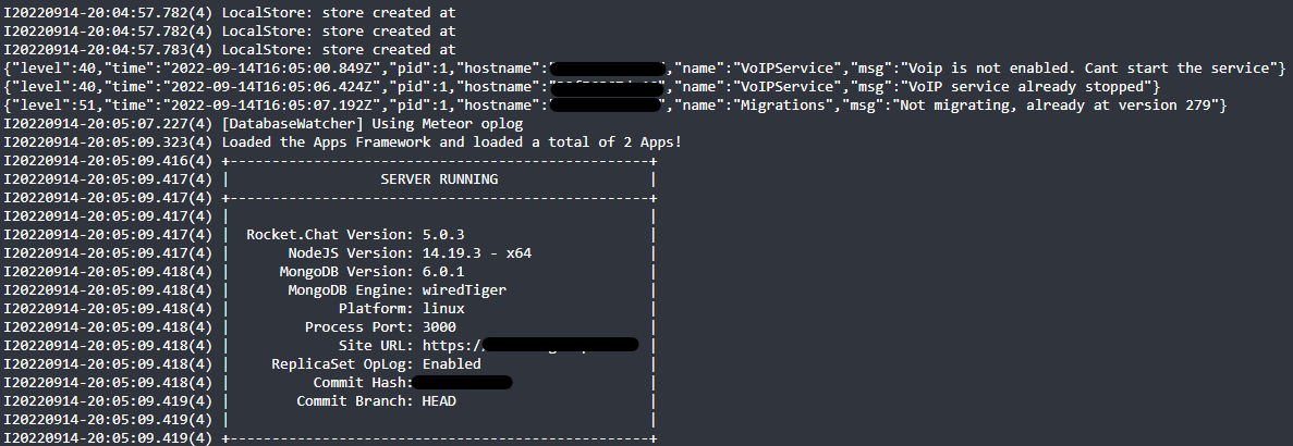

Hi All!
I've finally managed to get RC docker working on mongo:5 with all my previous data restored successfully :).
Notifications are working now and I can connect to the Rocket.Chat cloud.
|                  SERVER RUNNING                  |
|  Rocket.Chat Version: 5.2.0                      |
|       NodeJS Version: 14.19.3 - x64              |
|      MongoDB Version: 5.0.13                     |
|       MongoDB Engine: wiredTiger                 |
|             Platform: linux                      |
|         Process Port: 3000                       |
|             Site URL: https://my.domain.com      |
|     ReplicaSet OpLog: Enabled                    |
|          Commit Hash: 08f03cc9d8                 |
|        Commit Branch: HEAD                       |
Posting the steps I followed for anyone who might be facing a similar issue.

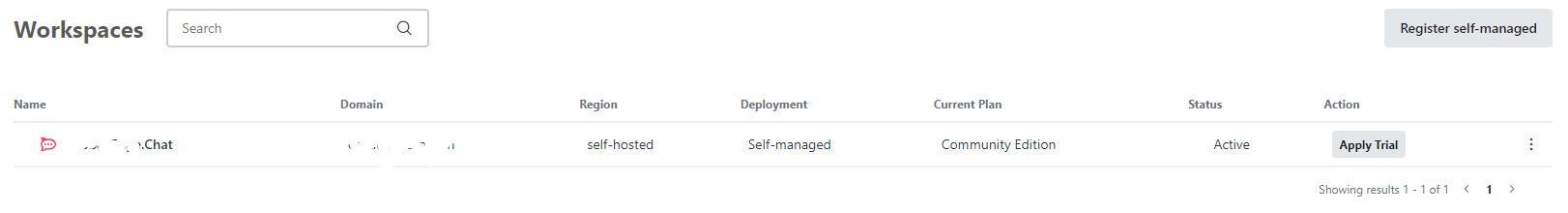

The solution was to use the docker compose stack that installs rocket.chat and mongodb together. If you're on unRAID like me, you'll need to look at getting Docker Compose enabled first, yes it's a thing and it works great.

This was one and done, all working. That easily! I was able to register the server and log in to Rocket.Chat cloud from the settings menu with everything working perfectly. Good luck!

|                   SERVER ERROR                   |
|  Rocket.Chat Version: 5.4.0                      |
|      MongoDB Version: 4.0.28                     |
|       MongoDB Engine: unknown                    |
|             Platform: linux                      |
|             Site URL: https://r.xxxx.us          |
|          Commit Hash: 51f456a544                 |
|  YOUR CURRENT MONGODB VERSION IS NOT SUPPORTED,  |
|  PLEASE UPGRADE TO VERSION 4.4 OR LATER          |
What am i doing wrong?
