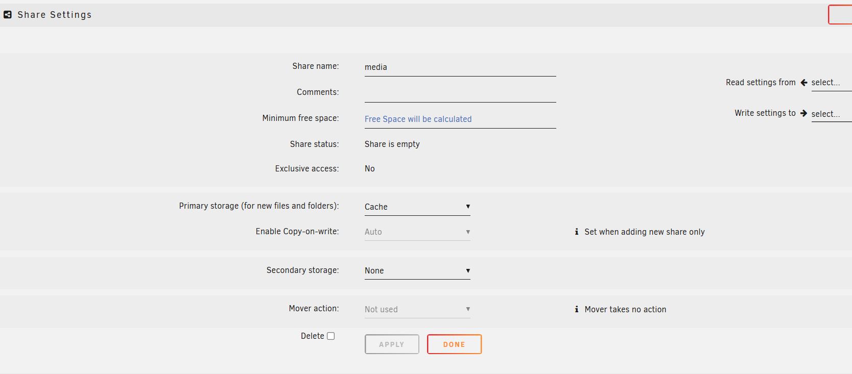

  10. The details say its empty, but if I check the box to delete - nothing happens.
