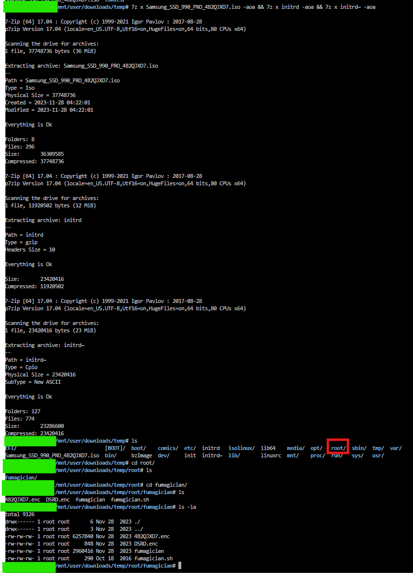

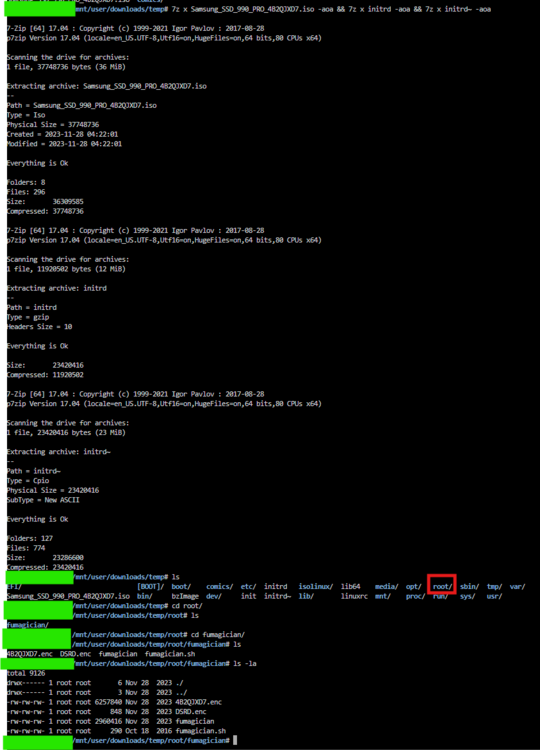

  7. did you use 7z to properly extract the files per the guide? i just did same version for you to test no issues. follow the guide to the the T should work.
