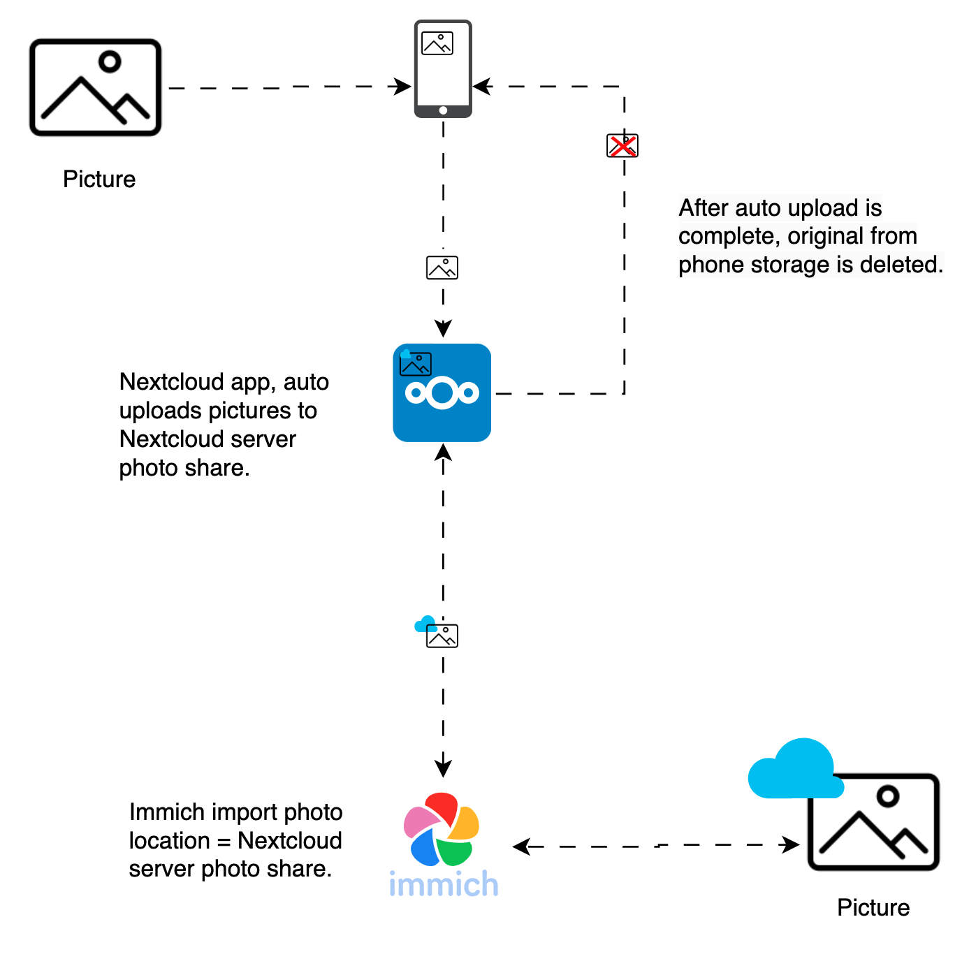

  20. Working on ditching google photos, and use Immich as my 'front end' main Photos/Video app. I'm running into a few issues in this quest as I suspect many others are due to 'Immich' root design of being a Photo/Video backup solution. -end result/expectations: Using mobile phone (Pixel 8 Pro) > Capture Photo/Video > Immich app, backups Photo/Video > Auto deletes Photo/Video from source after backup is completed. -This is the way - Diagram Using mobile phone (Pixel 8 Pro) > Capture Photo/Video > Nextcloud app, Auto uploads to Nextcloud server > After auto upload is complete, original Photo/Video from phone storage is deleted by Nextcloud > Immich import photo/video location = Nextcloud server photo share. Is anyone else using this solution any suggestions are welcome.
