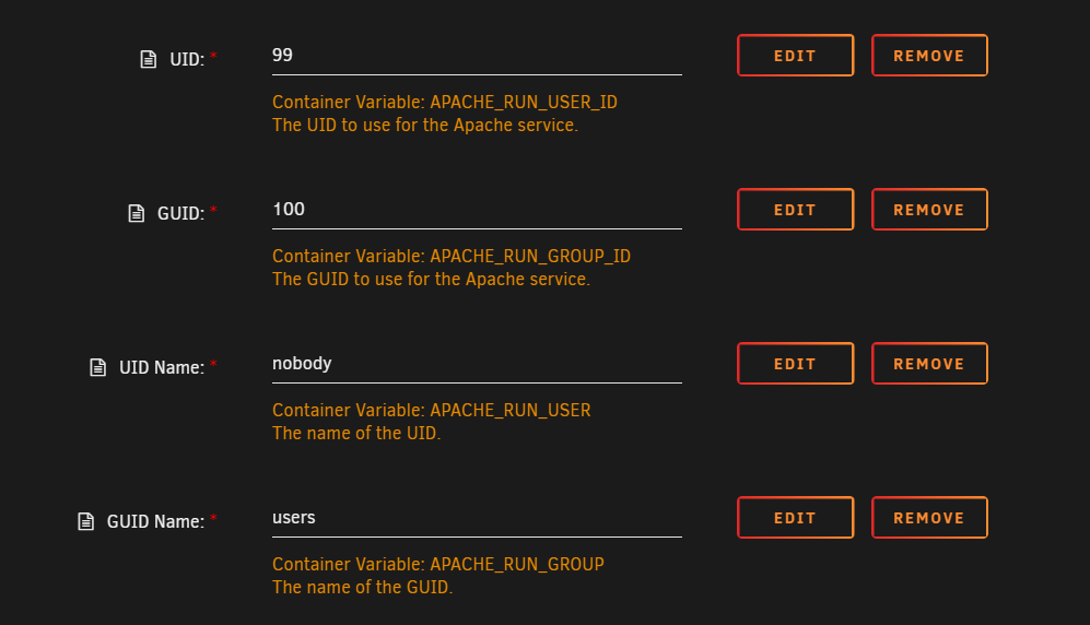

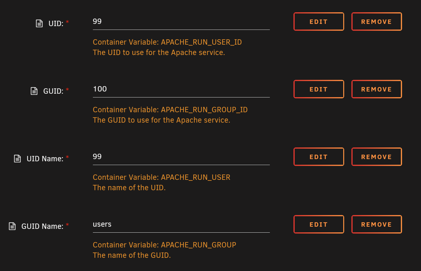

  10. I started seeing this recently as well and tried reverting the UID/GUID settings which seems to have fixed it - give the below config a go and see if it resolves it:
  11. The Installation & Setup section covers all the necessary steps, if you need help then you'll have to provide more specific information about the problems you are facing.
  12. Just testing the above and can confirm that you are correct. The user:group gets set correctly and allows rename/deleting as well as being correctly set to nobody:users with the following UID/GUID config: Quite interesting considering nobody:users is what is stated on FileRun docs.
  13. That's odd - APACHE_RUN_USER and APACHE_RUN_GROUP variables are intended to be the actual UID names and this is how I have always used it which works perfectly fine for me; this is also inline with FileRun docs which shows an example docker-compose.yml which uses these variables as string values of the UID/GUID name alongside the *_ID variables which is what the actual numeric IDs are.
  14. My guess is you'd need to copy over the existing .ini files that are in the docker volume to go into the new mapped directory as it would be expecting to be there (likely generated during initial setup). By this do you mean you had to set the APACHE_RUN_USER_ID + APACHE_RUN_GROUP_ID environment variables in the template to 99 + 100? Or is there elsewhere a change is necessary? I ask this because the template should by default have these preconfigured so it works out of the box.
