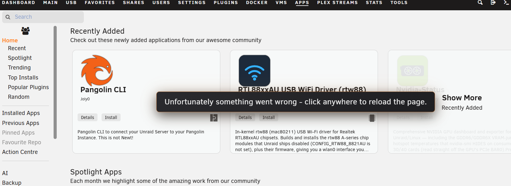

  3. yup it's a bugg! I posted in the product app newly launched and no response as of yet. Maybe if you do upvote someone will take a look at it? community apps not loaded | Unraid i'm sure squid will be the one looking at it lol
