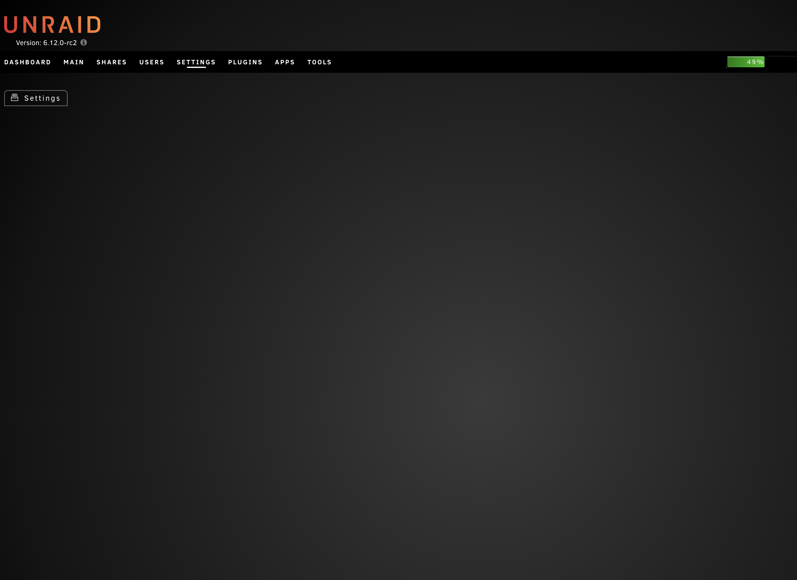

I have an issue here that results in a blank page with 'settings' as a tab in the top left.
The rest of the page is blank...
The only way i can regain access is remove the plugin and reinstall it.
This doesnt last long though before the screen 'refreshes' and goes blank.
- Multiple browsers tried on MacOS 13.3 - Chrome, Firefox and Safari.
- Unable to get log file as i remove and reinstall; there is nothing there.
- Unraid Version: 6.12.0-rc2

Ooops. Thats interesting.
If you see the issue again: Please open Tools -> PHP Options, set "Error reporting level" to "All categories" and check the "Show errors on screen" checkbox. Hit apply and open the page again. Im more than excited to see what the output will be...
(After you reboot the next time, those PHP settings will be reset).
You also not on latest RC, but that should not be the issue here.
Edited by KluthR
PHP Fatal error:  Uncaught TypeError: Cannot assign string to property unraid\plugins\AppdataBackup\ABSettings::$containerOrder of type array in /usr/local/emhttp/plugins/appdata.backup/include/ABSettings.php:82
Stack trace:
#0 /usr/local/emhttp/plugins/appdata.backup/pages/content/settings.php(121): unraid\plugins\AppdataBackup\ABSettings->__construct()
#1 /usr/local/emhttp/plugins/dynamix/include/DefaultPageLayout.php(706) : eval()'d code(2): include('/usr/local/emht...')
#2 /usr/local/emhttp/plugins/dynamix/include/DefaultPageLayout.php(706): eval()
#3 /usr/local/emhttp/plugins/dynamix/template.php(82): require_once('/usr/local/emht...')
#4 {main}
  thrown in /usr/local/emhttp/plugins/appdata.backup/include/ABSettings.php on line 82

Oops. Looking o to that soon.
37 minutes ago, keywal said:
Also this is the latest RC i can see - Maybe you are special? :P
Maybe. Iam on 2.10 now. But we developer have other builds. I thought those were the same now.
Do you have any docker containers in your setup yet?

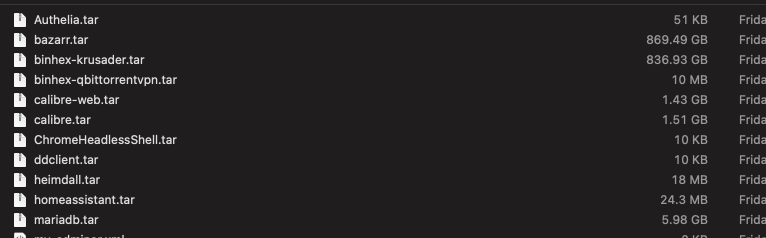

I'm not sure what it was trying to include but I just ran this and had to abort it because two of the apps it backed up (bazarr and krusader) ended up with ~800GB in size for their backups:
I'm running version 2023.04.11
Thanks
Edited by halorrr
Thanks
I'm having the same issue with Plex. The .tar for my 32GB Plex appdata folder was up to ~250GB before I stopped the backup. I tried excluding my media folders thinking it was grabbing those, but that didn't affect anything. I also tried to exclude my Grafana db's, but nah. Good thing we're in beta. ;)
Also, I run Unraid in dark mode, and the coloring is off when you drive to the individual docker settings.
Edited by darcon
For what it is worth here is the section of the debug log for bazarr and krusader for that run:
[14.04.2023 14:08:07][info] Stopping bazarr...
[14.04.2023 14:08:12][info] done! (took 5 seconds)
[14.04.2023 14:08:12][debug] Backup bazarr - Container Volumeinfo: Array
    [0] => /mnt/user/Movies/:/movies:rw
    [1] => /mnt/user/TV Shows/:/tv:rw
    [2] => /mnt/user/Reality TV/:/realityTV:rw
    [3] => /mnt/user/zTV/:/zTV:rw
    [4] => /mnt/user/Anime/:/anime:rw
    [5] => /mnt/user/appdata/bazarr:/config:rw
[14.04.2023 14:08:12][debug] Final volumes: /mnt/user/Movies, /mnt/user/TV Shows, /mnt/user/Reality TV, /mnt/user/zTV, /mnt/user/Anime, /mnt/user/appdata/bazarr
[14.04.2023 14:08:12][debug] Target archive: /mnt/user/Backups/Appdata Backup/ab_20230414_140800/bazarr.tar
[14.04.2023 14:08:12][debug] Generated tar command: -c -P -f '/mnt/user/Backups/Appdata Backup/ab_20230414_140800/bazarr.tar' '/mnt/user/Movies' '/mnt/user/TV Shows' '/mnt/user/Reality TV' '/mnt/user/zTV' '/mnt/user/Anime' '/mnt/user/appdata/bazarr'
[14.04.2023 14:08:12][info] Backing up bazarr...
[14.04.2023 14:09:41][debug] unraid\plugins\AppdataBackup\ABHelper::isVolumeWithinAppdata: /mnt/user/appdata IS within /mnt/user/appdata/Authelia.
[14.04.2023 14:09:41][debug] unraid\plugins\AppdataBackup\ABHelper::isVolumeWithinAppdata: /mnt/user/appdata IS within /mnt/user/appdata/bazarr.
[14.04.2023 14:09:41][debug] unraid\plugins\AppdataBackup\ABHelper::isVolumeWithinAppdata: /mnt/user/appdata IS within /mnt/user/appdata/binhex-krusader.
[14.04.2023 14:09:41][debug] unraid\plugins\AppdataBackup\ABHelper::isVolumeWithinAppdata: /mnt/user/appdata IS within /mnt/user/appdata/data.
[14.04.2023 14:09:41][debug] unraid\plugins\AppdataBackup\ABHelper::isVolumeWithinAppdata: /mnt/user/appdata IS within /mnt/user/appdata/binhex-qbittorrentvpn.
[14.04.2023 14:09:41][debug] unraid\plugins\AppdataBackup\ABHelper::isVolumeWithinAppdata: /mnt/user/appdata IS within /mnt/user/appdata/calibre.
[14.04.2023 14:09:41][debug] unraid\plugins\AppdataBackup\ABHelper::isVolumeWithinAppdata: /mnt/user/appdata IS within /mnt/user/appdata/calibre-web.
[14.04.2023 14:09:41][debug] unraid\plugins\AppdataBackup\ABHelper::isVolumeWithinAppdata: /mnt/user/appdata IS within /mnt/user/appdata/chromedp.
[14.04.2023 14:09:41][debug] unraid\plugins\AppdataBackup\ABHelper::isVolumeWithinAppdata: /mnt/user/appdata IS within /mnt/user/appdata/ddclient.
[14.04.2023 14:09:41][debug] unraid\plugins\AppdataBackup\ABHelper::isVolumeWithinAppdata: /mnt/user/appdata IS within /mnt/user/appdata/heimdall.
[14.04.2023 14:09:41][debug] unraid\plugins\AppdataBackup\ABHelper::isVolumeWithinAppdata: /mnt/user/appdata IS within /mnt/user/appdata/homeassistant.
[14.04.2023 14:09:41][debug] unraid\plugins\AppdataBackup\ABHelper::isVolumeWithinAppdata: /mnt/user/appdata IS within /mnt/user/appdata/mariadb.
[14.04.2023 14:09:41][debug] unraid\plugins\AppdataBackup\ABHelper::isVolumeWithinAppdata: /mnt/user/appdata IS within /mnt/user/appdata/jdownloader2/cfg.
[14.04.2023 14:09:41][debug] unraid\plugins\AppdataBackup\ABHelper::isVolumeWithinAppdata: /mnt/user/appdata IS within /mnt/user/appdata/jdownloader2/logs.
[14.04.2023 14:09:41][debug] unraid\plugins\AppdataBackup\ABHelper::isVolumeWithinAppdata: /mnt/user/appdata IS within /mnt/user/appdata/ombi.
[14.04.2023 14:09:41][debug] unraid\plugins\AppdataBackup\ABHelper::isVolumeWithinAppdata: /mnt/user/appdata IS within /mnt/user/appdata/overseerr.
[14.04.2023 14:09:41][debug] unraid\plugins\AppdataBackup\ABHelper::isVolumeWithinAppdata: /mnt/user/appdata IS within /mnt/user/appdata/plex.
[14.04.2023 14:09:41][debug] unraid\plugins\AppdataBackup\ABHelper::isVolumeWithinAppdata: /mnt/user/appdata IS within /mnt/user/appdata/plex-eros.
[14.04.2023 14:09:41][debug] unraid\plugins\AppdataBackup\ABHelper::isVolumeWithinAppdata: /mnt/user/appdata IS within /mnt/user/appdata/prowlarr.
[14.04.2023 14:09:41][debug] unraid\plugins\AppdataBackup\ABHelper::isVolumeWithinAppdata: /mnt/user/appdata IS within /mnt/user/appdata/qbittorrent.
[14.04.2023 14:09:41][debug] unraid\plugins\AppdataBackup\ABHelper::isVolumeWithinAppdata: /mnt/user/appdata IS within /mnt/user/appdata/qbittorrent-unlimited.
[14.04.2023 14:09:41][debug] unraid\plugins\AppdataBackup\ABHelper::isVolumeWithinAppdata: /mnt/user/appdata IS within /mnt/user/appdata/radarr.
[14.04.2023 14:09:41][debug] unraid\plugins\AppdataBackup\ABHelper::isVolumeWithinAppdata: /mnt/user/appdata IS within /mnt/user/appdata/sonarr.
[14.04.2023 14:09:41][debug] unraid\plugins\AppdataBackup\ABHelper::isVolumeWithinAppdata: /mnt/user/appdata IS within /mnt/user/appdata/stash/generated.
[14.04.2023 14:09:41][debug] unraid\plugins\AppdataBackup\ABHelper::isVolumeWithinAppdata: /mnt/user/appdata IS within /mnt/user/appdata/stash/binary-data.
[14.04.2023 14:09:41][debug] unraid\plugins\AppdataBackup\ABHelper::isVolumeWithinAppdata: /mnt/user/appdata IS within /mnt/user/appdata/stash/config.
[14.04.2023 14:09:41][debug] unraid\plugins\AppdataBackup\ABHelper::isVolumeWithinAppdata: /mnt/user/appdata IS within /mnt/user/appdata/stash/metadata.
[14.04.2023 14:09:41][debug] unraid\plugins\AppdataBackup\ABHelper::isVolumeWithinAppdata: /mnt/user/appdata IS within /mnt/user/appdata/stash/cache.
[14.04.2023 14:09:41][debug] unraid\plugins\AppdataBackup\ABHelper::isVolumeWithinAppdata: /mnt/user/appdata IS within /mnt/user/appdata/swag.
[14.04.2023 14:09:41][debug] unraid\plugins\AppdataBackup\ABHelper::isVolumeWithinAppdata: /mnt/user/appdata IS within /mnt/user/appdata/recipes/data.
[14.04.2023 14:09:41][debug] unraid\plugins\AppdataBackup\ABHelper::isVolumeWithinAppdata: /mnt/user/appdata IS within /mnt/user/appdata/recipes/media.
[14.04.2023 14:09:41][debug] unraid\plugins\AppdataBackup\ABHelper::isVolumeWithinAppdata: /mnt/user/appdata IS within /mnt/user/appdata/tautulli.
[14.04.2023 14:09:41][debug] unraid\plugins\AppdataBackup\ABHelper::isVolumeWithinAppdata: /mnt/user/appdata IS within /mnt/user/appdata/plex/Library/Application Support/Plex Media Server/Logs.
[14.04.2023 14:09:41][debug] unraid\plugins\AppdataBackup\ABHelper::isVolumeWithinAppdata: /mnt/user/appdata IS within /mnt/user/appdata/tdarr/server.
[14.04.2023 14:09:41][debug] unraid\plugins\AppdataBackup\ABHelper::isVolumeWithinAppdata: /mnt/user/appdata IS within /mnt/user/appdata/tdarr/configs.
[14.04.2023 14:09:41][debug] unraid\plugins\AppdataBackup\ABHelper::isVolumeWithinAppdata: /mnt/user/appdata IS within /mnt/user/appdata/tdarr/logs.
[14.04.2023 14:09:41][debug] unraid\plugins\AppdataBackup\ABHelper::isVolumeWithinAppdata: /mnt/user/appdata IS within /mnt/user/appdata/trackerautologin/config.
[14.04.2023 14:09:41][debug] unraid\plugins\AppdataBackup\ABHelper::isVolumeWithinAppdata: /mnt/user/appdata IS within /mnt/user/appdata/Transmission_VPN.
[14.04.2023 17:05:57][debug] Tar out: tar: /mnt/user/Backups/Appdata Backup/ab_20230414_140800/bazarr.tar: Cannot write: No space left on device; tar: Error is not recoverable: exiting now
[14.04.2023 17:05:57][error] tar creation failed! More output available inside debuglog, maybe.
[14.04.2023 17:05:57][info] Starting bazarr... (try #1)
[14.04.2023 17:06:00][info] Stopping binhex-krusader...
[14.04.2023 17:06:01][info] done! (took 1 seconds)
[14.04.2023 17:06:01][debug] Backup binhex-krusader - Container Volumeinfo: Array
    [0] => /mnt/user/appdata/binhex-krusader:/config:rw
    [1] => /mnt/:/UNRAID:rw
    [2] => /boot/:/FLASH:rw
    [3] => /mnt/disks/:/UNASSIGNED:rw,slave
    [4] => /root/:/ROOT:rw
[14.04.2023 17:06:01][debug] Final volumes: /mnt/user/appdata/binhex-krusader, /mnt, /boot, /mnt/disks, /root
[14.04.2023 17:06:01][debug] Target archive: /mnt/user/Backups/Appdata Backup/ab_20230414_140800/binhex-krusader.tar
[14.04.2023 17:06:01][debug] Generated tar command: -c -P -f '/mnt/user/Backups/Appdata Backup/ab_20230414_140800/binhex-krusader.tar' '/mnt/user/appdata/binhex-krusader' '/mnt' '/boot' '/mnt/disks' '/root'
[14.04.2023 17:06:01][info] Backing up binhex-krusader...
[14.04.2023 20:07:34][debug] Tar out: tar: /mnt/user/Backups/Appdata Backup/ab_20230414_140800/binhex-krusader.tar: Wrote only 2048 of 10240 bytes; tar: Error is not recoverable: exiting now
[14.04.2023 20:07:34][error] tar creation failed! More output available inside debuglog, maybe.
[14.04.2023 20:07:34][info] Starting binhex-krusader... (try #1)
Oops. Thank for reporting both issues, I check this asap!

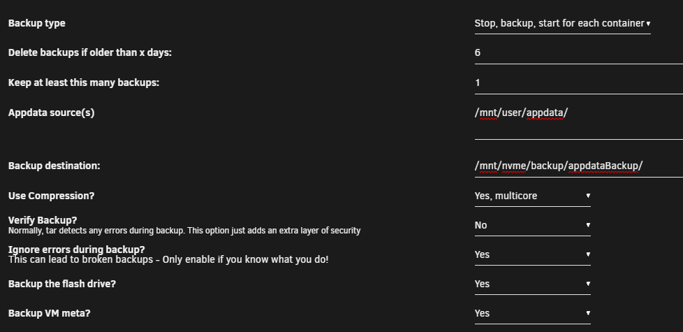

44 minutes ago, KluthR said:
As I can see, the debug log excerpt does not showing sanitizng infos. So: Do you have "Backup external volumes" enabled? This would backup TV Shows etc as well.
I do not see a setting for "Backup external volumes". I do remember seeing it on the old Appdata Backup plugin. I did try disabling the flash drive / VM meta backup, but there was no change.
Edited by darcon

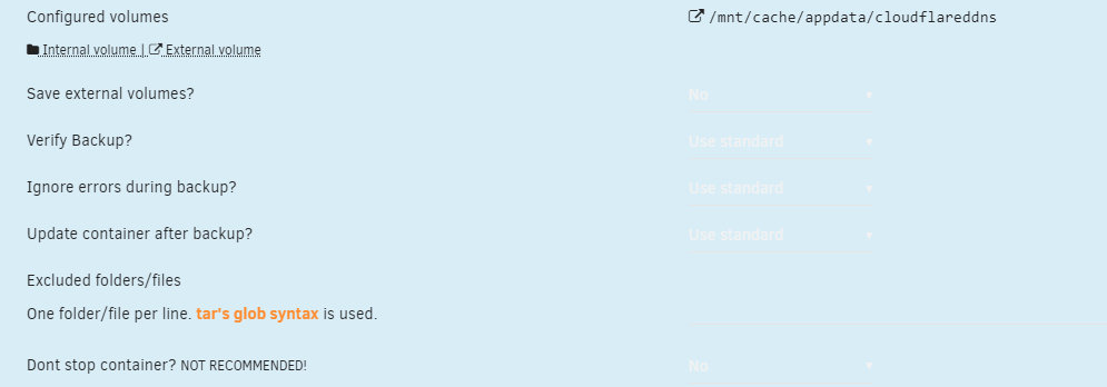

No, that cant be the case, since its a completely new feature ;)
Open the per container settings by clicking on its name. There you will find it.
Not explicitly enabling it means, it should be off. Im curious what its current state is.
