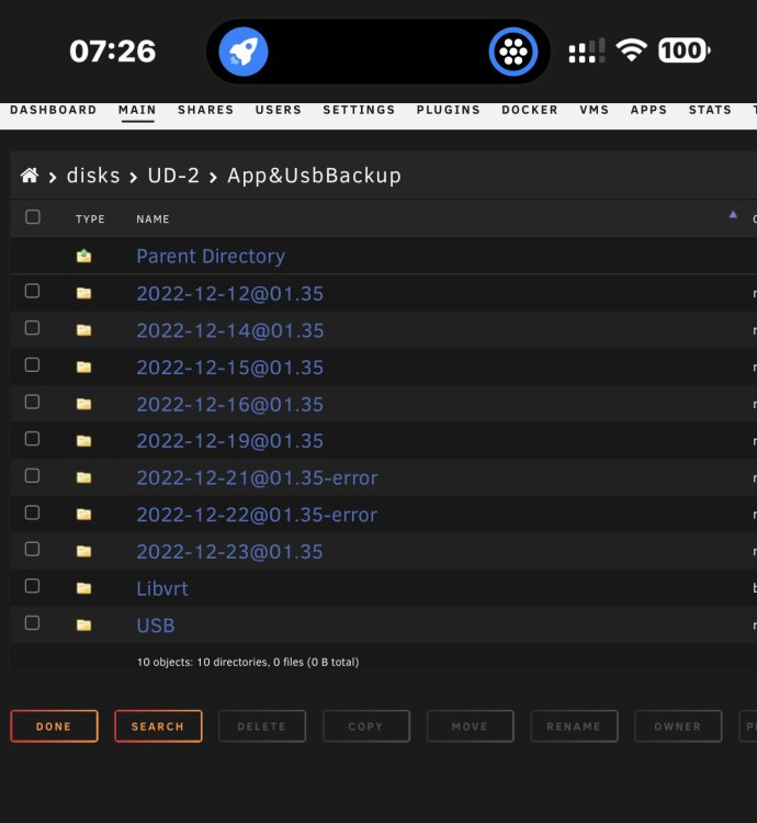

HI
I am getting errors after installing the new version
CA Backup: 25-12-2022 03:06
appData Backup
Backup of appData complete - Errors occurred
But how do i know what the error was ?
I can see some error in log interface see here
Line 39 to 46 show some issue but that path it says is not there is wrong its a shared backup path i have used for years for appdata ???
You can see libvert no issue but appdata nothing from 11 Dec
I removed the Flashdrive backup as i usethe UNraid.net plugin as suggested
Edited by OsoPolar
Yes, as you already wrote: The plugin says, the source folder is not there. Are you sure /mnt/CACHE/appdata is correct? Not /mnt/USER/appdata?
