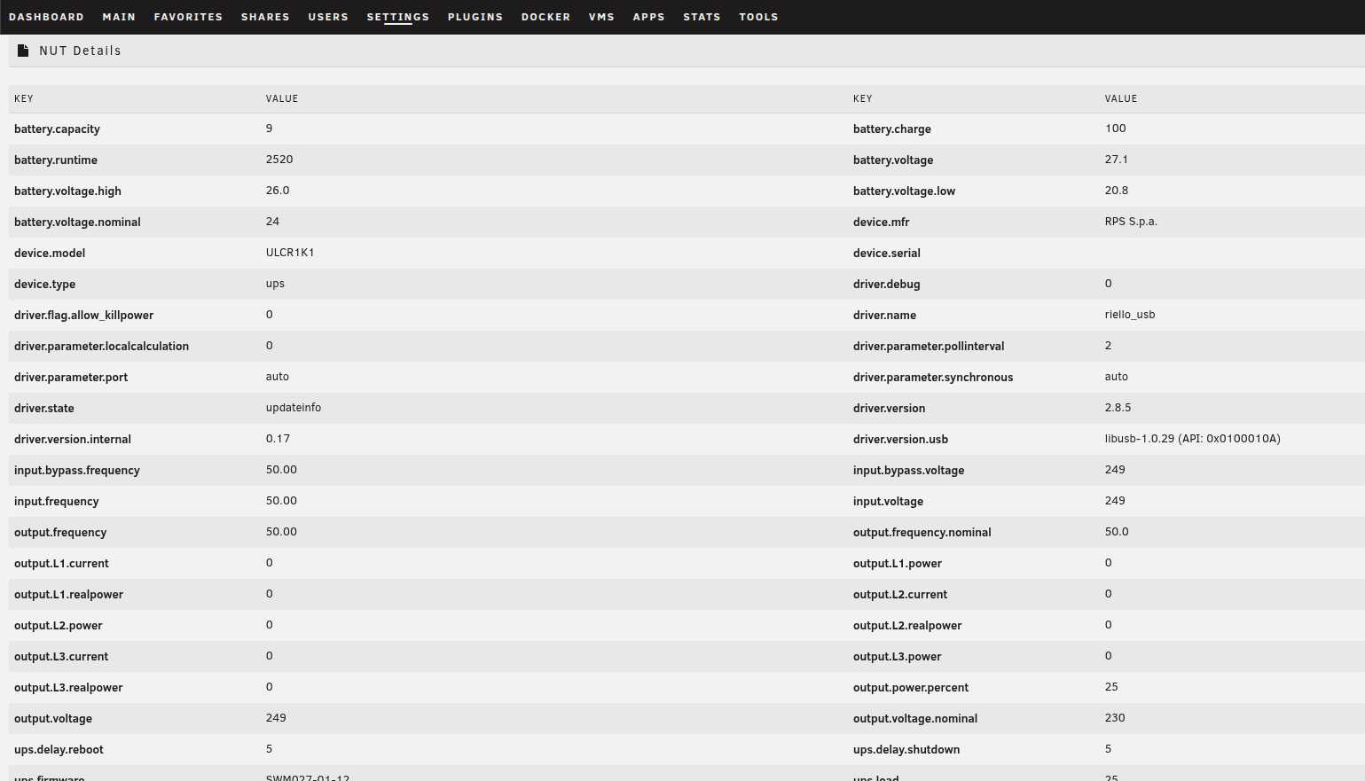

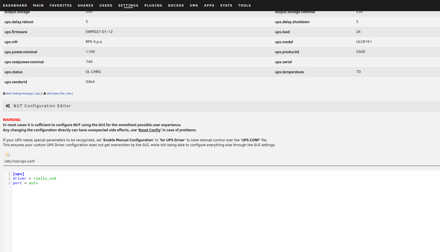

  2. I noticed this flag is set to 0 could this be why the UPS doesn't switch off? If so shouldn't the GUI change the flag setting? driver.flag.allow_killpower 0

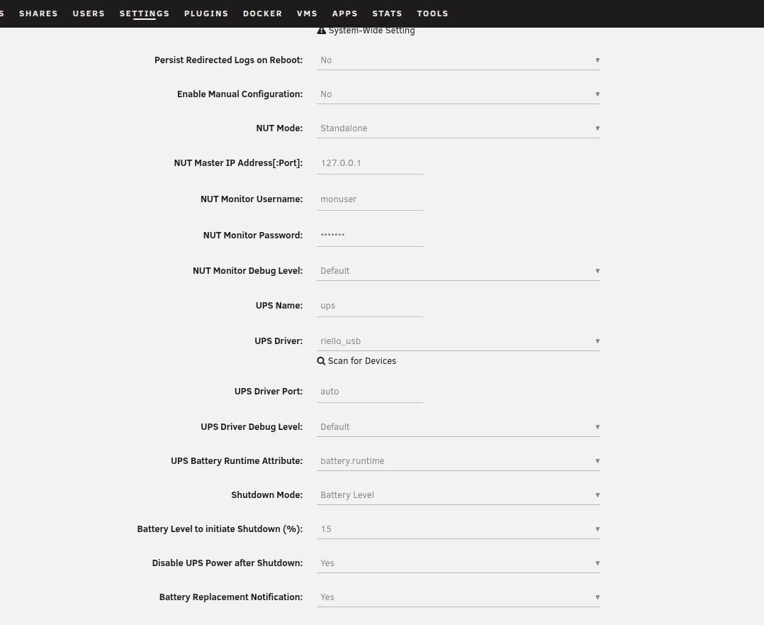

  5. Hi, I've been using the NUT plugin for a while and have noticed that the UPS doesn't turn off after the server shuts down! It's set to do so. Have I missed something? Screenshots attached. Thanks, Tim
  6. Thanks, that was it! 😊
