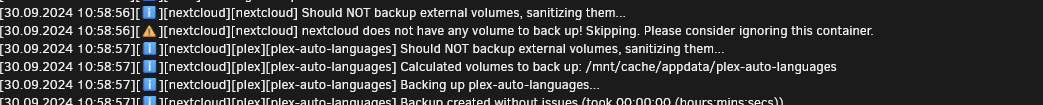

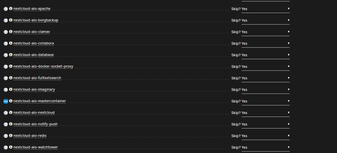

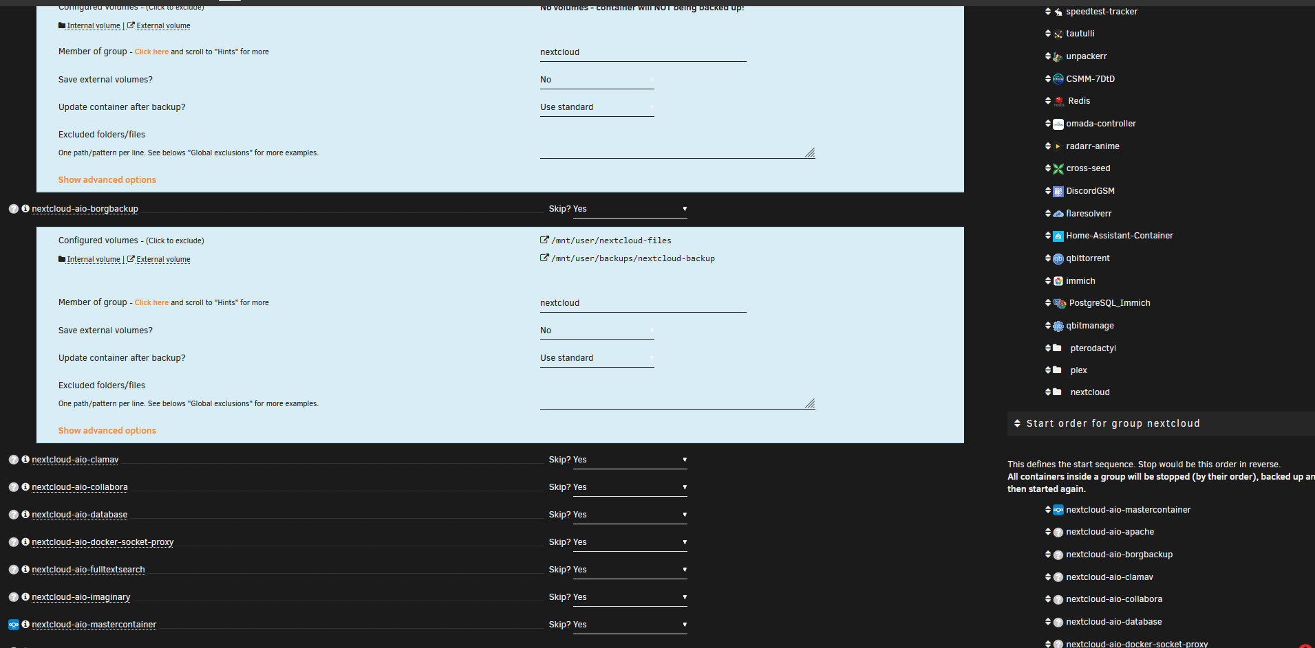

hi there. i'm getting this warning. havent had any warning before this. this "nextcloud" is already been excluded and skip.
anyone know why it still showing a warning?
This refers to a container called "nextcloud" and you don't show settings for one.
sorry about that. thats why it was weird for me. there's no container just called "nextcloud"
what other settings should i add?
thank you for your response/
