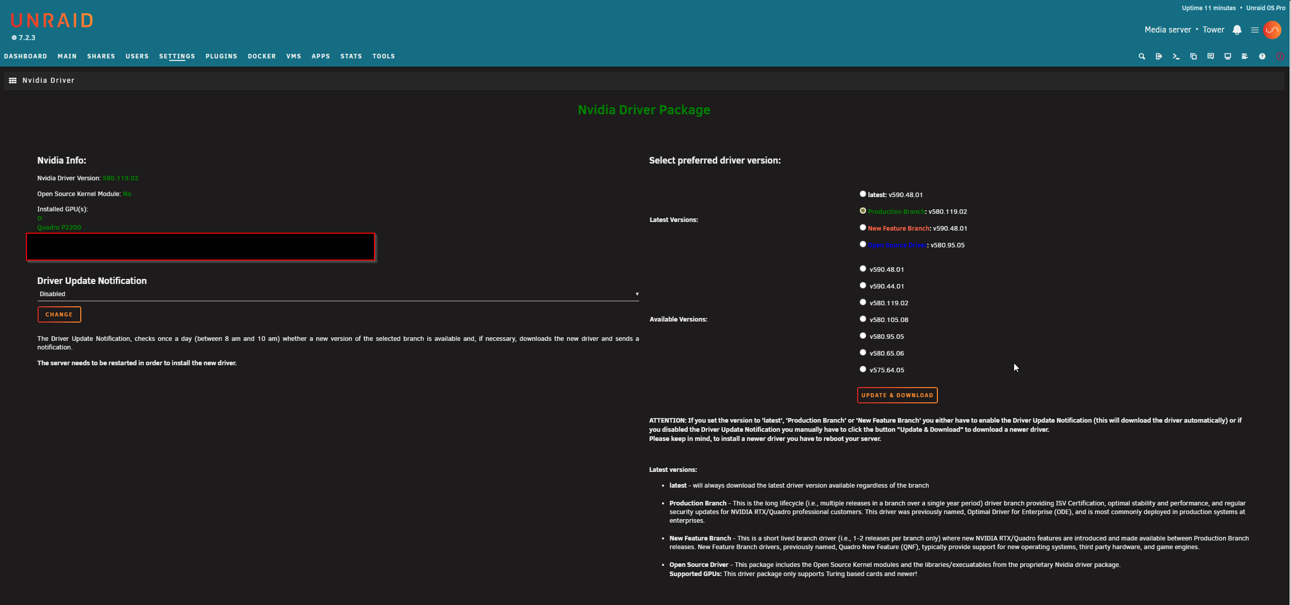

  3. Thanks for the response. Had been travelling for the holidays - just got back to the server. I did not have those two line and I rolled back the driver and restarted and everything is good now. Screenshot below. Does this mean that I am stuck on version 580 until I change this card?
  4. Hello - after a recent update to 7.2.3 (from 7.2.2) i started getting this error. Diagnostics attached. Can anyone help resolve this please? Nvidia Info: Nvidia Driver Version: 590.48.01 Open Source Kernel Module: No Installed GPU(s): NVIDIA-SMI has failed because it couldn't communicate with the NVIDIA driver. Make sure that the latest NVIDIA driver is installed and running. GPU does show up still in the system devices, but I do get a notification saying there was an error and asking me to install the driver manually. Nvidia Driver Dec 21, 09:01 AM NotificationFound new Nvidia Driver v590.48.01 but a download error occurred! Please try to download the driver manually! OMMU group 1: [10de:1c31] b3:00.0 VGA compatible controller: NVIDIA Corporation GP106GL [Quadro P2200] (rev a1) [10de:10f1] b3:00.1 Audio device: NVIDIA Corporation GP106 High Definition Audio Controller (rev a1) tower-diagnostics-20251221-1902.zip
  5. Hello - after a recent update to 7.2.3 (from 7.2.2) i started getting this error. Can anyone help resolve this? Nvidia Info: Nvidia Driver Version: 590.48.01 Open Source Kernel Module: No Installed GPU(s): NVIDIA-SMI has failed because it couldn't communicate with the NVIDIA driver. Make sure that the latest NVIDIA driver is installed and running. GPU does show up still in the system devices, but I do get a notification saying there was an error and asking me to install the driver manually. Nvidia Driver Dec 21, 09:01 AM NotificationFound new Nvidia Driver v590.48.01 but a download error occurred! Please try to download the driver manually! OMMU group 1: [10de:1c31] b3:00.0 VGA compatible controller: NVIDIA Corporation GP106GL [Quadro P2200] (rev a1) [10de:10f1] b3:00.1 Audio device: NVIDIA Corporation GP106 High Definition Audio Controller (rev a1)
