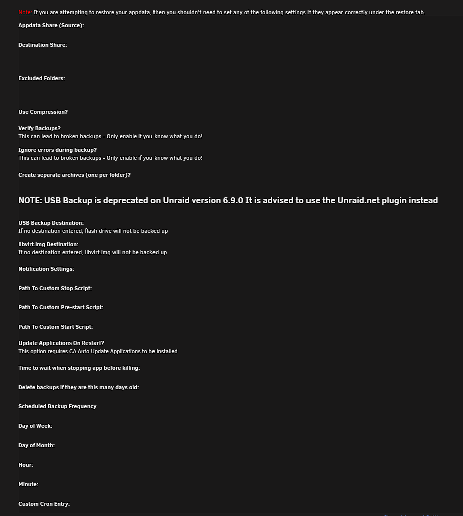

What does "Create separate archives (one per folder)?" option do exactly? Does it create separate archiver per folder in the appdata folder and thus allow the user to restore a single app's appdata folder?
Also why does the Verify Backups option say it can lead to broken backups? Where can I learn more about the pros/cons of enabling this? Thanks
Yes (although I don’t believe that option is yet available in the plugin).
Typically, backups done while the container is still running will fail the verification because the data changed during the backup process. This will result in no backup being created. There have also been a few reports of Plex data changing even though the container is stopped. Possibly some other container is changing that data.
There is quite a bit of discussion regarding this in this support thread.

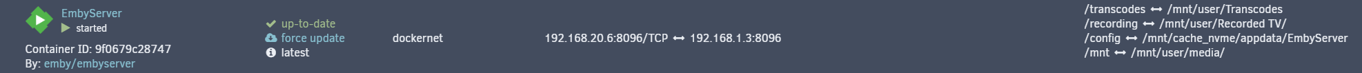

Hi @KluthR,
I've upgraded Unraid and installed latest plugin.
I'm getting a message on some of the containers "does not have any volume to back up".
This causes the container to not get backed-up at all.
e.g. EmbyServer:
[09.05.2023 07:50:07][Main][info] 👋 WELCOME TO APPDATA.BACKUP!! :D
[09.05.2023 07:50:07][Main][debug] plugin-version: 2023.04.27
[09.05.2023 07:50:07][Main][debug] unraid-version: Array
    [version] => 6.12.0-rc4.1
[09.05.2023 07:50:07][Main][info] Backing up to: /mnt/user/backup/Unraid/AppdataBackup/ab_20230509_075007
[09.05.2023 07:50:07][Main][info] Saving container XML files...
[09.05.2023 07:50:07][Main][info] Method: Stop/Backup/Start
[09.05.2023 07:51:55][EmbyServer][info] Stopping EmbyServer...
[09.05.2023 07:51:59][EmbyServer][info] done! (took 4 seconds)
[09.05.2023 07:51:59][EmbyServer][info] EmbyServer does not have any volume to back up! Skipping
[09.05.2023 07:51:59][EmbyServer][info] Starting EmbyServer... (try #1)

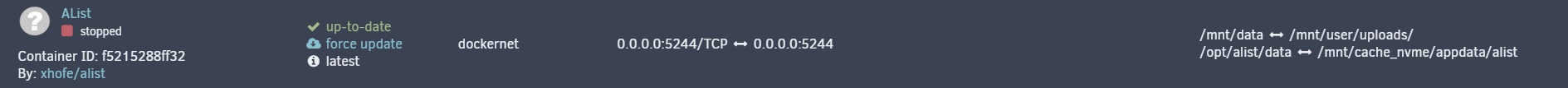

Here's my Docker page with Emby:
Same thing with AList container:
Prior appdata-backup plugin backed up all appdata folders and not skip anything, any idea what is happening now?
Thanks
It creates one folder per found appdata folder NOT PER CONTAINER since the "v2.5" ist not capable of detecting container based folders. The all-new appdata.backup does.
Additional to @wgstarks answer: DISabling this can lead to broken backups, because ignoring verification errors could lead to broken data, since any error will be discarded then.
The advantage is obvious: A 100% working backup (in matter of valid data) is always our goal, so we have to make sure:
* Containers are stopped during their backup, to ensure it does not change data during backup
* Verification is an extra layer of certainty: It checks the original data again against the just created archive. If only one bit differs, it throws an error. Sometimes containers share shares between each others, this would bring it up to your attention (in that example case one want to exclude it in one of the containers).
A backup while the to backing up files are being modified CAN work, but dont have to. This is up to every user by configuring it as needed. Default settings have all checks enabled.
Your post seem to have broken styling - apart from that:
The old plugin(s) were backing up folder by folder. The new backup does not: It reads every docker container volume mapping and uses that - and only that information.
Please post your debug logfile to get this confimred: It seems you have "Backup external volumes?" disabled, leading to skip any container volume mapping thats outside your configured "Allowed source paths" setting. With no volume left, it skips the backup for that container. Please open the help blocks for "Allowed source paths" to get more infos how the plugin differentiate between Internal and External volumes.
EDIT: The last post is about the new plugin, this thread is for the old one. If more help is needed, please switch to the new one (see 1st post)
Edited by KluthR
You da man! That was it, I only had mnt/user/appdata listed, I added /mnt/cache_nvme/appdata and now everything is getting backed up :)
Thanks much!

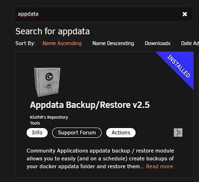

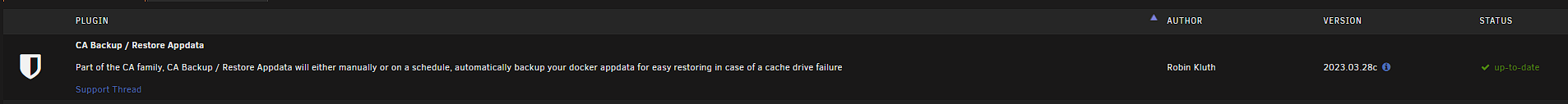

No, you are talking about ca.backup2. I talk abot the new appdata.backup. It has those options. See 1st post.
Thank you for your reply.
I have checked the apps and this is the only one that appears and that is the one that I have installed, and I am using. I do not see any Post-run Script
Please pay attention to the details: Appdata.backup is available starting with Unraid 6.12+ only. Appdatabackup/Restore 2.5 is deprecated since 6.12+
Thank you. Currently running Ver 6.11.5. Have not update to 6.12 RC5.
Appreciate your responses.
