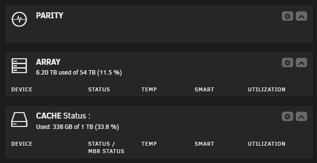

  2. I am having a strange issue that is causing me to pull my hair out and am hoping someone can help set me. I have been trying to get ownCloud working for a few weeks now. I tried the one from the appstore. I was able to get it to work with the exception of being able to put it behind traefik. Nothing I did would make it work. So, I redid it manually using the owncloud repo. Everything seems to work great. I can login to the webui. I can sync using the client. But, anytime I try to add another client it seems to kill the container. There are no messages in the logs, but it stops responding, both the webui and the clients. When it stops responding I am unable to stop, kill, restart, or delete the container. At this point all other containers and the unRAID webui work fine. If I try to add the client a second or third time all containers stop responding and so does unRAID. I can login using SSH, but no commands seem to work. If I try to reboot it gives the message that it is rebooting but never does. My only option at this time is to power off and then power back on. If I don't start the ownCloud container it will work for days with no issues. If I start the ownCLoud container and don't try to add any clients it seems to stay running as well. my-ownCloud.xml
  3. Ok, after spending way too many hours rebooting with just one new plugin added I found the issue. It wasn't even a plugin. Posting the resolution here in case someone else has the same issue. The problem was in the /boot/config/dashboard_settings.json file. I renamed this file to dashboard_settings.json.bak and the dashboard came right up. Didn't even need to reboot for this.
  4. I tried that and tried from another computer. I also tried updating to the RC released today. Still no dashboard.
  5. Tried, still blank dashboard.
