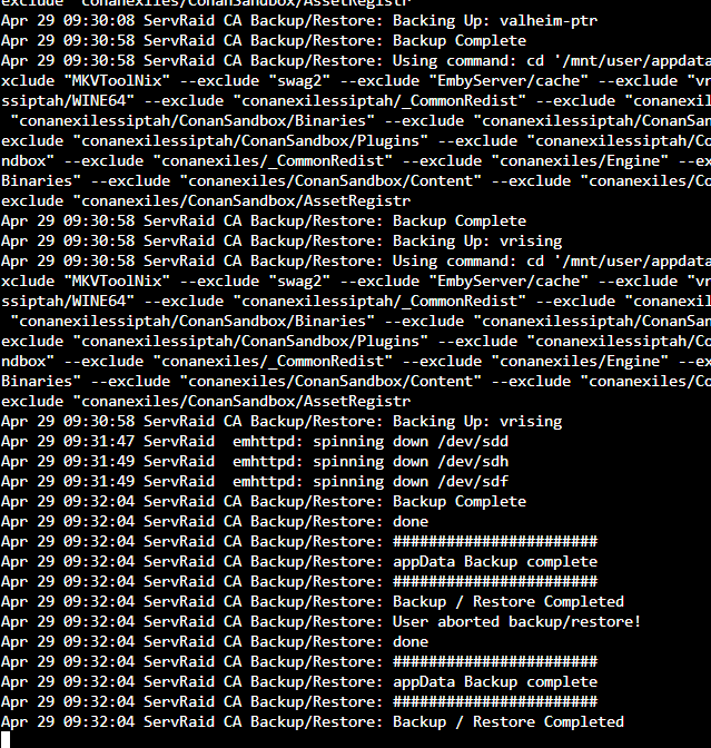

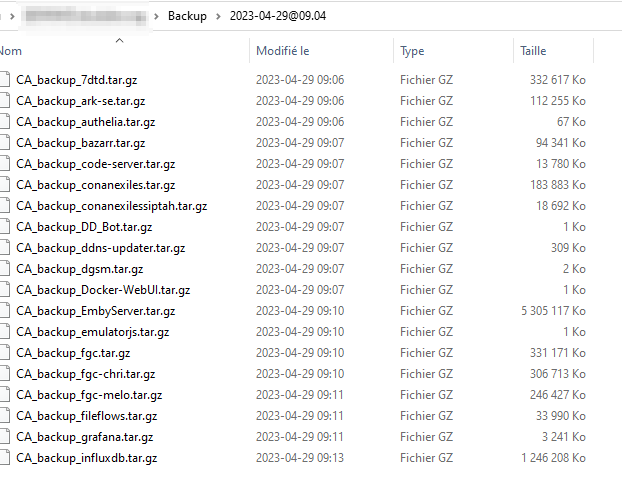

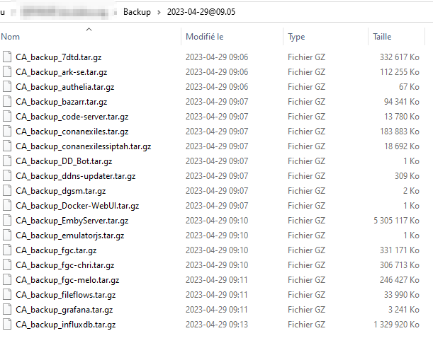

Hello,
I think I hit a bug. I turned off docker and the array. Did some stuff then started the array.
I decided while the docker service is down, let's take a full backup (I normally have stuff I don't close that fail to backup properly). But during the backup sequence (maybe 1 minute after starting it), I though of something I should do first and hit the abort button.
Then, I moved by docker folder (found out it was nested way too far) without starting docker (in the setting page).
I start the backup again.
The log on screen show it's backing up everything twice. When I check on my backup folder, I see 2 backup dated for today at 1 min interval and both are getting filled with new backup.
edit: At the end, the log says it has both finished and aborted. Both folder have exactly same files and log at the end

7 hours ago, KluthR said:
It seems, that the container is still running.
That was my first thought but in the Docker page it showed as stopped.
To be sure I just tried running the backup again after first stopping binhex-qbittorrentvpn and got the same error message so I think something else is afoot.
3 hours ago, Nodiaque said:
think I hit a bug.
It could be, yes. I think the Abort function was broken after I implemented separate archive function.
TBH: I dont want to take any more time for the old plugin. It is definitively working with the new one.
