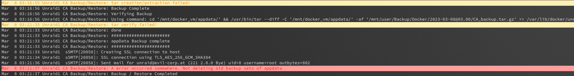

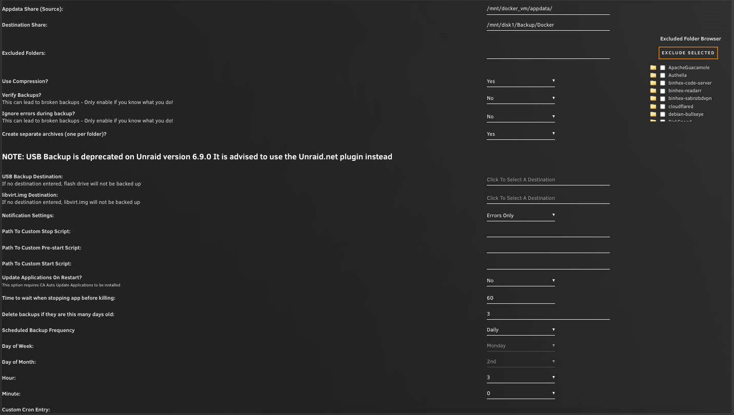

I had this running flawlessly for quite a while. I installed SmokePing a few weeks ago and for some reason it refuses to start back up after the backup process automatically, but always starts up once I start it from the GUI. I excluded it for now in hopes to get a successful backup and clean out the old ones. any ideas?
since a few days I get after each backup always the following messages in the logs and in addition the notification:
Backup of appData complete - Errors occurred
In the Syslog i can only see this:
And here are my Settings:
Perhaps in the next update can be built in that despite an error the old backups are deleted.
maybe someone can help me.
Thanks
On 3/11/2023 at 11:29 AM, KluthR said:
No, thats just right. Both setting can lead to broken backups. First one if backups are not verified and second if errors occur which will be discarded silently.
the BackupMainV2 name will be gone with the new version.
Is this right? As worded, it sounds like setting "Verify Backups?" to "Yes" can result in broken backups. But isn't the point of verification to ensure that they aren't broken?
Oh, no, no. Setting it „No“ could cause ot (because not being verified). If the main tar process say its all ok, the chances are very low that it is broken. Just a extra layer of security.  The wording is wrong and already fixed for the upcoming update.

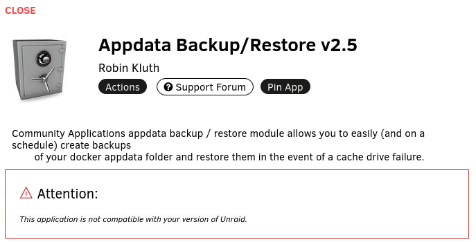

I upgraded to 6.12 RC2 and get the following message in the CA Store.
Is this plugin really not compatible anymore?
Is there a new version here?
There is an update in preparation for 6.12. I hope to release it just before Unraid 6.12 becomes stable.

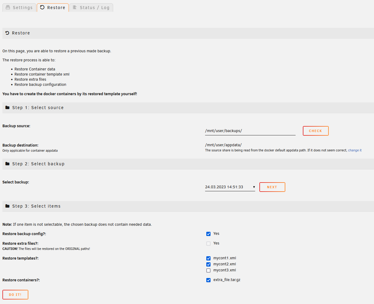

Update:
I finished the main part: backup :)
All is working well (at least it seems so).
Currently working on last things for the restore:
Beta very soon.
Please also note, that backups created via previous plugin versions are NOT supported!
The first things beta testers should do: test this in any other browser than Firefox. I just tested everything in FF for now...
Edited by KluthR

[20.03.2023 03:36:50] tar verify failed!
[20.03.2023 03:36:50] done
[20.03.2023 03:36:50] Starting qbittorrent... (try #1)  done!
[20.03.2023 03:36:50] Waiting 2 seconds before carrying on
[20.03.2023 03:36:52] Starting Unraid-API... (try #1)  done!
[20.03.2023 03:36:53] Waiting 2 seconds before carrying on
[20.03.2023 03:36:55] Starting Nginx-Proxy-Manager-Official... (try #1)  done!
[20.03.2023 03:36:55] Waiting 2 seconds before carrying on
[20.03.2023 03:36:57] Starting unpackerr... (try #1)  done!
[20.03.2023 03:36:59] Starting binhex-prowlarr... (try #1)  done!
[20.03.2023 03:36:59] Waiting 2 seconds before carrying on
[20.03.2023 03:37:01] Starting radarr... (try #1)  done!
[20.03.2023 03:37:02] Waiting 1 seconds before carrying on
[20.03.2023 03:37:03] Starting Sonarr... (try #1)  done!
[20.03.2023 03:37:03] Waiting 1 seconds before carrying on
[20.03.2023 03:37:04] Starting overseerr... (try #1)  done!
[20.03.2023 03:37:05] Waiting 2 seconds before carrying on
[20.03.2023 03:37:07] Starting EmbyServer... (try #1)  done!
[20.03.2023 03:37:10] Starting MariaDB-Official... (try #1)  done!
[20.03.2023 03:37:10] Waiting 2 seconds before carrying on
[20.03.2023 03:37:12] Starting nextcloud... (try #1)  done!
[20.03.2023 03:37:12] Waiting 2 seconds before carrying on
[20.03.2023 03:37:14] Starting binhex-krusader... (try #1)  done!
[20.03.2023 03:37:15] Waiting 2 seconds before carrying on
[20.03.2023 03:37:17] A error occurred somewhere. Not deleting old backup sets of appdata
[20.03.2023 03:37:17] Backup / Restore Completed
Same here: you dont stop all containers and wanted valid backups. Thats not possible.
turn off verification or allow all containers to stop.
Running Unraid 6.11.5, CA Appdata Backup 2023.01.28
so this seems related to other posts I've seen here, but I don't have any exclusions for stopping containers. They're all set to stop, backup, then restart, but I've gotten errors the past two days about `Error while stopping container! Code: Container already started`, on a single different container each time, and then of course a verification difference on the affected container. Logs of past two nights attached.
I can stop the containers manually without issue, so not sure why CA Appdata Backup is listing it as "already started"
