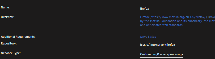

  2. no, I was never able to make it work. I resolved to just running the qbittorrent_vpn container on a regular bridge. Then within the container itself, setup the VPN connection (instructions are there). For every other container I have it using the `wg0` network as described above.
  3. When editing the container config, set Network Type to `wg0`. Also make sure that the `wg0` connection is active under your VPN setup.
