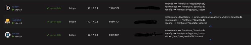

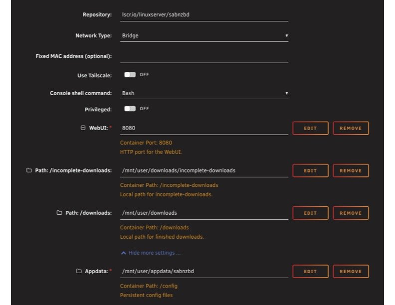

  • When deluge is finished, it's telling Sonarr that the file is stored in /data/completed/..., but you don't have /data/completed mapped to /downloads/completed on sonarr or radar  Add that mapping, and

    I left /data and /config alone, deleted /media and created /mnt ( = /mnt) for Sonarr, Radarr and qBitTorrentvpn.
