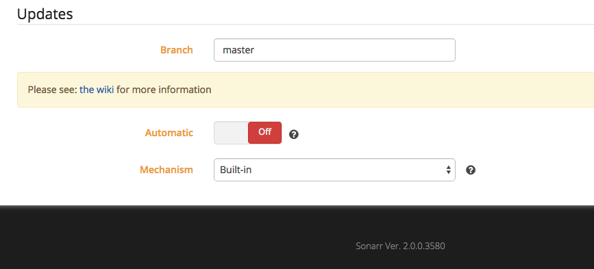

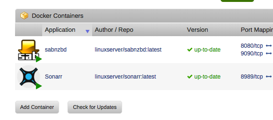

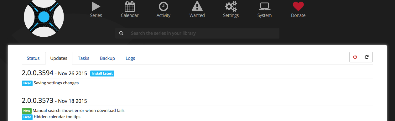

Morning...
Did that...Same version. 2.0.0.3580.
Docker tells me I am up-to-date.  (Clicking check for updates shows the same.)
Sonorr says to "Update to the latest version".
I have automatic updates in Sonorr turned off. (For I am not sure if I can use that with a Docker thingy. Or do I now treat it as a normal install and use the auto update from within Sonorr?)
SABnzbd is Version: 0.8.0Beta1 [1ba588f]  Check for New Release is OFF within SABnzbd.  (Are they all beta versions?)
Thanks!

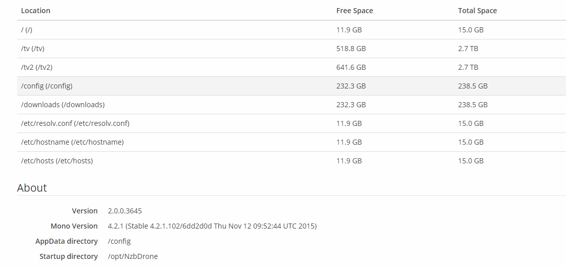

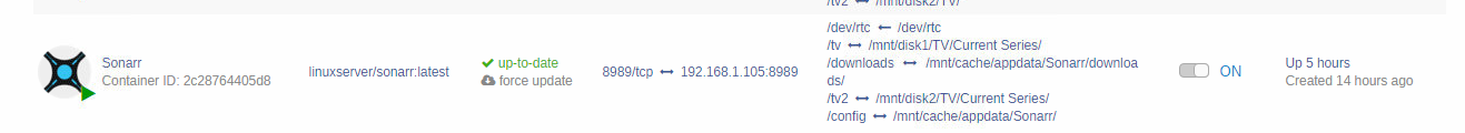

I have read through all of this and may have missed it but I seem to be having issues with Sonarr pulling all my tv shows that have been downloaded. I have imported them all but they are spread across multiple drives. Could this be causing the issue? When I had Sonarr installed on my pc it was easy cause it just pulled from a mapped drive.
Sounds more like a Sonarr config issue than a docker container issue to me, but as always unless you give us more information on how you've set up the container, we'd be shooting in the dark..
Post some info on your config and a screenshot of your docker mappings in Unraid and I'll take a look.
Here is how things are currently set up. It appears to be pulling only info from "disk 1"
Why map individual drives?  Just map /tv to /mnt/user/tv and all your shows will be in there.  No need to map each drive individually...
