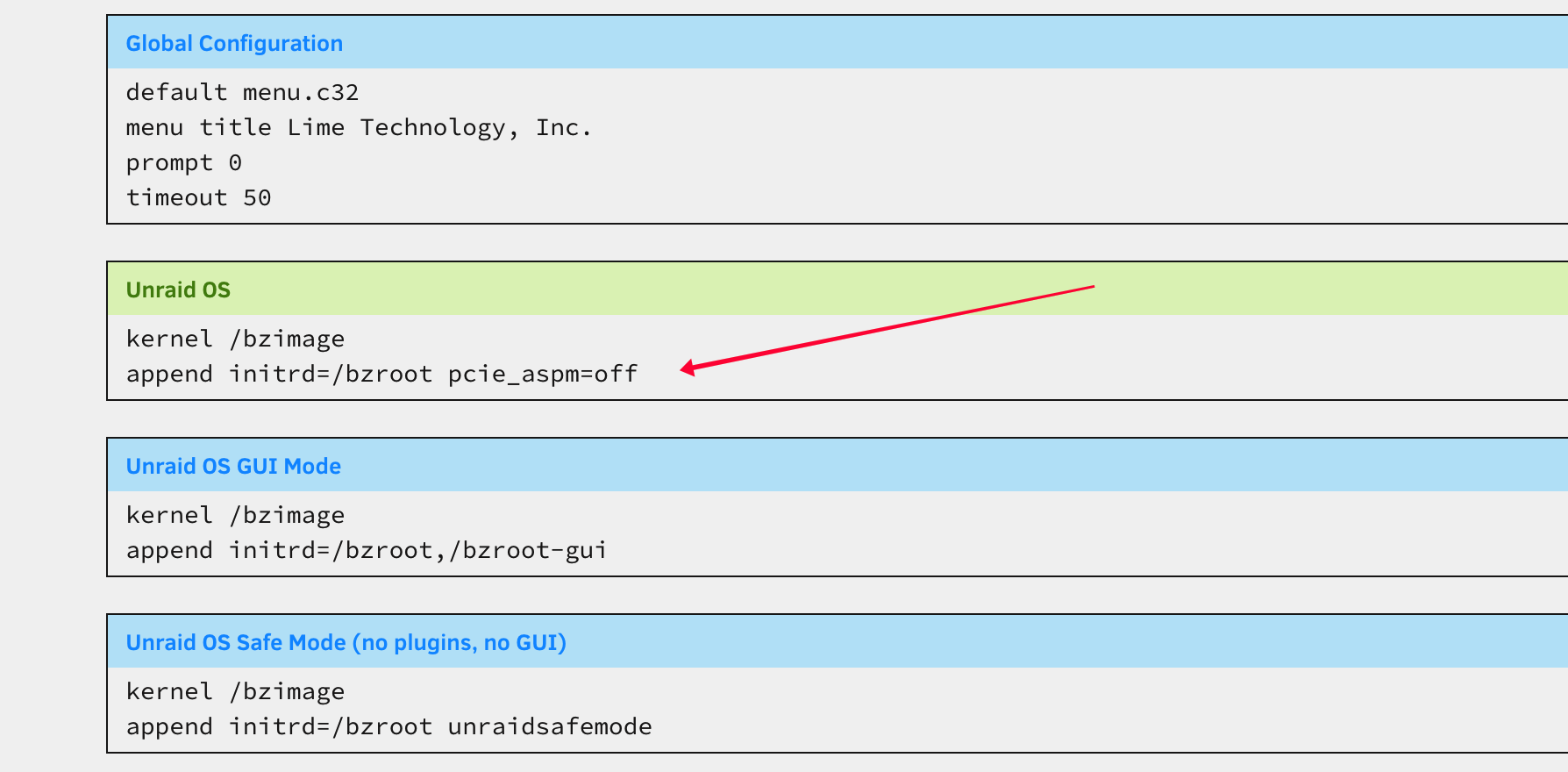

  5. Hi... I added... append initrd=/bzroot pcie_aspm=off ...to the UnRAID OS config area. (Click on Flash Drive to get to the right area.) Add it in as a new line, save and reboot.

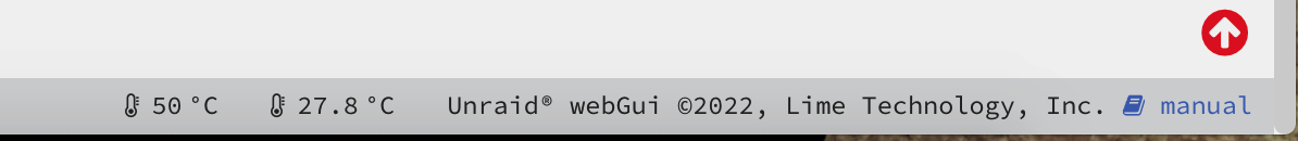

  6. Thanks...Ok, did that...Bummer, even after a restart and a rescan, no changes, Still can not see the fans. System temp readings seems to the be the same and the only items I can see.

  8. Might I ask how you installed those drivers so your temp and fans could be seen? Thanks

  10. RIGHT on all of the above!!! SOME have been moved to unRAID directly, but where? One of the BIG ONES, one the most people are looking for, are the FAN control which requires being able to read various temp sensors for one, which is missing or not well done or not kept up with the drivers, but then being able to control the fan outputs based on the temps. Heck, I can't even see my fan speeds any more. i can see the temp...But even though I can see the temps, I can't do anything with them. A BIG THING when it comes to running a NAS with many drives. Sorry... I have been an unraid users and promoter from when it 1st started....David Bott - Founder of AVSFroum.com But now I am looking to many to have to move as I get concerns over hardware failures when I can not monitor critical items.

  14. Morning...And a good one it is! No errors in the log using pcie_aspm=off Might I ask where you came up with that being likely the issue? Thanks
  15. Hi...Thanks for the idea. I just added it to my Sys Config so it now looks like this... kernel /bzimage append initrd=/bzroot pcie_aspm=off ...saved and rebooted. I will check the log tomorrow morning and see if I have the errors still and report back.
