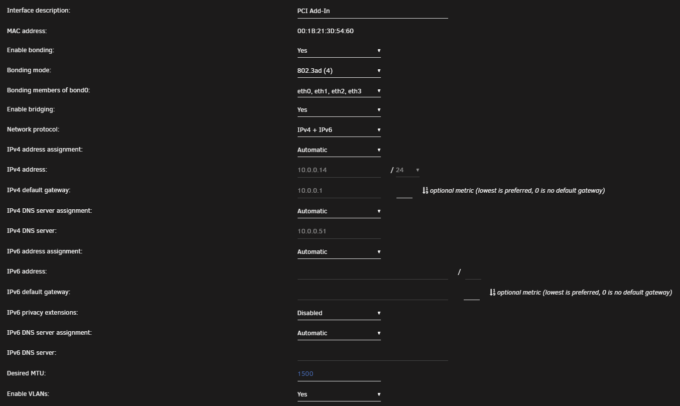

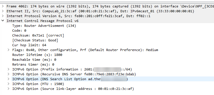

March 11, 20224 yr Trying to get home network up and running with IPv6 (SLAAC + DHCPv6 [O+A]). Still new, so please correct me if I'm wrong about something. OPNSense is the router. radvd is running with advanced options handing out DNS server. Wireshark capture on another box seem to show that the Router Advertisements are working. my ISP is Comcast, and I've requested a /60 from them, which OPNSense has gotten and listed and is handing out. Other machines on my network are getting an IPv6 from the /60 subnet. I'm running Unraid with 4 interface bonded together on eth0. When I changed Unraid fom `IPv4` to `IPv4 + IPv6`. The Network settings refresh with the DHCP v4 address, but the IPv6 address and default gateway are both blank. If I SSH in, then it shows br0 getting an IPv6 address from the same subnet, but not the bond0 interface. root@media-1:~# ip -6 addr 1: lo: <LOOPBACK,UP,LOWER_UP> mtu 65536 state UNKNOWN qlen 1000 inet6 ::1/128 scope host valid_lft forever preferred_lft forever 24: bond0: <BROADCAST,MULTICAST,PROMISC,MASTER,UP,LOWER_UP> mtu 1500 state UP qlen 1000 inet6 fe80::21b:21ff:fe3d:5460/64 scope link valid_lft forever preferred_lft forever 25: br0: <BROADCAST,MULTICAST,UP,LOWER_UP> mtu 1500 state UP qlen 1000 inet6 2601:****:****:****:7c63:e8ff:feac:ade5/64 scope global dynamic mngtmpaddr noprefixroute valid_lft 86384sec preferred_lft 14384sec inet6 fe80::7c63:e8ff:feac:ade5/64 scope link valid_lft forever preferred_lft forever What am I missing?
March 11, 20224 yr Author sorry, typed too fast. Okay, `br0` is the main interface, I was wrong. bond0 is a member of br0. (which explains why I could get ipv6 traffic). What lead me to believe I wasn't getting an address is on the Unraid Network Settings page, it's showing eth0's IPv4 address, but under IPv6, everything is blank.

March 14, 20224 yr Author 19 hours ago, bonienl said: The IPv6 assignment is correct. This is my test server with a bonded interface (4 members) and bridge function enabled. The unusual part is the IPv6 address is not shown under the interface settings. Q: what vlan number do you use for the br0.1 / bond0.1 interface? It should be 2 or higher (not 1). A: That was me being dumb. Will reset to 2. I have no VLANs on my network yet, so the one on Unraid to get Docker IPv6 is the only VLAN I'd be running. In order to diagnose the IPv6 issue, I'm going to just get rid of all VLANs for the time being. However... when I removed the VLAN, waited for it to refresh, lost the IPv6 information again. (I did see it briefly, however I'm unable to explain what triggered it) * no IPv6 information on Settings -> Network page 28: bond0: <BROADCAST,MULTICAST,PROMISC,MASTER,UP,LOWER_UP> mtu 1500 qdisc noqueue master br0 state UP group default qlen 1000 link/ether **:**:**:**:**:** brd ff:ff:ff:ff:ff:ff inet6 fe80::21b:21ff:fe3d:5460/64 scope link valid_lft forever preferred_lft forever 29: br0: <BROADCAST,MULTICAST,UP,LOWER_UP> mtu 1500 qdisc noqueue state UP group default qlen 1000 link/ether **:**:**:**:**:** brd ff:ff:ff:ff:ff:ff inet 10.0.0.14/24 brd 10.0.0.255 scope global dynamic noprefixroute br0 valid_lft 690882sec preferred_lft 604482sec inet6 ****:****:****:****:9c23:e7ff:fe43:6916/64 scope global dynamic mngtmpaddr noprefixroute valid_lft 86351sec preferred_lft 14351sec inet6 fe80::9c23:e7ff:fe43:6916/64 scope link valid_lft forever preferred_lft forever this is confirmed when I run `curl https://ifconfig.co` I get the reply of my Global IPv6 address (issued via SLAAC) that's listed under `br0` so IPv6 looks like it's working from Unraid, but no IPv6 information is showing under Settings -> Network
