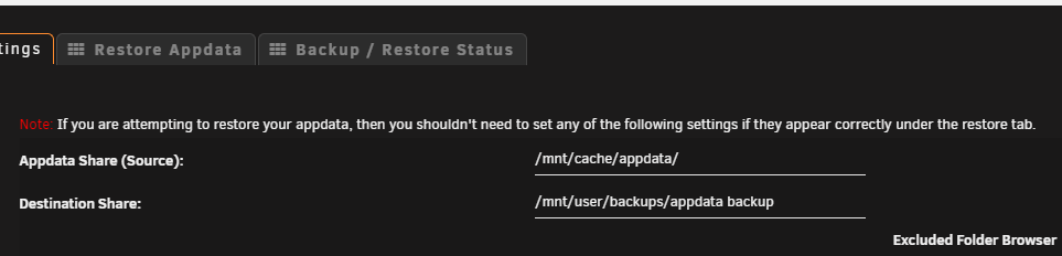

Click the backup/restore status tab in the settings pane.
Does it matter if you use a Disk location for the Appdata Share Source? ie. /mnt/cache/appdata/   while using a Share as a Destination? ie. /mnt/user/backups/appdata-backup
I know this practice is bad for moving data across the array.
1 hour ago, FrozenGamer said:
would using windows machine to extract and copy those files vs terminal cause any problems with the install in appdata?
That depends, winrar in windows does not copy symlinks for example. And I don't know if it preserves permissions either. Best way to do it is via the CLI. It's super simple and faster.
