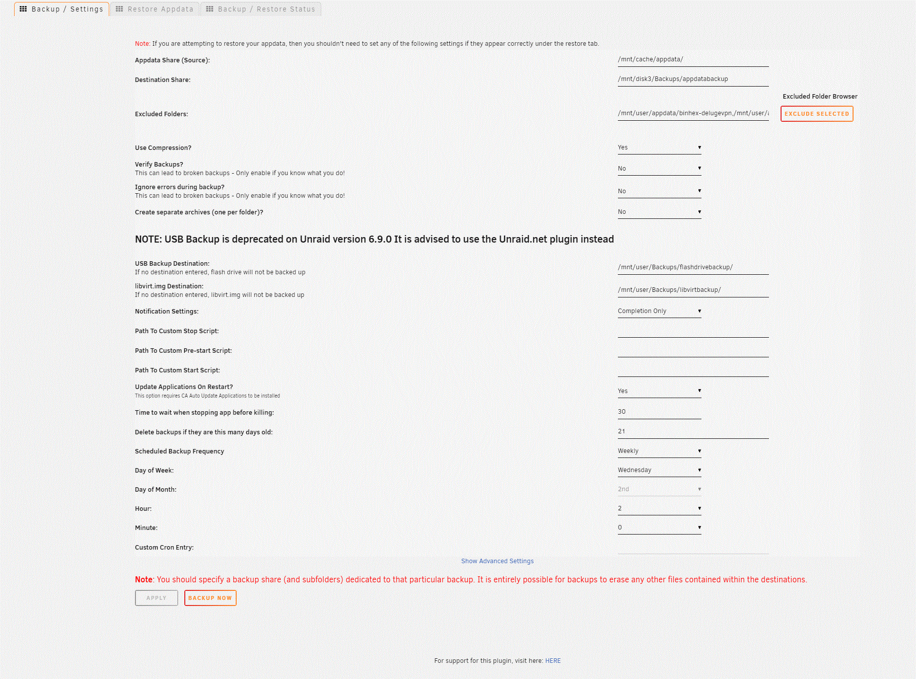

Having issues with the CA backup, Everytime its finished it makes the permissions of the new backup where i cant open it. I can chmod it to make it accessible. Any thoughts?

when you use the "Excluded Folder Browser" you can only pick top level folder, would be nice to have it show actual tree and be able to pick the nested folder to be a bit more surgical. right now i do this via cli then come back and just put in the path manually (which works fine).

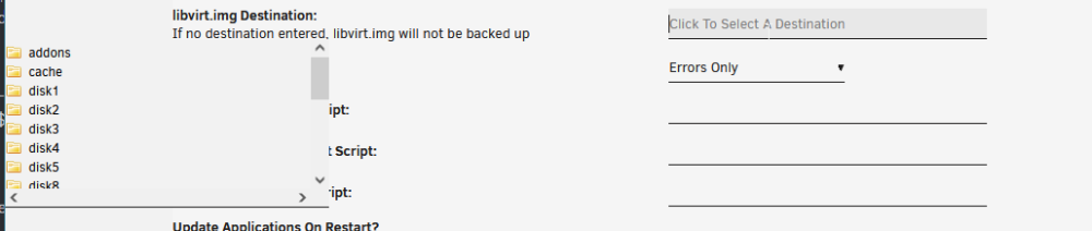

the folder selector for USB Backup Destination: / libvirt.img Destination:  show up in the wrong spot:
