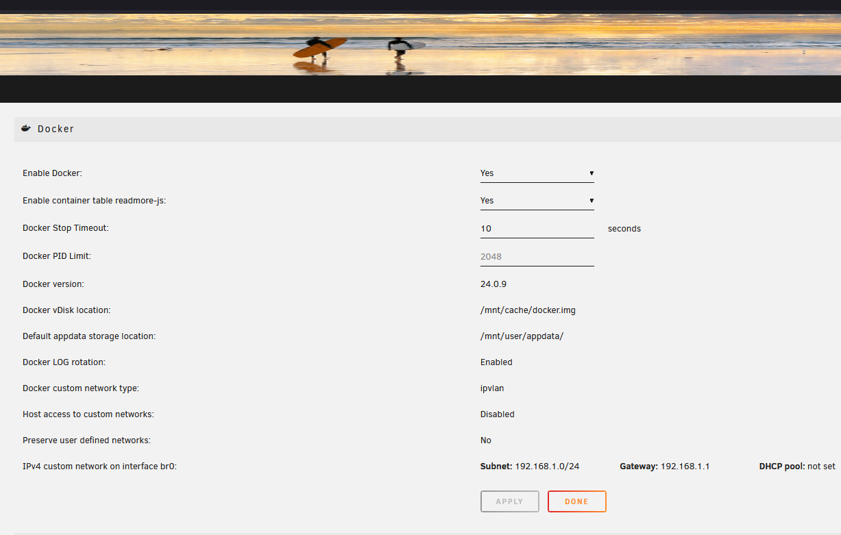

Not Solved (still have a problem when wireguard is setup even if disabled.)-Docker updates stuck on "checking" rebooted server and still doesn't work
I am heading out for one more remote job, so i created new wireguard connections, which has broken the check all updates on docker, stays on checking.. However i did have an update that was available before i enabled wireguard and that update shows up when i load the docker page still. I rebooted the server and tried a different browser.. the single update persisted and i was able to update it.. I cannot however check for updates and it stays forever spinning on "checking." I will do a few disabling of wireguards and see if that solves it (it didn't seem to before) .. the problem eventually just went away.. so maybe it did..
Updated Diagnostics. Although server has been rebooted many times. @JorgeB any thoughts? tower-diagnostics-20241010-1443.zip
a little concerned about breaking something so i will wait for any other ideas before i go this route. I kind of recall doing it years ago and only having minor fixes needed.
I guess i should add that i was able to check plugins for updates and that worked without hanging up. Only place i have noticed a problem so far is in the docker management page.
OK. i have done so, and restarted docker service (but not full system reboot) - seems to still be stuck..
Clock appears to be correct.
Thanks.. i unplugged router for 30 and rebooted. still same issue happening. i currently have 1.1.1.1 and 1.0.0.1 as dns, will try changing that as well.
