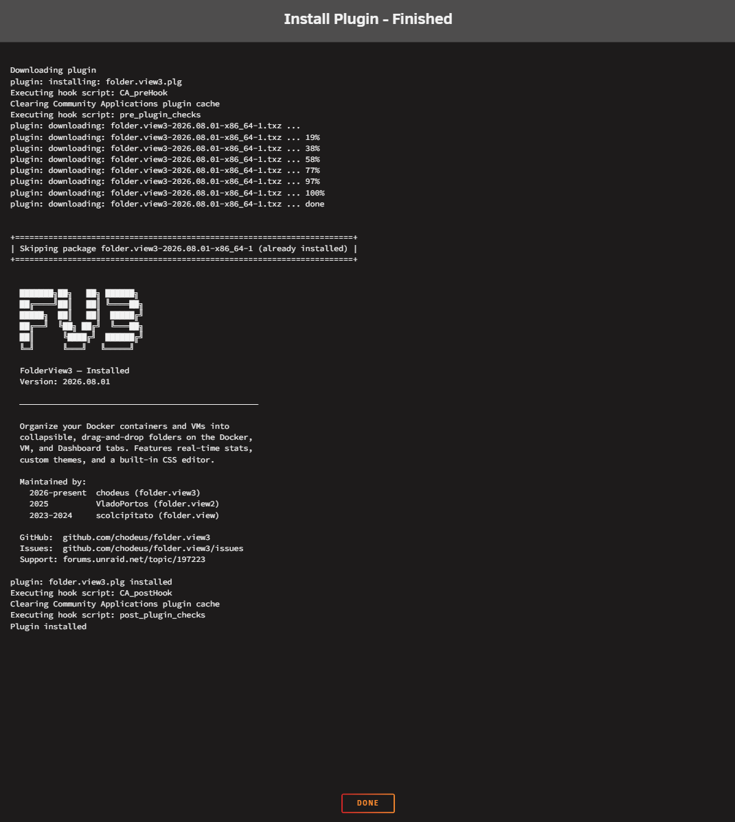

  1. That did the trick, the "Force Install" option. Thank you.

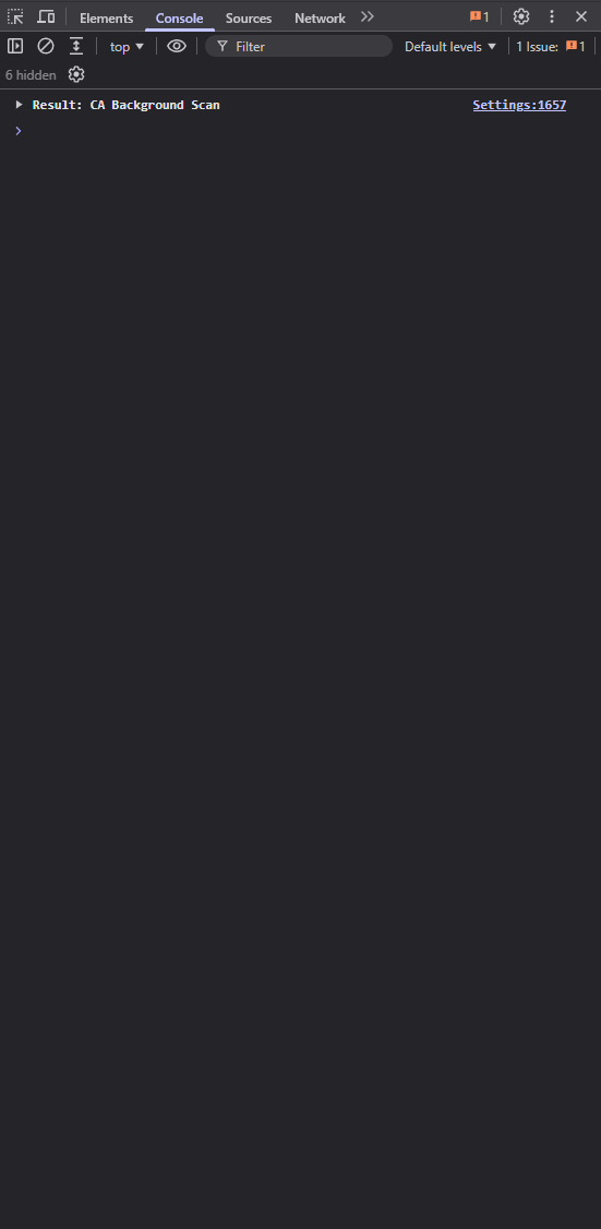

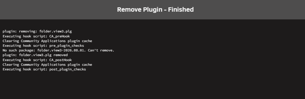

  2. Yes uninstalling and reinstalling the whole plugin. Yes. I hard refresh my browser. Also, tried different browser. This is what it look like in the browser dev console: When I install the plugin. When I uninstall the plugin: @chodeus Can you try this on your end? Uninstalling and reinstalling the whole plugin? Thanks. BTW, these are the logs on syslog: Aug 13 20:57:42 HHUBS plugin-manager: executing inline script: /bin/bash '/tmp/inline4-folder.view3.sh' Aug 13 20:57:42 HHUBS plugin-manager: folder.view3.plg removed Aug 13 20:58:26 HHUBS plugin-manager: executing inline script: /bin/bash '/tmp/inline1-folder.view3.sh' Aug 13 20:58:26 HHUBS plugin-manager: creating: /boot/config/plugins/folder.view3/folder.view3-2026.08.01-x86_64-1.txz - downloading from URL https://raw.githubusercontent.com/chodeus/folder.view3/main/archive/folder.view3-2026.08.01-x86_64-1.txz Aug 13 20:58:26 HHUBS plugin-manager: checking: /boot/config/plugins/folder.view3/folder.view3-2026.08.01-x86_64-1.txz - MD5 Aug 13 20:58:26 HHUBS plugin-manager: running: upgradepkg --install-new /boot/config/plugins/folder.view3/folder.view3-2026.08.01-x86_64-1.txz Aug 13 20:58:26 HHUBS plugin-manager: executing inline script: /bin/bash '/tmp/inline3-folder.view3.sh' Aug 13 20:58:26 HHUBS plugin-manager: folder.view3.plg installed Aug 13 21:02:49 HHUBS plugin-manager: executing inline script: /bin/bash '/tmp/inline4-folder.view3.sh' Aug 13 21:02:49 HHUBS plugin-manager: folder.view3.plg removed Aug 13 21:03:09 HHUBS plugin-manager: executing inline script: /bin/bash '/tmp/inline1-folder.view3.sh' Aug 13 21:03:09 HHUBS plugin-manager: creating: /boot/config/plugins/folder.view3/folder.view3-2026.08.01-x86_64-1.txz - downloading from URL https://raw.githubusercontent.com/chodeus/folder.view3/main/archive/folder.view3-2026.08.01-x86_64-1.txz Aug 13 21:03:09 HHUBS plugin-manager: checking: /boot/config/plugins/folder.view3/folder.view3-2026.08.01-x86_64-1.txz - MD5 Aug 13 21:03:09 HHUBS plugin-manager: running: upgradepkg --install-new /boot/config/plugins/folder.view3/folder.view3-2026.08.01-x86_64-1.txz Aug 13 21:03:09 HHUBS plugin-manager: executing inline script: /bin/bash '/tmp/inline3-folder.view3.sh' Aug 13 21:03:09 HHUBS plugin-manager: folder.view3.plg installed Aug 13 21:04:23 HHUBS plugin-manager: executing inline script: /bin/bash '/tmp/inline4-folder.view3.sh' Aug 13 21:04:23 HHUBS plugin-manager: folder.view3.plg removed.

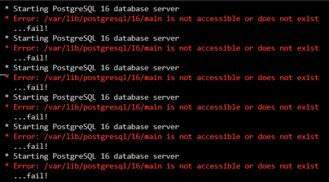

  5. Thanks. But when I tried the updated template and installing second instance of euro office to test, I got the below error. The nginx fail.
  6. @Junker der Provinz hello, when I install euro office I get the below error. I just supplied the JWT secret and I get this error.

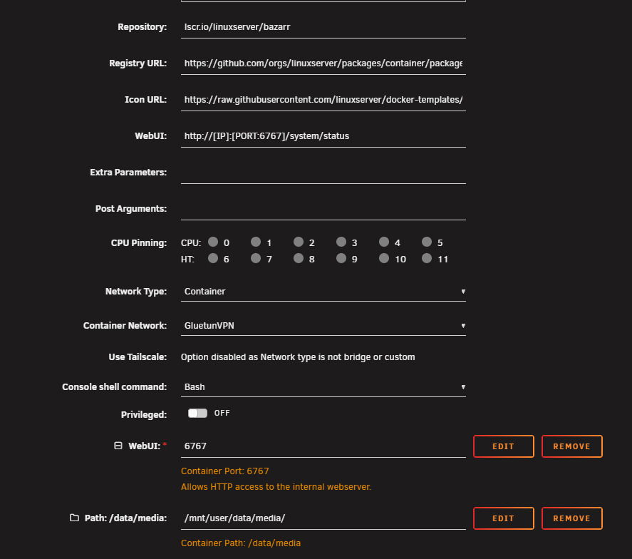

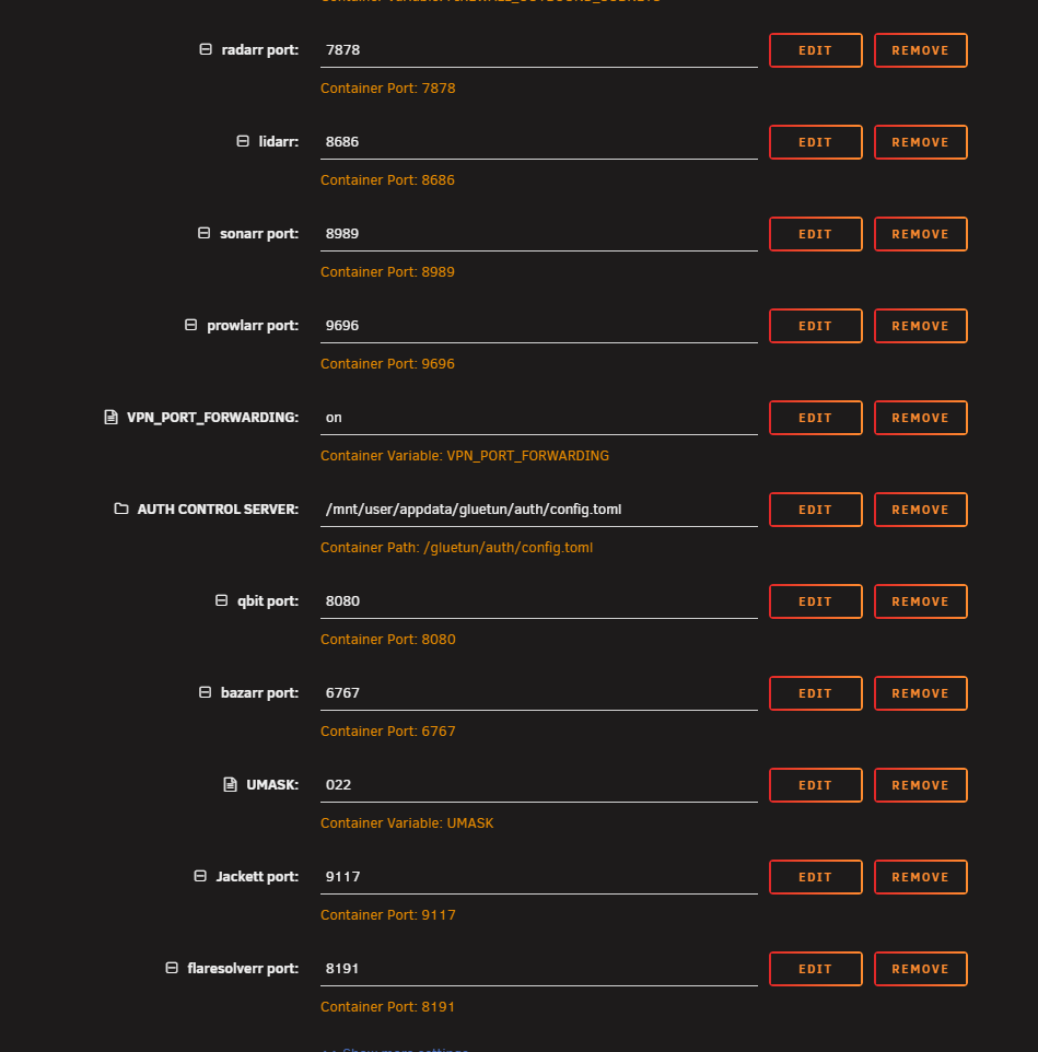

  12. "you'd manually set the webui in the container template" Can you please let me know if I need to put it in the GluetunVPN or in the Bazarr(for example) template? Here's my GluetunVPN: This is for Bazarr(for example). Where should I put the one your saying? Please let me know. Thank you.
  13. Hi @chodeus can you please check? Dockers that have network type to a container does not have the "web gui" icon. For example, my qbittorrent and arr stacks(which network type is GluetunVPN) does not have the gui icon. In the folderview2, it does have it.

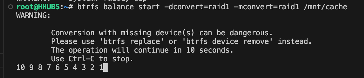

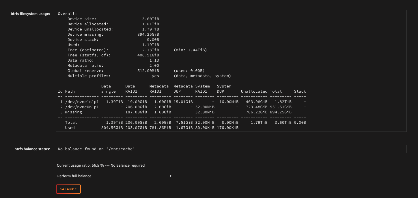

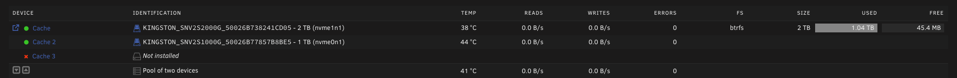

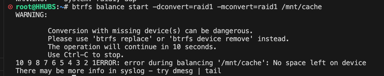

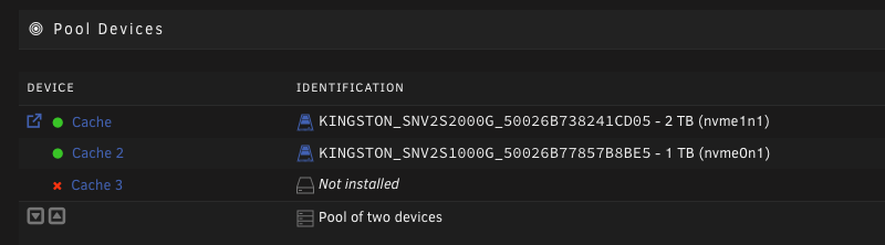

  14. When I try to use mover, it doesn't do anything. When I try unbalance plugin, I gain same storage like 10 GB but I need at least 80 GB to complete the btrfs conversion. Some of the files that I move has not gain me storage. Why is that? I don't know if I can make it to 80 gb of free storage.
  15. Can the move be done by the "mover" or should I use unbalance plugin? Also, can I start the docker or should I wait to fix this mess before starting docker?
