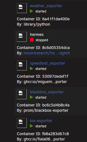

Missing ? docker icon log spam
I'm not sure when this started but I've noticed my logs just spamming missing question.png file and some not all docker apps the missing icon flashes constantly. Any ideas on how to fix it?
Thanks!
unraid-diagnostics-20260719-0806.zip
Edited by Fiala06
