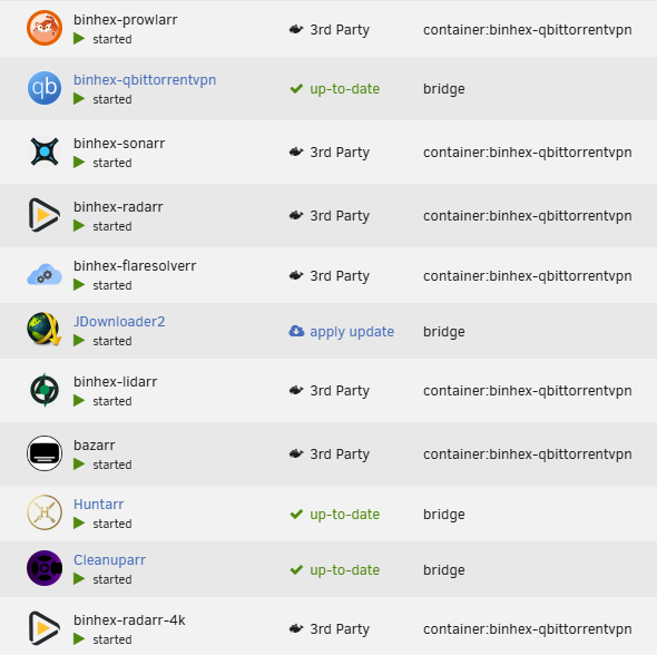

Anyone else seeing VPN-linked containers randomly become “3rd party” in 7.2.x?
I wasn’t manually adding it. I was using the dropdown It was 100% rebuild-dndc. It worked fine for years but now when it rebuilds a container Unraid loses track and thinks it’s 3rd party Not had the issue at all since moving to a different VPN stack
Thanks. I didn't think I'd need this as everything seemed to be fine - but a week or so later all the child containers started returning bad gateway - had to restart them all by hand I've added the autoheal container now 😊
So far switching to Gluetun and away from the binhex containers - no longer using Rebuild-DNDC - has been bullet proof, and as a nice side effect a LOT more responsive 👍
The templates are 100% still there - to "fix" them I just add container, choose template, it restarts the container - no longer shown as 3rd party I don't user docker compose - all were added through Apps It's very weird because this setup has been running for 4+ years now and never an issue. However, I've been meaning to get off the binhex- containers for a while because they take minutes to startup hanging on deleting from /tmp every time so this afternoon I've switched to gluetunvpn and migrated all the binhex containers to linuxserver ones - much faster setup. I'm going to keep Rebuild-DNDC turned off and see if this stays stable
Hey all, I’m trying to work out whether I’m hitting a weird edge case or if this is something others are seeing in Unraid 7.2.x. SetupUnraid 7.2.3 binhex-qbittorrentvpn binhex Sonarr / Radarr / Prowlarr / Lidarr / Flaresolverr + Bazarr All child containers use: --net=container:binhex-qbittorrentvpnRebuild-DNDC at the bottom of the startup order, running on bridge network This setup has been rock solid for a long time. What’s happeningAfter a VPN/network event, all containers using --net=container:binhex-qbittorrentvpn suddenly show up as “3rd party” in the Docker UI: No Edit button Can’t update them Containers themselves are running fine Only way to recover is to recreate them from the existing user templates This has now happened twice within 24 hours. What I’ve found so farLooking at the Rebuild-DNDC logs, this happens whenever the VPN container’s Docker endpoint ID changes. Rebuild-DNDC then (correctly) rebuilds all dependent containers. Example from the log: MASTER container ENDPOINTID DOESN'T MATCH REBUILDING: binhex-qbittorrentvpn The rebuild uses normal docker run commands with the same names, paths, and configs — everything works — but Unraid then treats those containers as permanently “3rd party”. Rebuild-DNDC questionI’ve seen a few comments suggesting Rebuild-DNDC isn’t needed anymore in 7.2.x because Unraid will restart child containers automatically? I tried disabling it for a week test this, but when the VPN container restarted, all child containers lost connectivity and never recovered until manually restarted. So at least in my setup, Rebuild-DNDC still seems necessary. Curious if others are seeing thisAnyone else using binhex-qbittorrentvpn + --net=container: seeing containers flip to 3rd party? Is this new behaviour in 7.2.x? Has anyone found a way to prevent Unraid losing track of these containers? Happy to share logs if helpful.
