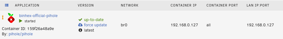

January 19, 20251 yr Orbital-sync won't connect to my secondary Pi-hole instance: 1/19/2025, 9:35:13 AM: ➡️ Signing in to http://192.168.0.121/admin... 1/19/2025, 9:35:13 AM: ✔️ Successfully signed in to http://192.168.0.121/admin! 1/19/2025, 9:35:13 AM: ➡️ Downloading backup from http://192.168.0.121/admin... 1/19/2025, 9:35:13 AM: ✔️ Backup from http://192.168.0.121/admin completed! 1/19/2025, 9:35:13 AM: ➡️ Signing in to http://192.168.0.127/admin... 1/19/2025, 9:35:16 AM: ⚠ Failure: An unexpected error was thrown: - FetchError: request to http://192.168.0.127/admin/index.php?login failed, reason: connect EHOSTUNREACH 192.168.0.127:80 1/19/2025, 9:35:16 AM: ⚠ Failure: 0/1 hosts synced. 1/19/2025, 9:35:16 AM: Waiting 30 minutes... The 0.127 Pi-hole is a Docker container running on the same Unraid machine as orbital-sync. That Pi-hole instance is set up with a Custom:br0 network type and a different IP address from the Unraid server because configuring it as the default Bridge type created a port conflict on port 53. A support post on the orbital-sync GitHub says (in response to a similar question): Quote Is Orbital Sync running in the same docker engine as your Pi-hole instance? If so, you will likely need to use the internal docker assigned IP address (and container port) to Pi-hole, not the public IP and port. Docker containers communicate with each other over an internal network. But I don't seem to have a separate internal docker assigned IP address for the Pi-Hole container because of how the network type is set: Any ideas as to how to resolve this would be appreciated. Thanks!
January 20, 20251 yr I fixed the problem. For posterity, the solution was to change the Network Type for orbital-sync container to Br0 also. Then it could see the 0.127 box and all was well.

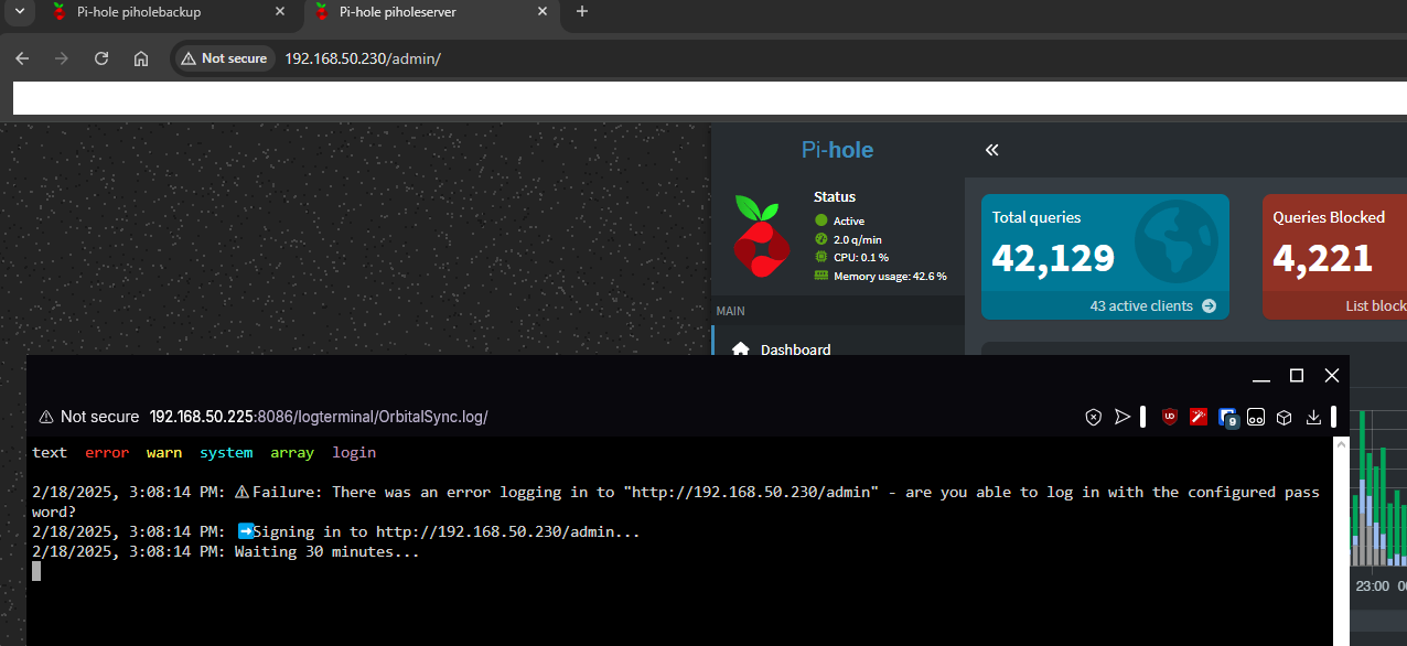

February 18, 20251 yr I recently updated both my piholes to v6. I have since not been able to get OrbitalSync to connect to my primary pihole. If its relevant, it somehow defaulted to port 8080 during the upgrade but I have since changed it to 80. In any case, per this screenshot you can see the address I am signed in to which I triple checked the password on as well and its showing the failure to connect:
February 27, 20251 yr Yeah this isn't working with v6 even with the right port... its just not signing in. is this still being maintained and will someone update it?
February 27, 20251 yr 14 hours ago, slikone27 said: Yeah this isn't working with v6 even with the right port... its just not signing in. is this still being maintained and will someone update it? The docker is not yet ready, not an unraid issue: https://github.com/mattwebbio/orbital-sync/issues/190
February 27, 20251 yr Author Yes this forum thread is just for support of the unraid package to install orbital sync orbital sync itself doesn’t support pihole v6 yet but looking at the GitHub ticket they are working on it
March 17, 20251 yr Author For those not checking the github issues - V6 support on orbital sync is in master - it's not released yet as they're missing a few features but they've announced it should be within a week or so
April 23, 20251 yr Author V6 UPDATE The author of Orbital-Sync has decided not to continue development. An alternative is available for pihole v6+ - nebula sync https://github.com/lovelaze/nebula-sync/ I have switched over and confirmed it works perfectly. If you're staying on V5 then this will continue to work, but for V6+ I'd suggest switching to nebula sync which is already available in the community apps
