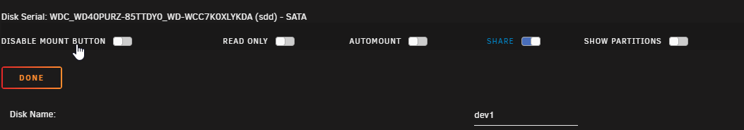

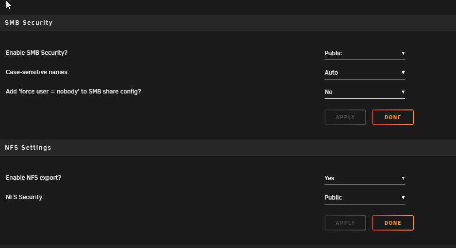

  2. Hi, i upgraded UD (noticed this AM) and then read through your above texts. I did the following to resolve the issue: went into settings of UD, change security from public to no for both SMB (apply), then NFS (apply) went to main menu option then went to both drive and mount and selected the gear and "disabled" share and pressed done went back into the gear for the drive and share was back enabled I clicked done again. I did the same for the mount. i then tested the through windows 10 and the mount is shared. I did the same thing yesterday, the only difference would be the upgraded UD. Thank you for your help.

  7. Maybe I am doing it wrong? this is what i have. these are screenshots from settings and from the mount point share with the drive share. I think blue is on?

  9. Recently upgraded to 6.11.5 and I noticed my smb share of my unassigned disk no longer works. The drive is mounted and I can copy files or create folders. I just can't access via smb or nfs. I have removed all plug-ins and added only CA and unassigned plug ins without improvement. verified that have allowed SMB sharing and allowed public access. I have tried to just access the drive even though it does not show up when using UNC \\servername\share . any suggestions?
