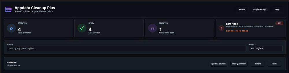

Appdata Cleanup Plus is an Unraid plugin for finding orphaned appdata folders left behind by removed Docker containers, then letting you review them safely before doing anything destructive.
This is the pre-CA-store release thread for testing, feedback, and support.
What it does
- Scans saved Docker templates and current container mappings
- Finds orphaned appdata paths that no longer match installed containers
- Shows folder size, last updated time, and why a path was flagged
- Lets you ignore paths you never want surfaced again
- Supports dry run before any real action
- Uses quarantine as the default real action
- Supports permanent delete only when explicitly enabled

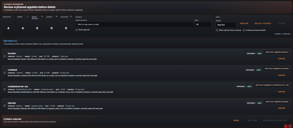

Appdata Cleanup Plus 2026.03.30.48
This main release rolls up everything that landed after the previous stable main release, 2026.03.27.24. The focus for this cycle was scan reliability, quarantine workflow depth, live result updates, and a long pass on compacting and cleaning up the Unraid Settings UI.
New Workflow Additions
- Added a dedicated Quarantine manager with tracked quarantine records, restore actions, and purge actions.
- Added popup audit history so cleanup, restore, and purge events can be reviewed without leaving the dashboard.
- Added an Action bar that surfaces quarantine and history access in one place.
- Added Show ignored handling so hidden paths can be surfaced and restored from the UI.
- Added live restore behavior so restored candidates can return to the detected list without waiting for a full manual rescan.

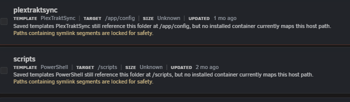

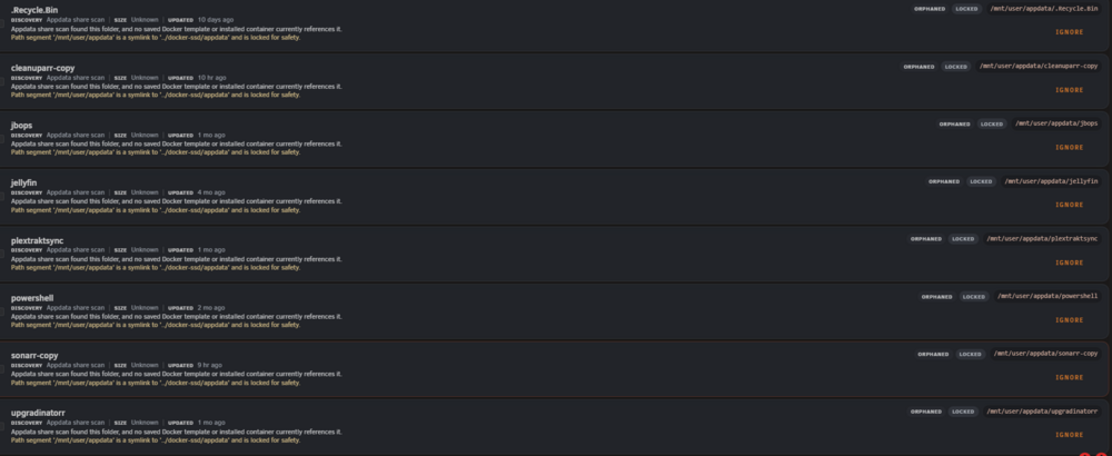

How do I figure out why these are blocked?
And there are also other, no longer used, appdata folders present that aren't even detected.
Edited by shiftylilbastrd
What version of the plugin and Unraid are you running?

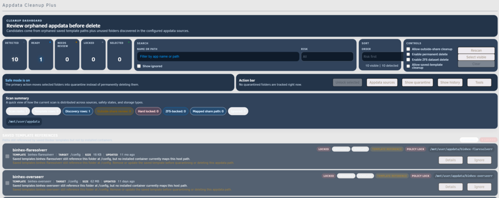

Appdata Cleanup Plus - Version: 2026.03.31.12- Feature / Fix / UI / UX Release
Since the last main release (2026.03.30.48), this stable build promotes the full 2026.03.31.01 through 2026.03.31.11 development cycle to main.
Scan and Detection
- Added direct filesystem discovery for orphaned child folders inside the configured appdata share, even when no saved Docker template still references them.
- Locked symlink candidates now show the exact offending symlink path segment instead of a generic safety warning. @shiftylilbastrd
- Host path matching is now canonicalized before comparing saved templates against live container mounts, so trailing slash differences no longer create false orphan rows.
- Added regression coverage for saved-template vs live-mount trailing slash mismatches.
Results UI / UX
- A single scan is now split into grouped sections for Saved template references, Appdata share discovery, and Ignored paths.

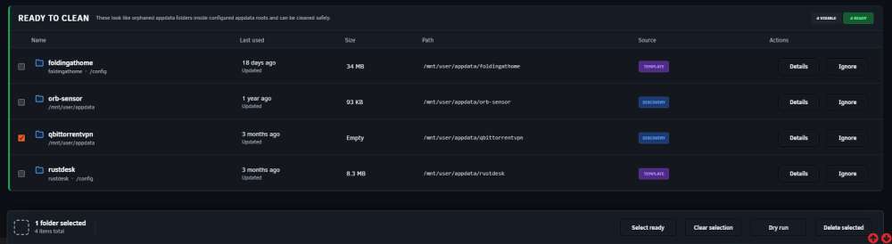

Bulk Actions
- Added Select all to the main bottom action bar so every deletable result can be selected in one click.
- Added quarantine entry checkboxes with bulk Restore selected and Purge selected actions.
- Added Select all to the quarantine manager toolbar for bulk restore and purge workflows.
Was on 2026.03.30.48 and 7.2.4
Just updated to 2026.03.31.18 all the ones that were missing before are now showing but still can't remove
Please test the latest version 2026.03.31.18 to see if your issue is resolved.
I did if you look at the rest of the post. The reason it says they're locked is because my Appdata share is symlinked to the disk named docker-ssd, of course it is, that the disk the share is on.
@shiftylilbastrd I didn't see the updated edit when I commented. I will review this issue and provide a fix.
This should be fixed in the latest stable release: 2026.04.01.02.
Two changes were made for this case:
- The plugin now allows the configured appdata share root itself to be symlinked without hard-locking every folder under it.
- .Recycle.Bin is now excluded from direct-child appdata discovery, so it should no longer show up as an orphaned appdata folder.
Important detail:
- This only relaxes the lock for the configured appdata root symlink itself.
- Direct folder symlinks and deeper nested symlink segments are still locked for safety.

- normal appdata folders under your symlinked appdata root are no longer all stuck as Locked
- .Recycle.Bin no longer appears in the scan

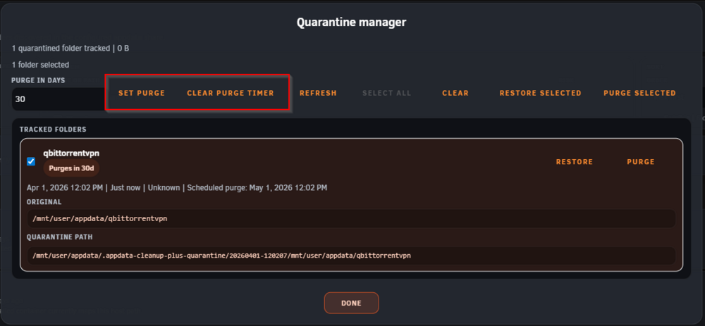

That addressed the issue but I have two comments.
  1. The done button at the bottom in my opinion is misplaced, I tried clicking that after selecting what I wanted cleaned just to be booted to the Settings page then have to go back in and try again. I get having the ability to exit the plugin but I think it should either be labeled Exit or moved elsewhere.
  2. There should be a settable duration that items are held in quarantine if that's going to be the default.
All good suggestions, I'll work on those as well. I should have a release for this tomorrow.
This should be addressed in the latest stable release: 2026.04.01.09.
Two changes went in for this:
- The bottom Done button was removed from the action bar entirely, so it should no longer kick you back to the Settings page by mistake while working through a cleanup.
- The quarantine manager now supports purge scheduling for quarantined items:
- select one or more quarantined entries
- set Purge in days
- clear the timer later if needed
- each scheduled item shows a visible purge badge and the scheduled purge time
Important detail:
- The current implementation is per selected quarantine entry, not a single global default retention setting.
- Due scheduled purges are cleaned up automatically the next time the quarantine state is loaded.
Can you update to 2026.04.01.09 and test again to confirm:
- the bottom action bar no longer has the old Done button
- quarantine items can be scheduled for purge successfully
- the scheduled purge badge/timestamp show correctly in the quarantine manager
Release: https://github.com/alexphillips-dev/Appdata-Cleanup-Plus/releases/tag/v2026.04.01.09
Running 2026.04.01.09 and those changes are good. I have a couple more if you're interested
Remove this
If you want to continue to include the mode notification just put it at the top right above the Controls block since that space is empty anyways.
Have quarantined items in a separate visible table like ignored items are and show their scheduled deletion timestamp, Place the history button at the bottom of that block
Clicking done doesn't save the change to purge days, have to hit enter of click out of box before hitting done to save.
Quarantine shows time added but not scheduled deletion time.
@shiftylilbastrd It shows you the time added in a badge and the scheduled purge below.
Also, you have to have an item selected for those buttons to be enabled.
