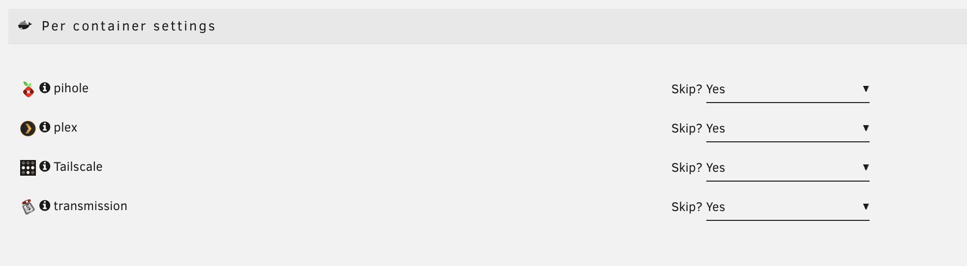

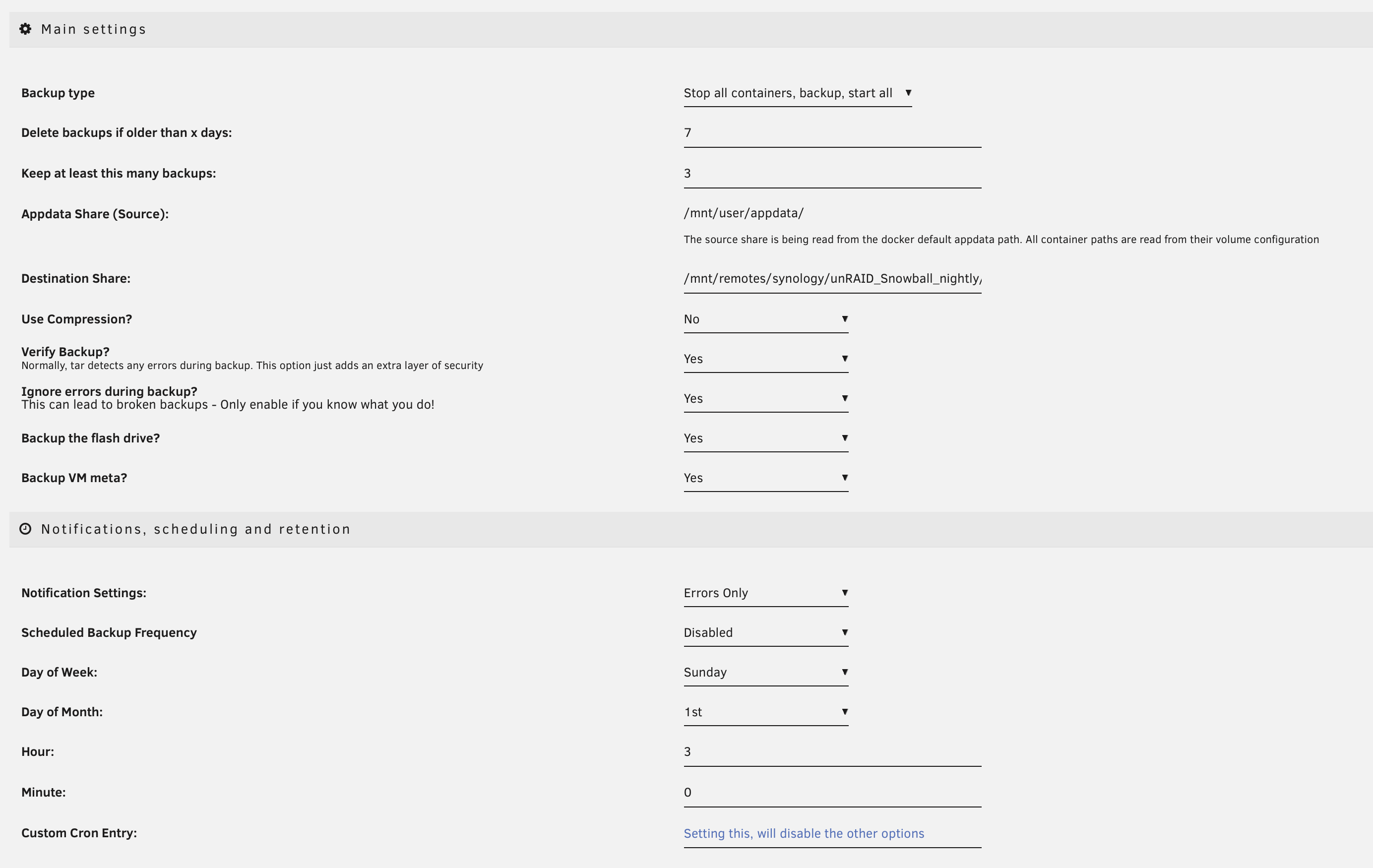

I just installed the beta version - when clicking the "Save" button under "Some Extra Settings" -> "Done?", the "Scheduled Backup Frequency" reverts to "Disabled" (I selected Daily) and also the "Skip?" defaults to "Yes" for each Docker container.
Cannot reproduce. Just installed it fresh again, just giving it a source and the daily option (and set one container to Verify: no) -> Saved, Page reloaded: My cronjob settings are as set. The per docker setting "Verify?" is still no, as set. Could you share your /boot/config/plugins/appdata.backup.beta/config.json file?

False. I found an issue regarding the defaults for containers. Please update and either remove the mentioned config.json and start again or set their values back to "Uwe default". The settings should no longer switch back to the real default values. Sorry!
But I still cant reproduce the schedule-resets-itself issue :/

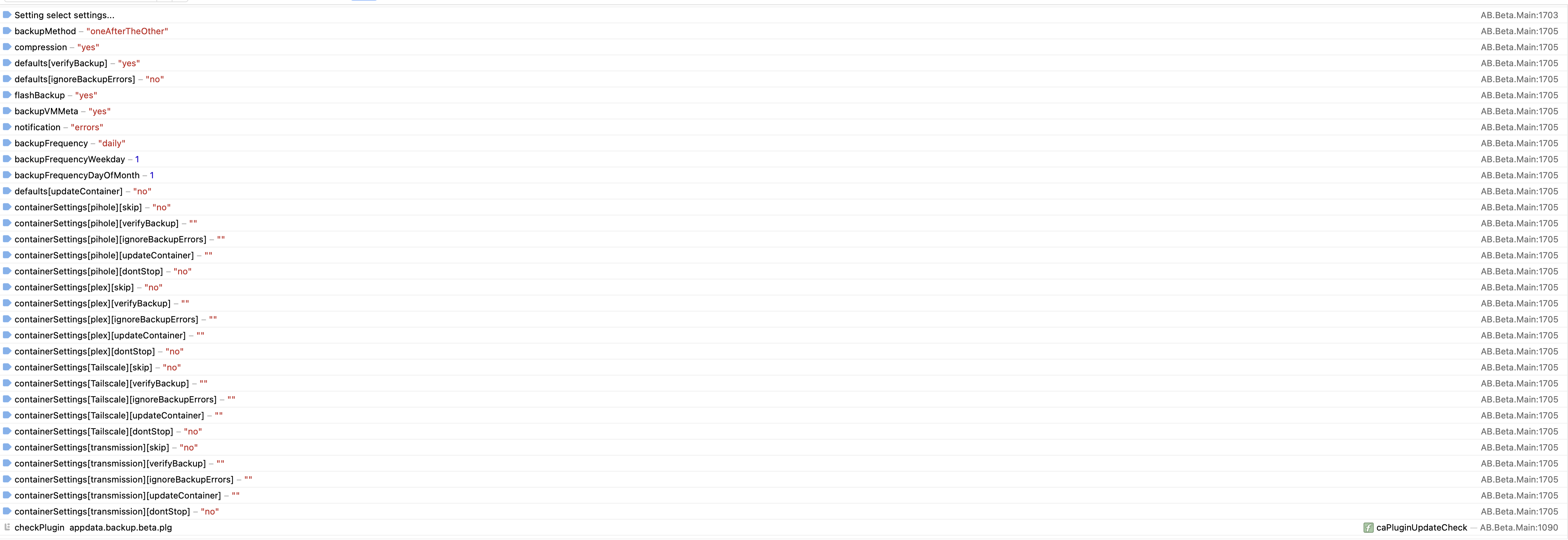

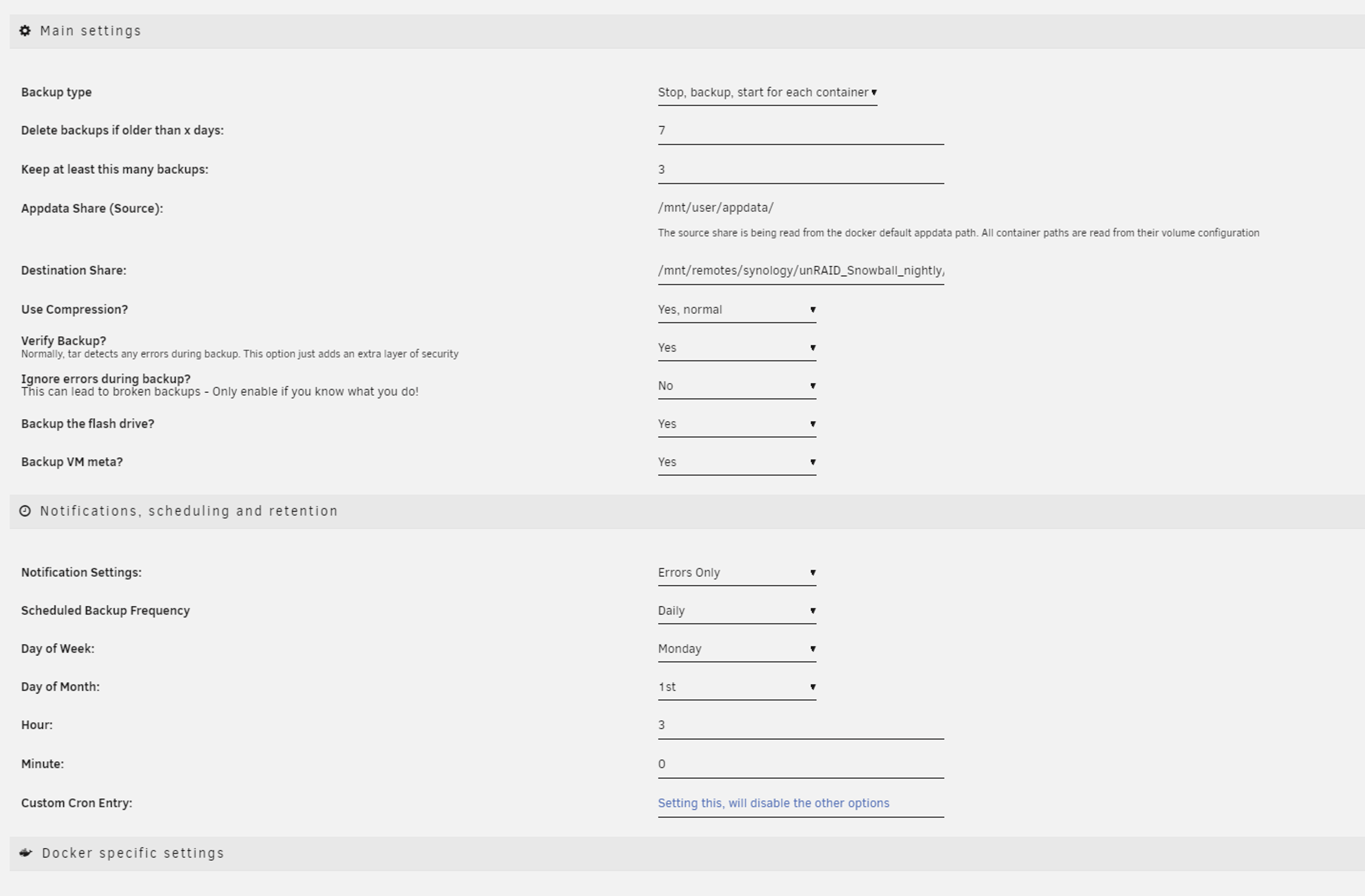

Nuked config.json, updated to Beta 2 and reconfigured.
Scheduling still looks bugged in the Web Interface but is saved properly to config.json

You can also see in the config.json I have "Skip" to "No" but yet the Web Interface says Yes
Thanks for your input ;)
Thats smells like an issue during apply settings back to their fields. Thats done via JavaScript.
I bet, if you press F12 (browsers dev console) you can see some red errors. Which broser are you using? Just tested with FF and Edge
Edited by KluthR

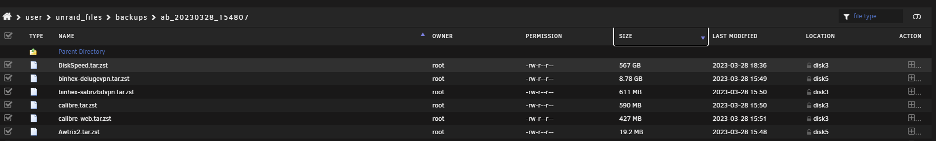

My appdata\binhex-delugevpn is 73 MB but I had to stop the backup process when the backed up archive grew over 200 GB. This also happened to several other Dockers.
Please find the debug attached.
ab.debug.log
Currently it does, yes. But I immediately see what that can cause.
I‘ll change that behavior and let the user decide how to handle mappings outside the appdata path.

@xaositekSafari should work well now as well ;)
Confirmed working now!

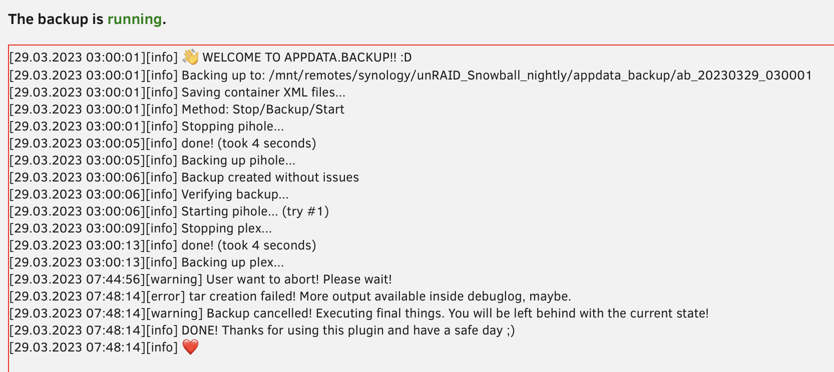

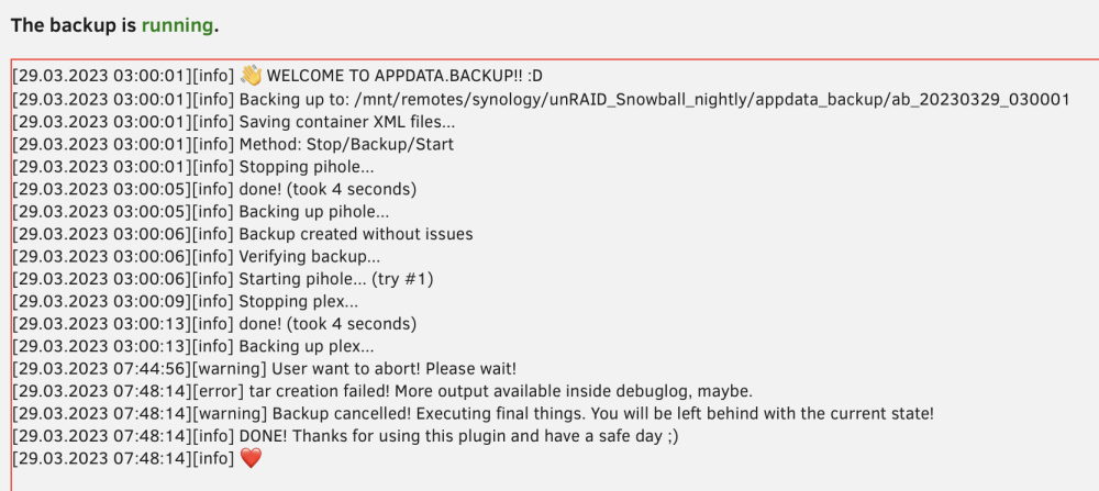

Found an interesting issue though - I clicked Abort but it appears the gzip stuck in the middle of running so I killed the gzip command at the CLI level. It's now stuck thinking the backup is in running mode; but it isn't as you can see on the screen.
Edit: it did finally recognize the backup had finished; I just jumped the gun.
