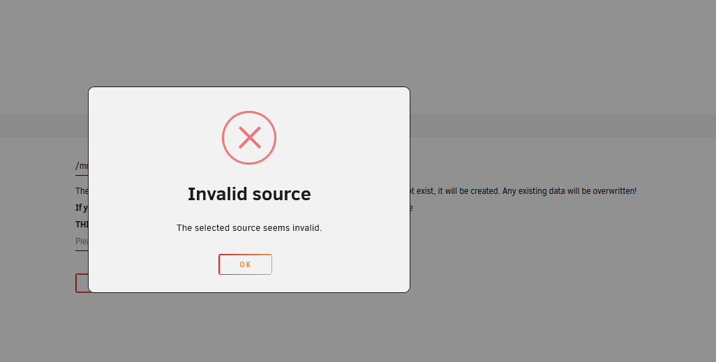

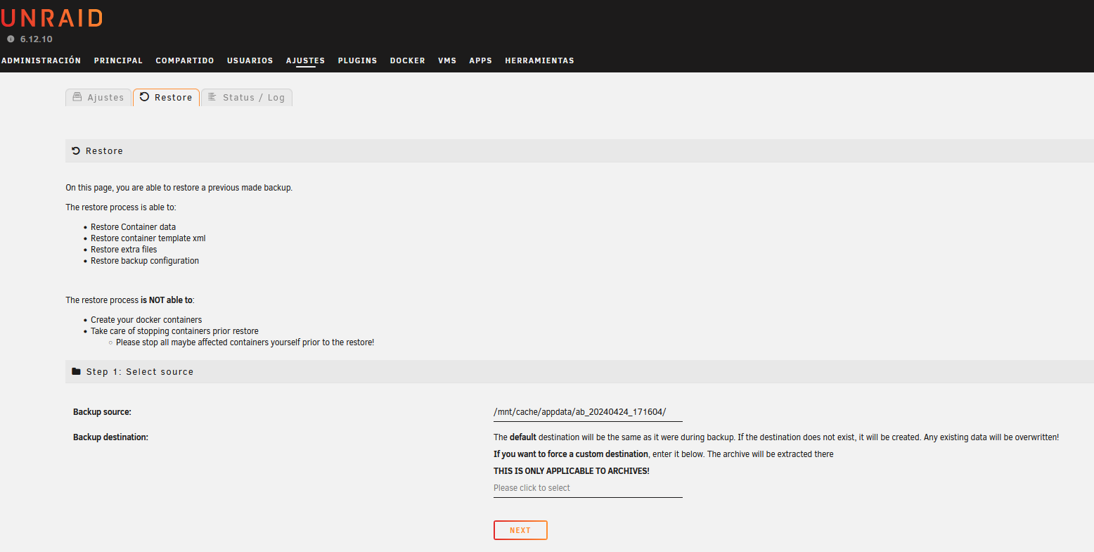

no idea why, what im doing wrong
What about posting some more details? At least the entered source???
no idea what is that, im new with this
1) You don't want to put your backup destination into the appdata share itself
2) Is that folder actually on the cache drive? What's your share configuration for the appdata share?

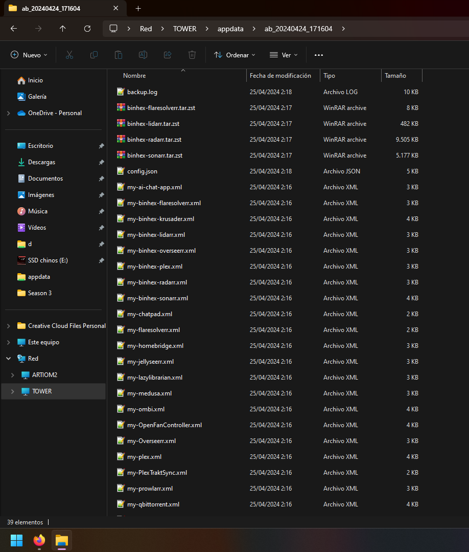

i maded a backup, and now i created a ¨cache¨ as main storage, and i want to restore everything, its because the restore folder its in appdata? i need to move it outside from there?
