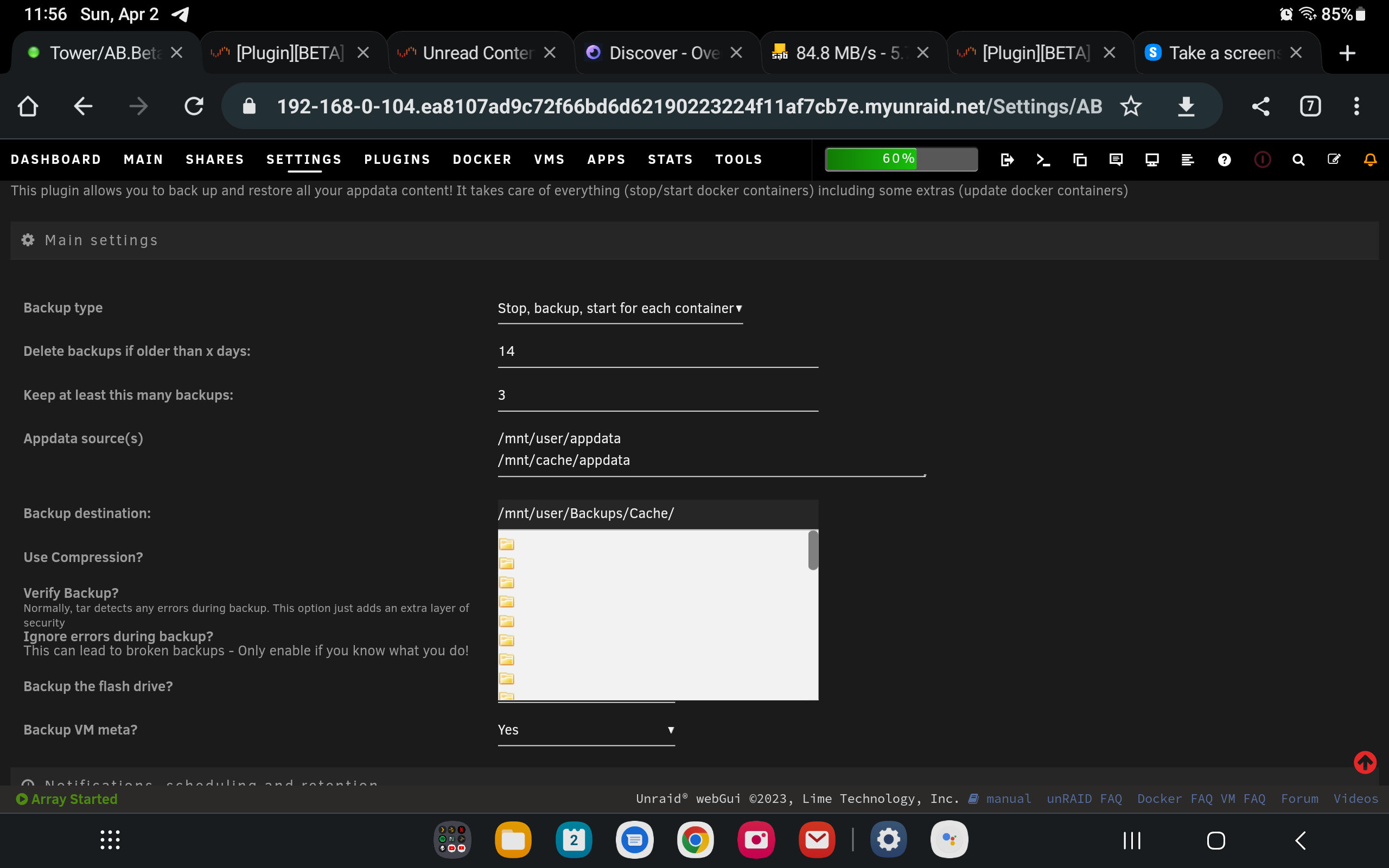

Actually the text is there it's yellow on white and can't be seen
Edited by MyKroFt
Hm, idk. The file browser is an unraid feature, I just enabled it for some fields. No change which could cause a malfunction or some color change. It did work before? Did you upgraded something else?
Weird I install the old one and they show up just fine
Here is what it's doing
Seems like an light/dark mode issue from unraid. I can try to work around it.

Here is edit in docker with no theme changes.  Thanks
Its fixed, please update to latest version.
