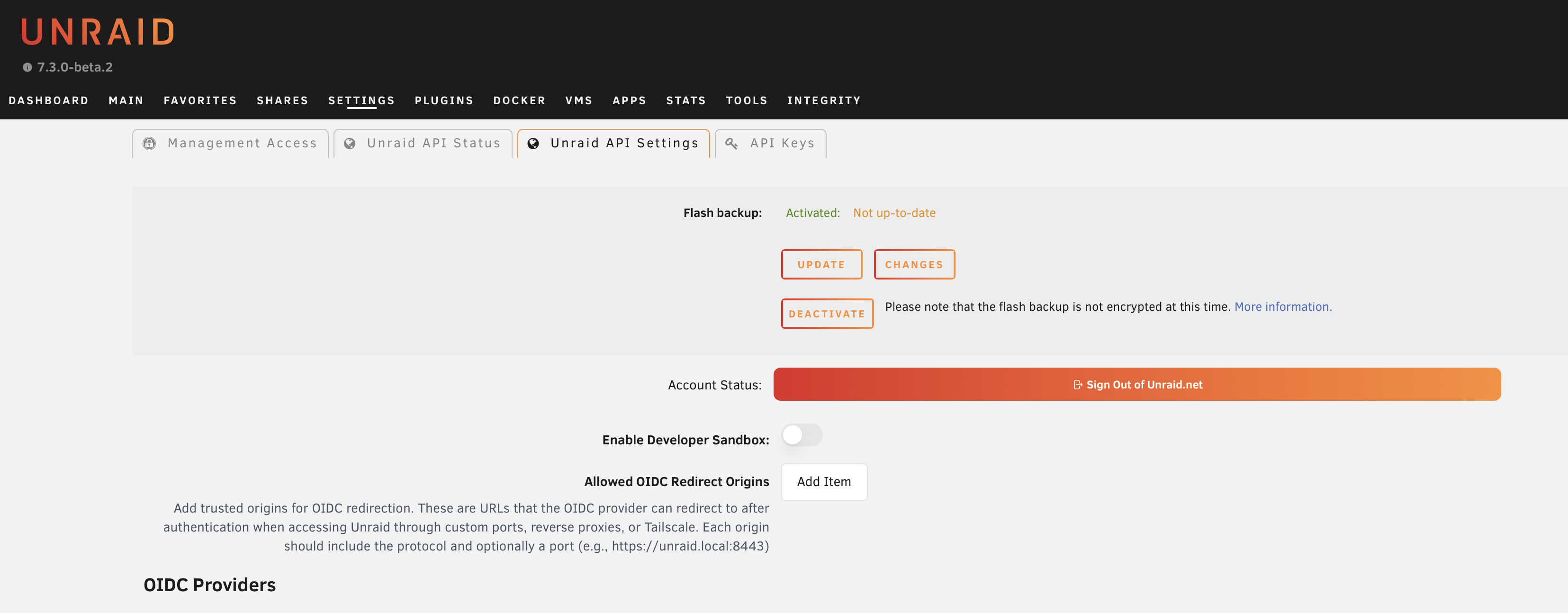

  1. Update - rebooting the server actually did fix it.
  2. root@PiperMobile:~# unraid-api plugins install unraid-api-plugin-connect Archiving node_modules from '/usr/local/unraid-api/node_modules' to '/boot/config/plugins/dynamix.my.servers/node_modules-for-v4.32.1.tar.xz' node_modules archive created successfully. Added plugin unraid-api-plugin-connect Restarting the Unraid API... [PM2] Applying action restartProcessId on app [unraid-api](ids: [ 0 ]) [PM2] [unraid-api](0) ✓ +--- unraid-api namespace : default version : 4.32.1+5c297da1 pid : 82734 pm2 id : 0 status : online mode : fork restarted : 1 uptime : 1s memory usage : 221.8mb error log : /var/log/graphql-api.log watching : no PID file : /var/log/.pm2/pids/unraid-api-0.pid

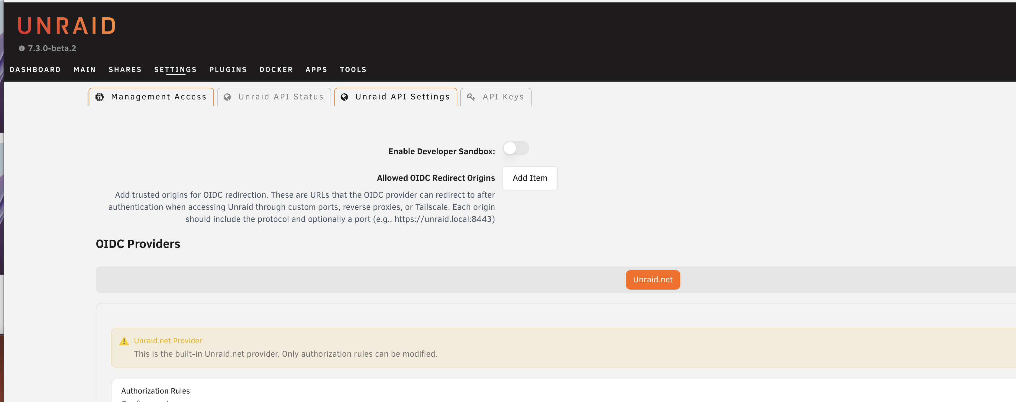

  3. On one of my unRAID 7.3 beta 2 servers I see this: Same screen on my other unRAID 7.3 beta 2 server I see this: I also notice the upper right corner one of them has the orange unRAID logo and more options and seems a bit more "connected". It used to work but trying to uninstall and re-install the unRAID Connect plug-in didn't fix it.
