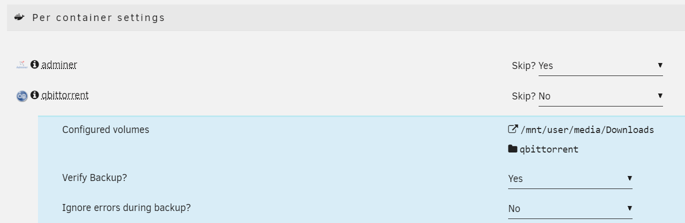

What is that little square with the arrow on the configured volumes? is that where I should be able to choose if I want to include the configured volumes or not? Ideally that would be a check box. But whatever it is, it doesn't do anything.
The square icon is part of a hidden setting. Volumes with those icon are „external“ volumes which can be optionally included soon.

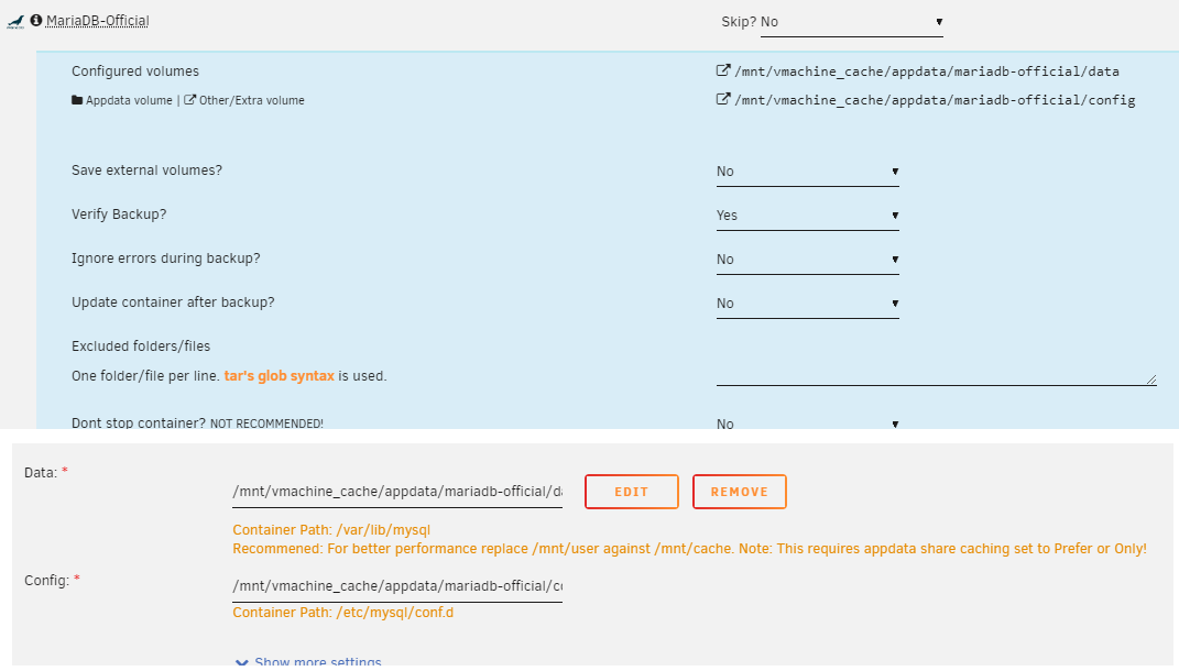

So if someone is using /mnt/cache instead of /mnt/user for example on mariaDB for performance reasons it does not consider that an "internal" volume it appears. Even if that's the path to the appdata.

You mentioned that it will pull the name from the container's app data path. Is there any chance that it's not considering volumes if they don't have the default name of  "cache" because it appears to still be considering these as "external volumes". Or probably because in the container this is not called 'app data' path its just called 'data'.
none of this would matter if it would just pull a list of all configured volumes and just have a check box beside each one for manual selection.

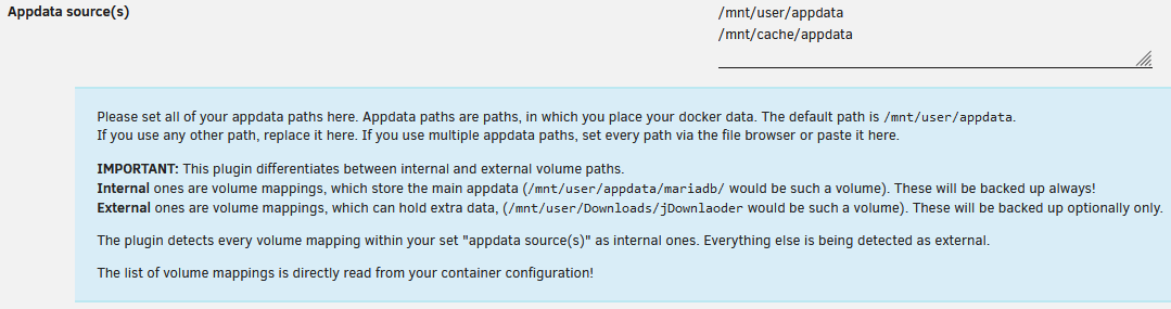

No, the plugin has a list of known appdata paths + the one configured in your docker setting:
I believe none of this is applicable? One could have multiple such volumes to store data which should be considered "internal" (sorry if the naming is a but ugly, dont had better idea).
What was your source config in the previous plugin?
Whats about configurable appdata source(s) which should consider always-to-backup data?

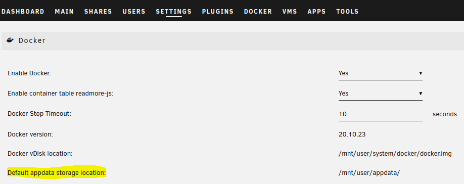

OK, this kind of works. If I change my "default appdata storage location" to my cache location /mnt/vmachine_cache/ as shown above in my screen shot from previous post, then it will resolve the issue where for mariaDB it considers those to now be 'internal' volumes.
For me this is ok (because cache is basically my default appdata location), but for other people their "default appdata storage location" might be /mnt/user and they only changed it manually for mariaDB (or similar) database performance. In that case their situation would be what I've shown in the screen shot in previous post, that is their 'default appdata storage location' = /mnt/data but in their mariaDB (or similar) container they are pointing manually to /mnt/any_name_cache/ and based on my experience that would be considered 'external volume'

A new options for allowed appdata paths would fix it. I dont would add a checkbox next to each volume, I believe thats no good practice.
