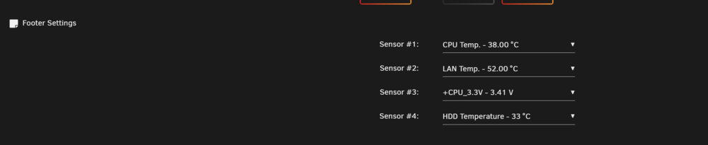

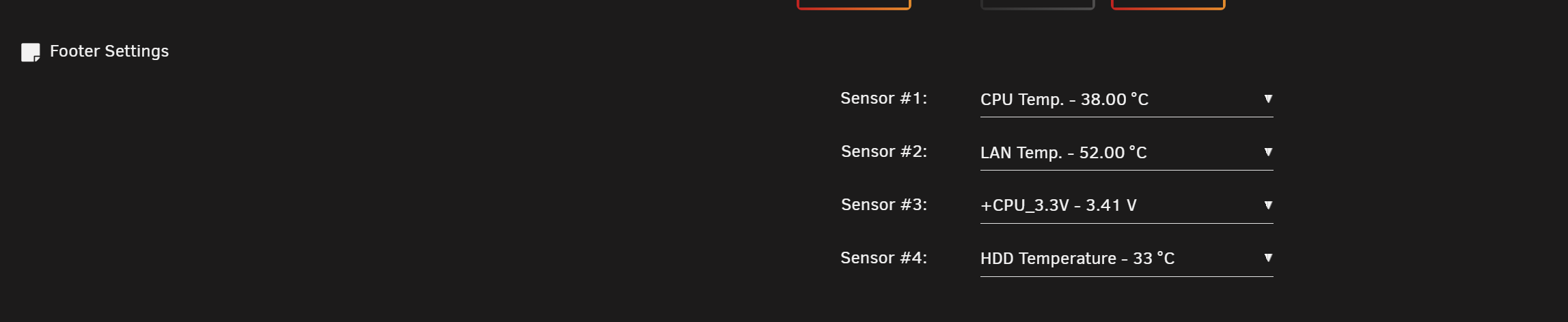

  17. This maybe a trivial question but, is there a way to add additional footer options? I would like to add all fan speeds in addition to what I already have, I am running 7RC1.

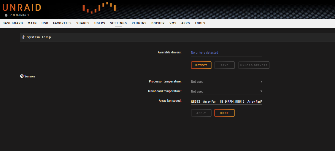

  18. Update: I rolled back, installed, and then upgraded. I installed 6.12.10 on another USB and works. On my current version, do you suggest I downgrade to load the driver and then upgrade again to beta/unRAID 7? I rather not unless that's what is recommended. Thanks
  19. Yes I have clicked on detect and here is the output: root@unRAID-Spare:~# sensors-detect bash: sensors-detect: command not found sensors: root@unRAID-Spare:~# sensors coretemp-isa-0000 Adapter: ISA adapter Package id 0: +70.0°C (high = +100.0°C, crit = +100.0°C) Core 0: +60.0°C (high = +100.0°C, crit = +100.0°C) Core 4: +64.0°C (high = +100.0°C, crit = +100.0°C) Core 8: +70.0°C (high = +100.0°C, crit = +100.0°C) Core 9: +70.0°C (high = +100.0°C, crit = +100.0°C) Core 10: +70.0°C (high = +100.0°C, crit = +100.0°C) Core 11: +70.0°C (high = +100.0°C, crit = +100.0°C) Core 12: +69.0°C (high = +100.0°C, crit = +100.0°C) Core 13: +69.0°C (high = +100.0°C, crit = +100.0°C) Core 14: +69.0°C (high = +100.0°C, crit = +100.0°C) Core 15: +69.0°C (high = +100.0°C, crit = +100.0°C) eth1-pci-5800 Adapter: PCI adapter PHY Temperature: +44.0°C MAC Temperature: +44.0°C nvme-pci-0100 Adapter: PCI adapter Composite: +45.9°C (low = -5.2°C, high = +79.8°C) (crit = +84.8°C) acpitz-acpi-0 Adapter: ACPI interface temp1: +27.8°C it8613-isa-0a30 Adapter: ISA adapter in0: 1.18 V (min = +0.92 V, max = +1.49 V) in1: 1.12 V (min = +2.73 V, max = +0.34 V) ALARM in2: 2.04 V (min = +2.77 V, max = +2.09 V) ALARM in4: 2.01 V (min = +2.64 V, max = +2.08 V) ALARM in5: 2.06 V (min = +2.04 V, max = +2.50 V) 3VSB: 3.30 V (min = +5.57 V, max = +3.59 V) ALARM Vbat: 2.75 V +3.3V: 3.34 V Array Fan: 1814 RPM (min = 0 RPM) Array Fan: 720 RPM (min = 0 RPM) Array Fan: 694 RPM (min = 0 RPM) temp1: +74.0°C (low = +62.0°C, high = -77.0°C) ALARM sensor = Intel PECI temp2: +32.0°C (low = -8.0°C, high = -70.0°C) ALARM sensor = thermal diode temp3: -128.0°C (low = -102.0°C, high = +33.0°C) intrusion0: ALARM eth0-pci-5900 Adapter: PCI adapter PHY Temperature: +57.0°C MAC Temperature: +57.0°C nvme-pci-5700 Adapter: PCI adapter Composite: +40.9°C (low = -273.1°C, high = +81.8°C) (crit = +84.8°C) Sensor 1: +40.9°C (low = -273.1°C, high = +65261.8°C) Sensor 2: +44.9°C (low = -273.1°C, high = +65261.8°C) nvme-pci-5600 Adapter: PCI adapter Composite: +45.9°C (low = -5.2°C, high = +83.8°C) (crit = +87.8°C) Thanks
  20. No, downloaded driver just fine, just no drivers detected, see attached.
  21. Having same issue, had ITE working w/ unRAID7, which was an upgrade and in the process of troubleshooting I uninstalled, rebooted, and installed, now the driver does not detect any drivers. Attached diag. Thanks unraid-spare-diagnostics-20240701-1533.zip
