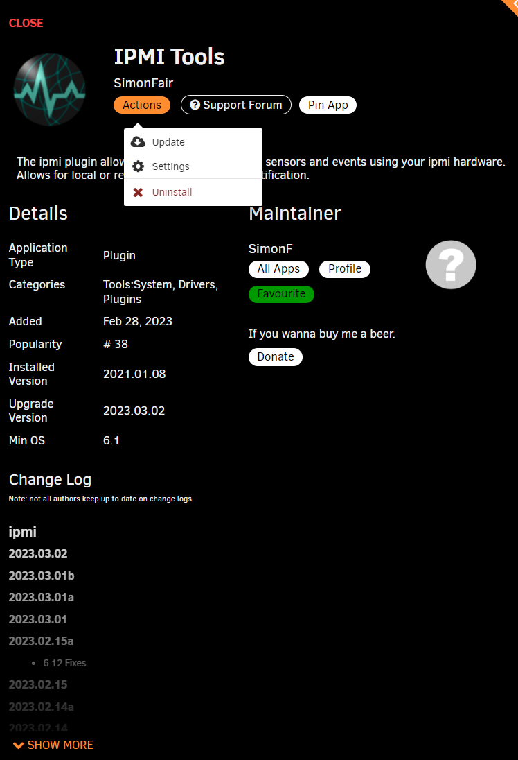

For switching from the now deprecated version, how exactly do we migrate over to it?
If you click info on my IPMI entry in CA you should see this and click action to update.
Thanks. It shows as if both versions are installed though, but only lists the old one in the plugins tab. It seems to work okay though.
I replaced the old addon but yours Simon.

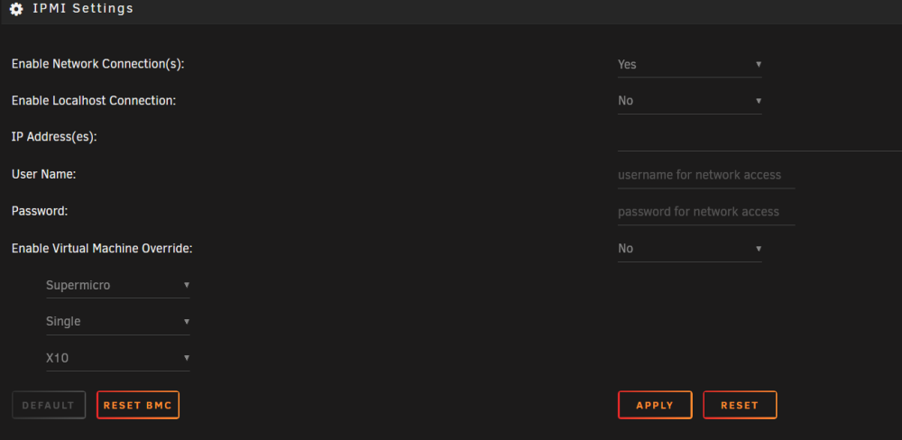

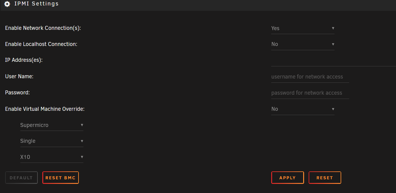

I have one issue though. I can't seem to enable the Network connection as it was before.
When I select Yes,
the fields are greyed out and not active (the MB is properly detected).
When I try to apply, I get back to the 'No' setting and never have the possibility to enter the IP address, login and password.

Do you have either of these enabled.
Enable monitoring of IPMI sensors and events through the network. Notifications and Fan Control must be stopped to change settings
Ok, disabling both allowed me access to the greyed out fields. I cannot connect for some reason though.
Anyway, it's not super important for me, I am really using the plugin for the fan control and that works without being connected.
I didn't see an "Update" option under actions for the new plugin, only "Settings" and "Uninstall". Same for the old plugin. Uninstalled the old plugin and then installed the new one. Everything seems to be functioning correctly. Fans stayed steady and all sensors are showing. SuperMicro X10 SLL-F

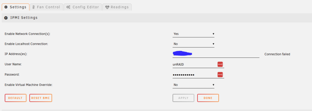

I really loved this plugin. I had a X8 motherboard with limited IPMI controls but it could read sensors very well.  I just recently upgraded my motherboard/cpu to a H12 series but it picked right up when I had the same username/password as the old controller.
Everything was working under the older plugin.  I saw the notice about migrating to the newer version and upgraded immediately had the IPMI account locked.  I retyped the password and it worked for a brief second then locked the account out again.
I have tried creating another user to specifically assign to unRAID.  That also is locked out immediately.
There are no retry setting or notifications from within unRAID IPMI plugin settings aside from "Connection Failed"
It appears to be hammering the login credentials and ignoring the custom password.
I have turned off the Notifications and Fan Control, defaulted the settings and tried to start fresh.  All with the same results.  Please let me know if I can provide any other information.  Thank you for this wonderful plugin and I hope to get it working again soon.
This should be fixed in release 2023.03.10 please test.

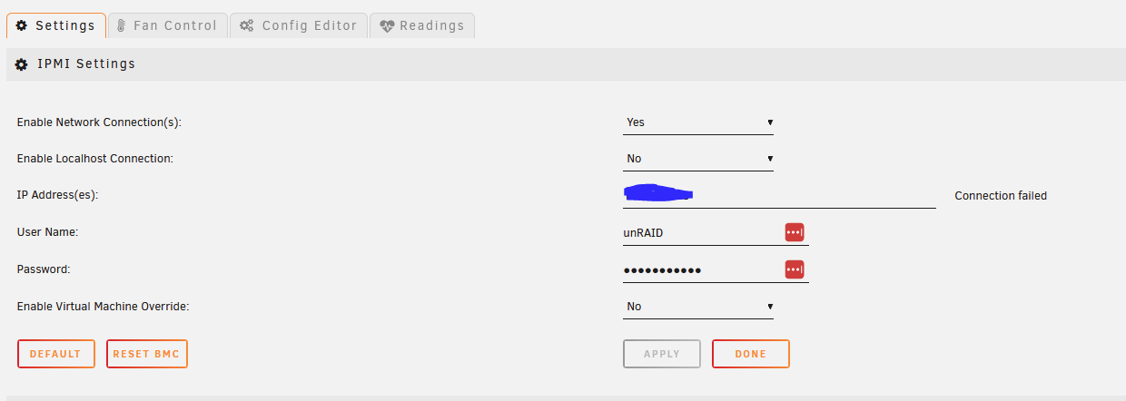

@SimonF
Just installed your latest plugin.  It seems to run as "anonymous" just fine and read stats but now is immediately rejecting my "unRAID" user account for BMC.
The unRAID log doesn't show any activity.  Is there a log that I can help parse and provide to you?
The BMC log doesn't show any activity from user "unRAID" attempting to log in.
Thank you again! I am more than happy to help you test this in any way I can.

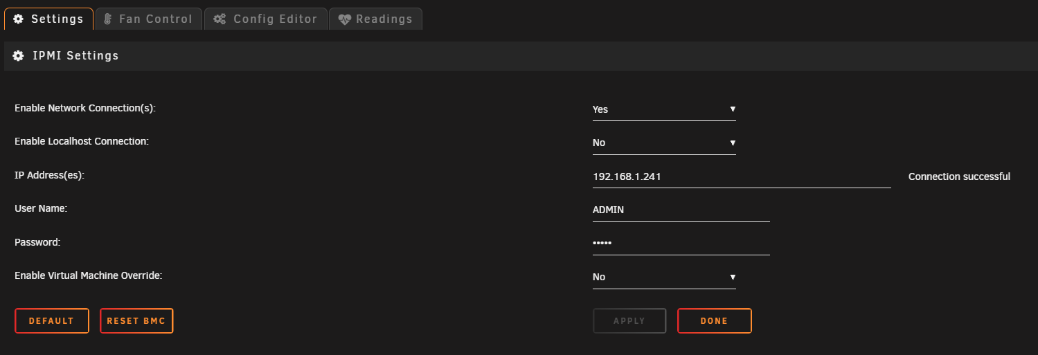

Are you able to post some screen prints, also which options are you looking at? Have you re-entered the user and password?
Do you get connection successful? Also on the readings tab should show the IP address.
