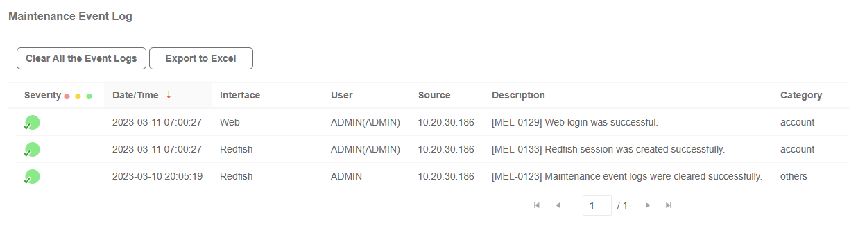

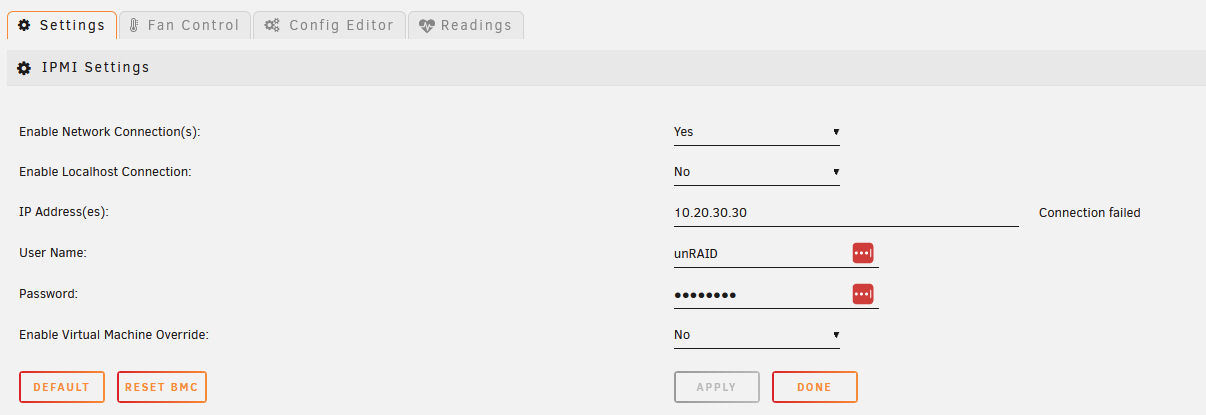

The Readings tab shows blank.  Even after reboot.  I have also used the Default and Reset BMC and re-entered credentials.  I just uninstalled the plugin and installed fresh but it doesn't seem to communicate over network.
BMC Log not showing any events of attempted sign in from user unRAID
Can you try replace IP, User and password as required.
/usr/sbin/ipmi-sensors --output-sensor-thresholds --comma-separated-output --output-sensor-state --no-header-output --interpret-oem-data --always-prefix -h "192.168.1.240" -u "ADMIN" -p "ADMIN"
I dont need to see the value of the decode but can you confirm if you take the password value from the config file and replace $PASSWORD does it give you the the correct password for the BMC?
cat /boot/config/plugins/ipmi/ipmi.cfg | grep PASSWORD will show the encoded password. Only put the text between quotes into line below.
echo $PASSWORD | base64 --decode
@SimonF
I have it working now! Thank you for helping troubleshoot this.
So this command works under user "ADMIN" but did not work under my custom user account that I created  "unRAID"
Even though I was able to log in to the BMC manually with the "unRAID" user it was not recognizing via the command either.  I just deleted the user from BMC and re-added with the same credentials.  Now it is letting me in and your command works with the re-created user "unRAID".
It is also working from within the GUI Config and now reading properly.  I apologize for not trying this before but my validation was that I could manually log in with those credentials that should mean that the IPMI plugin should be able to as well.
Thank you again for your insight.  Side note, this is an H12 motherboard using the X11 settings.  As far as I am aware, the BMC is unchanged between the X/H11 and X/H12 boards.
Edited by ephdisk

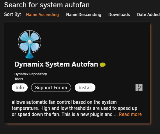

Sorry for what might be a silly question.
I wanted to investigate software control of my PWM fans connected to motherboard headers so I could tie the fans to HDD temps etc.
My motherboard is Asrock Z790 - https://www.asrock.com/MB/Intel/Z790 Pro RS WiFi/index.asp
I have a feeling I can't use the plugin?  At least on first try I wasn't able to get it to see any of the fans.
Thanks
Thanks
You motherboard needs to support IMPI for this plugin to work.
This may be better for you
I didn't have any luck with that plugin, at-least initially.  It's a bit tricky with dynamix megathread for all the plugins it's hard to find information.
