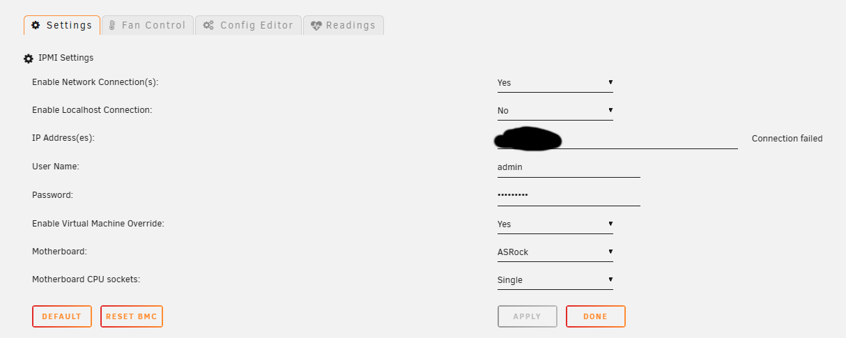

Hey SimonF. I love this plugin. But I met some troubles now. Would you please have a look and try to help?
I changed my motherboard from Supermicro X11 to Tyan S8030. Then my IPMI setting was broken.
I can't replace the IP address even the user and password. The button"RESET BMC" is useless for me.

Currently the plugin Supports Supermicros/ASUS and Dell partially.
What does dmidecode -t 2 | grep 'Manufacturer' | awk -F 'r:' '{print $2}' | awk  '{print $1}' provide as a result.
I am looking at additional requirements for Dell as I have to some hardware to test with.
Are you just looking for readings and/or fan control? The later would be a long term fix.
YES I only look for the temperature and fans. And now my request is just for this.
The result is "Tyan".  I tried to use the plugin at a new UNRAID server. Fortunately it worked.

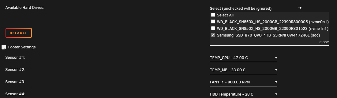

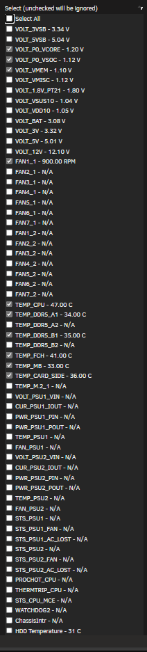

@SimonF would it be possible to get the ASUSTeK Pro WS W680-ACE IPMI board supported? I'm looking at the code on github and I'm not quite sure where to start to get it implemented. How do you obtain all these raw values...if that's even the first step?
Is there a way to provide our own fan.cfg setup and have the plugin go off that? I see there's an override setting for the Fan tab but I can't get it to detect any fans correctly after that.
Edited by JimmyGerms
Values come from here.

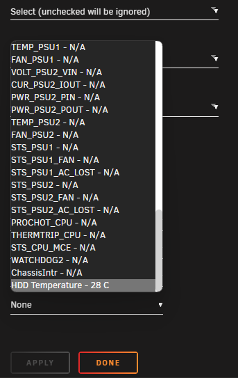

I might have found a bug in the plugin.
I have 3 x HDDs in total ( 1 x SSD and 2 x NVME)
The plugin settings only shows 1 HDD Temperature that I am able to select to add to the footer/dashboard, I expect to select 3?
Edited by mikeyosm
The HDD value is calculated based om the highest drive temp of all drives.
Oh I see. Is it possible to show more than one drive?
Not with the current version.
@SimonF I am getting connection failed with my Asrock Rack x570D5U mobo. I am running UNRAID inside a VM and wanting to display my Asrock IPMI stats in the dashboard. What am I doing wrong?
