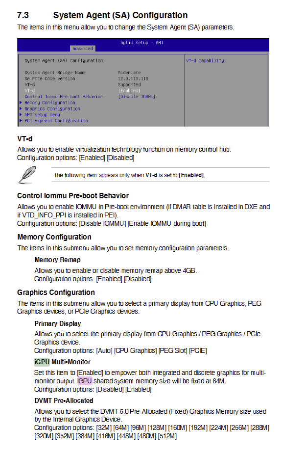

  17. Hey there! I'm about to pull the trigger on this board and came across this. Before I buy I'm going to watch this thread. Have you tried changing the Graphics Configuration settings in the BIOS? Looks like there is a toggle for iGPU Multi-Monitor support. Wonder if that will help resolve the issue? Seems like this individual had some iGPU issues as well: https://old.reddit.com/r/unRAID/comments/10r98b9/new_intel_build_advice_w680_z690_z790/j9u65sd/

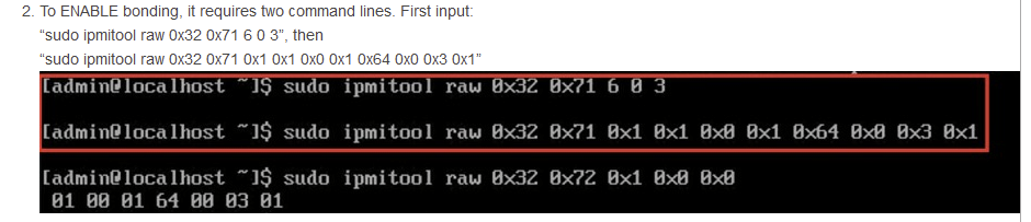

  18. Not to steal your thunder @Hoopster but I got curious and googled what you were talking about. I didn't know about the ipmitool kit! Is this what you followed? https://www.asrockrack.com/support/faq.asp?id=57 EDIT: Through googling, I found an old post of Hoopster's that ipmitools can be installed with the NerdTools. That should get you up and running hopefully?

  21. Just a heads up, I had to disable the bonding in IPMI due to my unifi switch getting confused. My local IPMI address would become unavailable due to the link aggregation and bond. Seems to be ok once disabled...and I turned off DNS just to see what would happen. Everything seems fine after a week!
  22. Oh my gosh, I just realized in my IPMI console they are bonded...would this be an issue if I have aggregation enabled through unraid?
