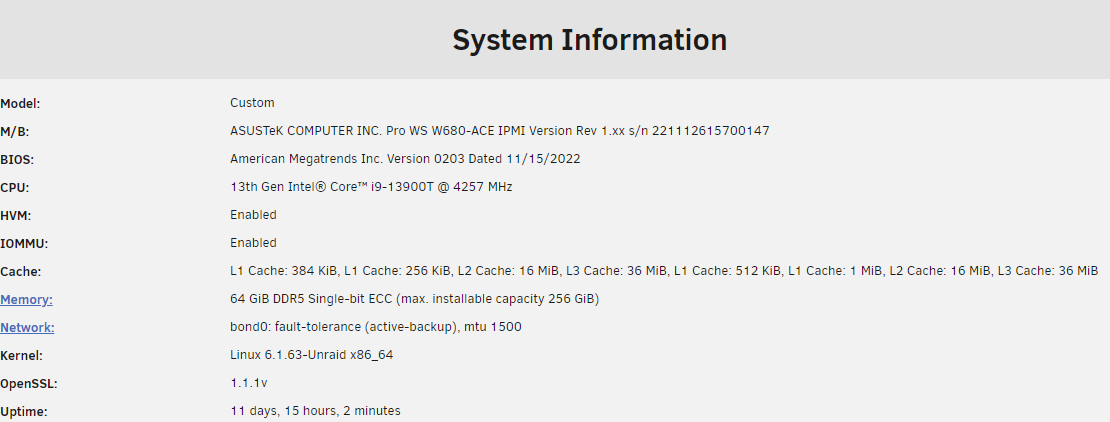

UnRAID on Asus Pro WS W680-ACE IPMI
I have 63W (at 7% with a T-series i9 CPU) but then I run two enterprise SSD for cache (U.2 NVMe), 3xPCIe sticks (idle at this point) and 4x20TB WD Enterprise HDDs (powered down right now). No GPU as I rely on the one in the CPU for my plex needs.
