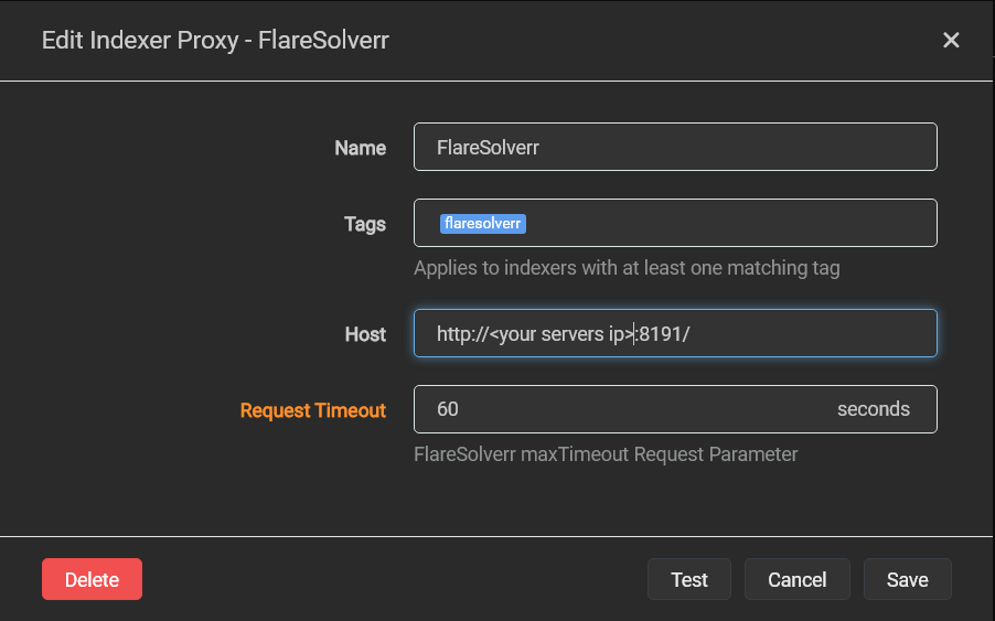

i am using this myself, an example setup defined in prowlarr:-
once defined here you then add 'tags' to each index site which then links it to flaresolverr.
For completeness here is what the Jackett configuration looks like for Flaresolverr, just go to Jackett WebUI scroll down to 'Jackett Configuration' and configure the URL for Flaresolverr, e.g.:-

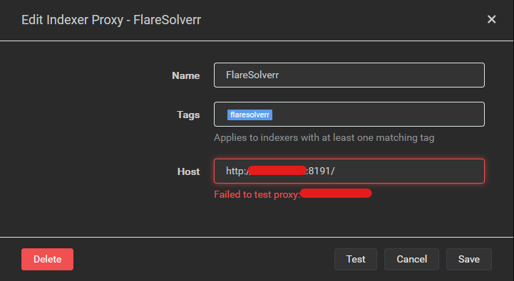

And I got the following error from prowlarr when clicking to 'test':
1 minute ago, IMACRAB said:
Thanks for coming back to me on this!
That's very odd, because that is exactly what I did.
I did not change anything throughout the installation of FlareSolverr either.
are you sharing networkkng with another container, for example vpn container? if you are and you are using one of my images then you will need to define the port in/out (depeds on setup).
What would be a good way to figure that out?
I'm currently using mostly images made by you.
do this:-
Left click the prowlarr container and select 'Edit', make any change to a value, then switch it back to what it was and click on 'Apply', then copy and paste the 'Command execution' shown to a file, ensuring to remove any reference to username and password, then attach the file here.
On 3/5/2024 at 4:17 PM, binhex said:
do this:-
