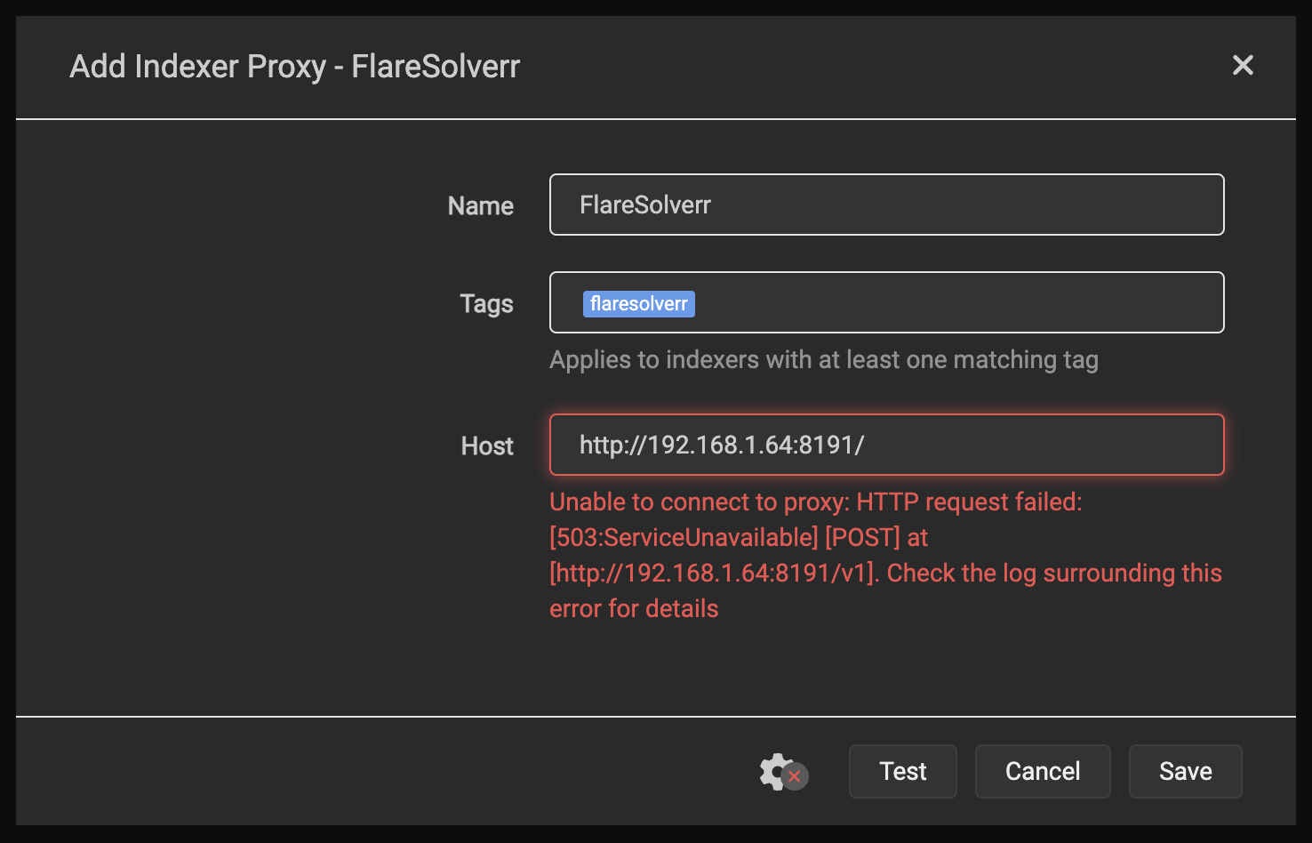

Went to setup flaresolverr for prowlarr. Received this error and log section. Seems like a straight forward install. Double checked everything input correctly. Removed and reinstalled. The rest of the 'arr' suite is up and running great, just having issues here. Any ideas?
2024-12-13 14:30:57.7|Warn|ProwlarrErrorPipeline|Invalid request Validation failed:
 -- Host: Unable to connect to proxy: HTTP request failed: [503:ServiceUnavailable] [POST] at [http://192.168.1.64:8191/v1]. Check the log surrounding this error for details
2024-12-13 14:30:57.7|Debug|Api|[POST] /api/v1/indexerProxy/test: 400.BadRequest (30116 ms)
2024-12-13 14:31:04.0|Debug|Prowlarr.Http.Authentication.ApiKeyAuthenticationHandler|AuthenticationScheme: API was successfully authenticated.
2024-12-13 14:31:04.0|Debug|FlareSolverr|Cloudflare Detected, Applying FlareSolverr Proxy FlareSolverr to request https://prowlarr.servarr.com/v1/ping
2024-12-13 14:31:34.0|Warn|HttpClient|HTTP Error - Res: HTTP/1.1 [POST] http://192.168.1.64:8191/v1: 503.ServiceUnavailable (6571 bytes)
2024-12-13 14:31:34.0|Error|FlareSolverr|Proxy validation failed
[v1.27.0.4852] NzbDrone.Common.Http.HttpException: HTTP request failed: [503:ServiceUnavailable] [POST] at [http://192.168.1.64:8191/v1]
   at NzbDrone.Common.Http.HttpClient.ExecuteAsync(HttpRequest request) in ./Prowlarr.Common/Http/HttpClient.cs:line 128
   at NzbDrone.Common.Http.HttpClient.Execute(HttpRequest request) in ./Prowlarr.Common/Http/HttpClient.cs:line 137
   at NzbDrone.Core.IndexerProxies.FlareSolverr.FlareSolverr.Test() in ./Prowlarr.Core/IndexerProxies/FlareSolverr/FlareSolverr.cs:line 189
<!DOCTYPE HTML PUBLIC "-//W3C//DTD HTML 4.01//EN" "http://www.w3.org/TR/html4/strict.dtd">
<html>
Flaresolver logs show this.
2024-12-13 14:28:38,025 DEBG 'flaresolverr' stdout output:
2024-12-13 14:28:38 INFO     Test successful!
2024-12-13 14:28:38,030 DEBG 'flaresolverr' stdout output:
2024-12-13 14:28:38 INFO     Serving on http://0.0.0.0:8191

From Byparr console when traffic is routed through the qBittorrentVPN container, getting the Prowlarr test page utilizing the curl command takes only a few seconds. So, VPN is working but maybe there is something similarly wrong for both FlareSolverr and Byparr. @binhex, any ideas on this?
2 hours ago, EVERGREEN said:
What are you using as Proxy? or am I missing something?
I'm personally sharing the network of privoxyvpn with byparr, but you don't have to do this if you don't want, as long as prowlarr/jackett are on the same network as byparr then you should be good.
Thanks for the response, I’ll giver a go!
So, is there a trick to do to make the privoxyvpn network work with Byparr? I have set the VPN_INPUT_PORTS and Prowlarr can connect Byparr. But for some reason it takes a very long time to solve / retrieve the Prowlarr test page as I wrote.
