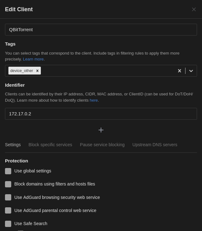

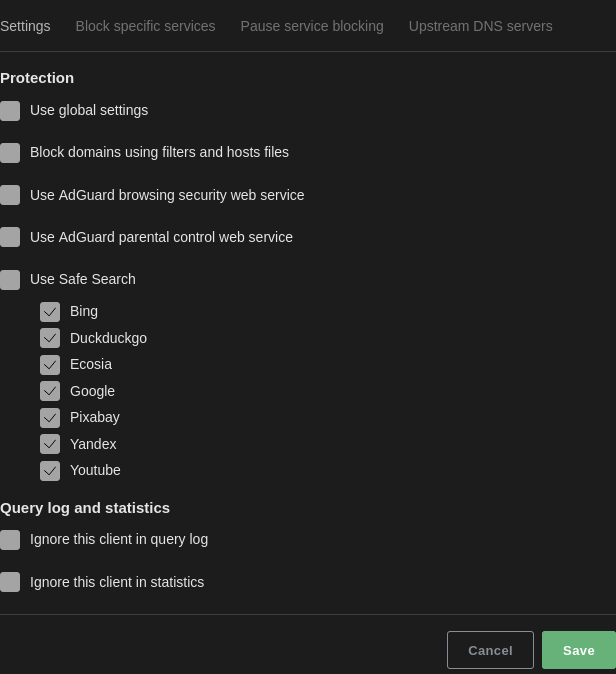

  4. Would you have an idea how to pull that off? I was able to find out where to get the IP address to be "172.17.0.2". But now I'm not sure where to go with it in AdGuard Home. Whitelisting doesn't seem very straight forward there... I tried setting it up as a 'Client' and deselected global settings, but it didn't change anything. Would there be another way, or am I using the wrong IP?

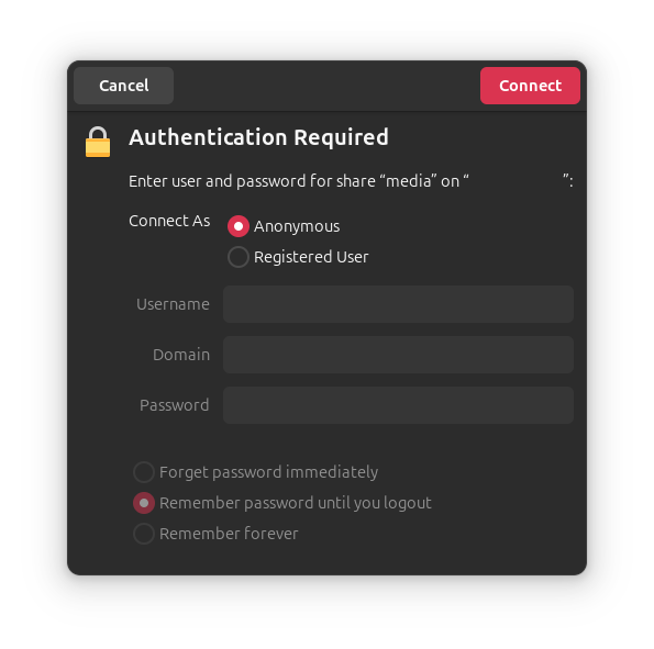

  8. Thanks both of you for the quick and elaborate answers! I always deleted the 'Domain' aspect which automatically greyed-out the connect button. Leaving WORKGROUP set and resetting the password to be sure it's the correct one worked in the end. Much appreciated.
  9. Hello there, I was trying to open shared drives from my server on an Ubuntu laptop. While the folders do show up, I'm not quite sure what to enter in the displayed fields: Username Domain Password Username usually has my laptop username prewritten whereas Domain comes with 'WORKGROUP' prefilled. Those prefilled credentials do not work however. While I did try it with the users I have created on my server, it seems that I'm missing (at least) the 'Domain' information. Does anyone know where I could find that information? I'd be happy to be able to access the shared folders from my laptop as well. Thank you!

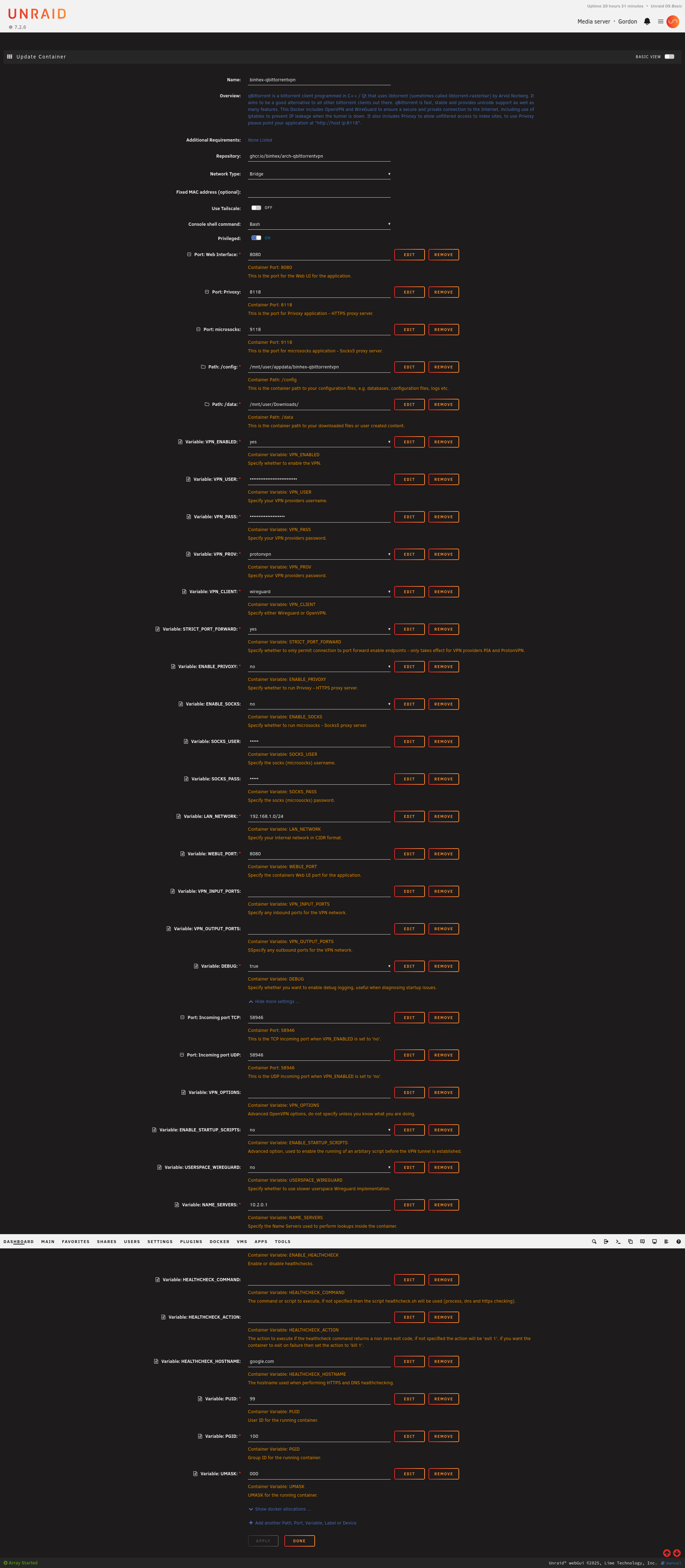

  13. Thanks for the tip. Is it this one? docker run -d --name='binhex-prowlarr' --net='bridge' -e TZ="Europe/Paris" -e HOST_OS="Unraid" -e HOST_HOSTNAME="Gordon" -e HOST_CONTAINERNAME="binhex-prowlarr" -e 'UMASK'='000' -e 'PUID'='99' -e 'PGID'='100' -l net.unraid.docker.managed=dockerman -l net.unraid.docker.webui='http://[IP]:[PORT:9696]/' -l net.unraid.docker.icon='https://raw.githubusercontent.com/binhex/docker-templates/master/binhex/images/prowlarr-icon.png' -p '9696:9696/tcp' -v '/mnt/user/appdata/binhex-prowlarr':'/config':'rw' 'binhex/arch-prowlarr' e55bf9753161d07da6aeb272004338a0f3b9fea8b369d53840417411057cf307 The command finished successfully!
