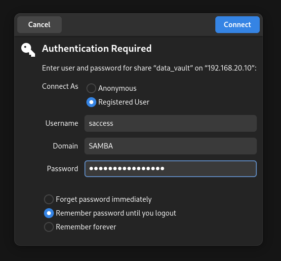

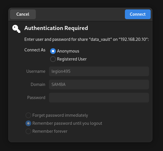

As a matter of fact I am actually in an identical situation on Fedora with Nautilus (Filemanager). Just wanted to provide "pictures"

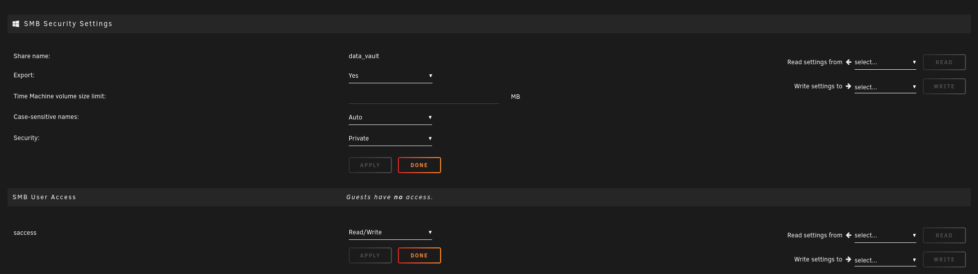

Trying to connect to my smb://192.168.20.10/data_vault I have to login as I set the SMB permissions as such:
image.png.e42036d5e1de363e49d4cc5e450335c5.pngimage.png.463ee2bc73bcce1e3f1b148e4c3438e7.png

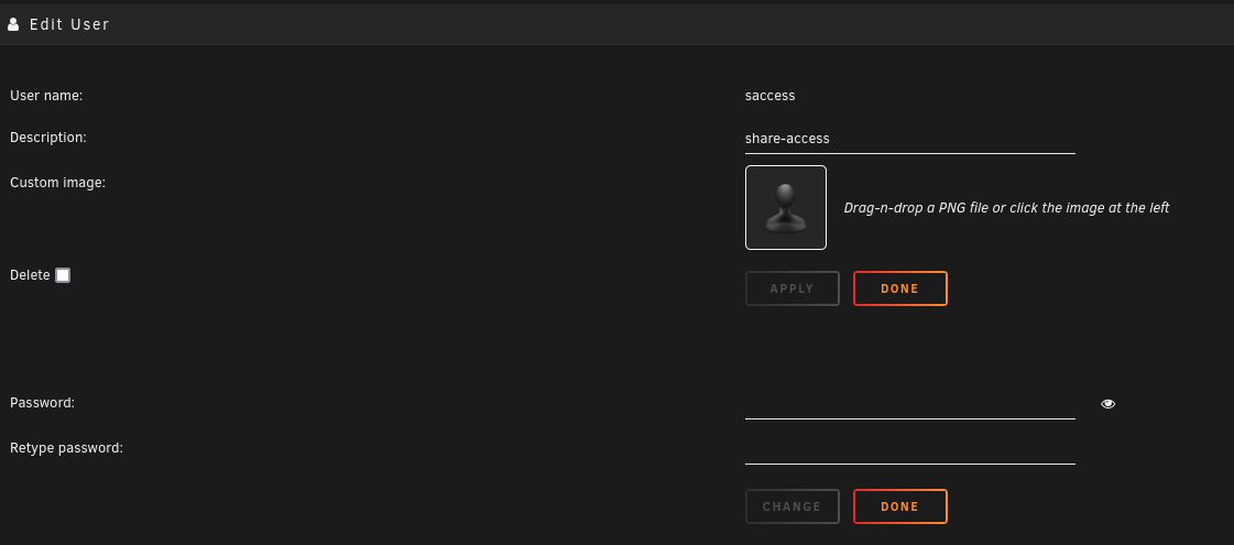

If I enter credentials and connect it just returns me to the login form again as it was first. This only happens if the Username/PW do not match.
Now I actually use a PW-Manager so this surprised me. I set the password again and then it worked.
The Domain can be totally ignored in this instance. Just leave what is entered by default.
This can be done under user settings.
